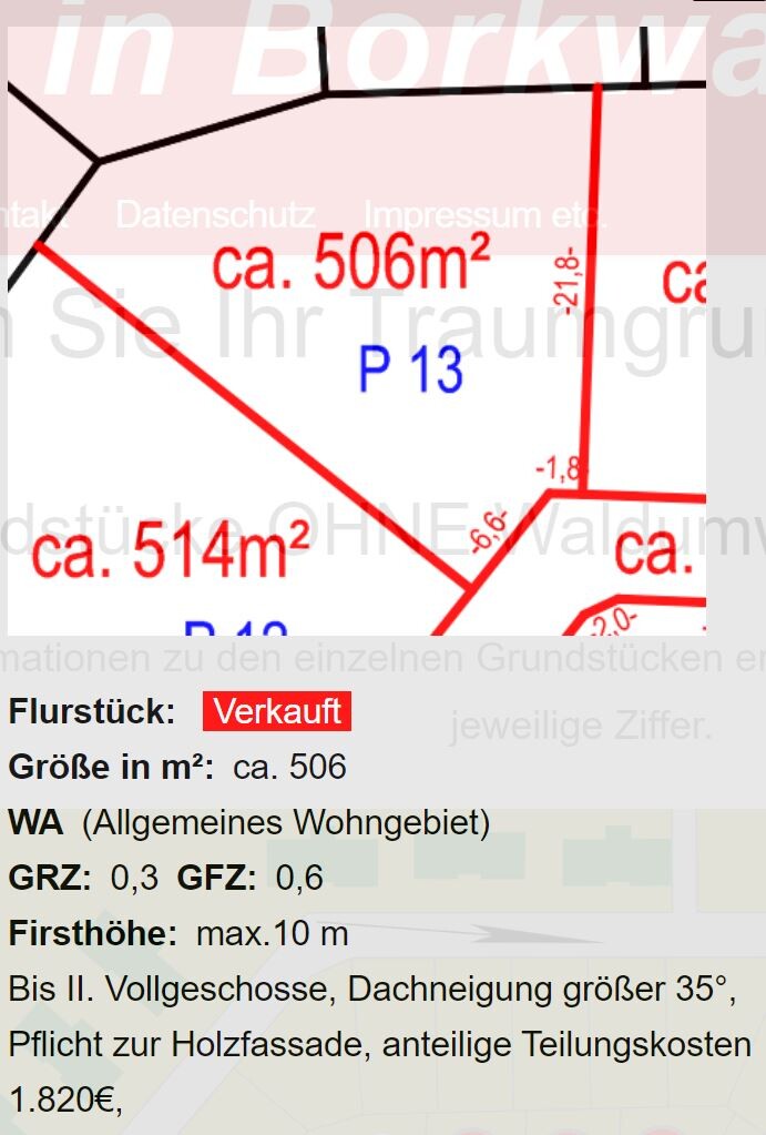

Development Plan/Restrictions
Plot size: 506 sqm (5445 sq ft)
Slope: no
Floor area ratio: 0.3
Plot ratio: 0.6
Building window, building line and boundary:

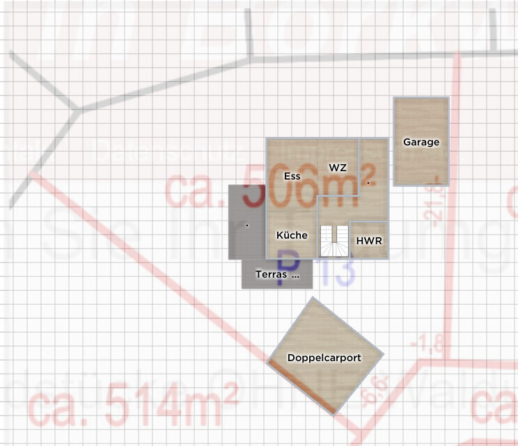

Benutzername7714 May 2021 13:40I have placed the house on the plot, so it fits.
If financially feasible, I would rotate it this way and add some additional windows, including in the stairwell area, to maximize natural sunlight inside the house. If that is not desired, orient it as you prefer. However, the direct location of the utility room for access simplifies things significantly. And yes: swapping the living room with the kitchen so the kitchen faces the terrace and the chill-out lounge area is sheltered.
That said, I did notice that windows are missing. Solid walls can quickly create a confined feeling.
With the example carport positioned as shown, the house and garden are protected from the curve and passing cars (headlights), yet south- and west-facing windows still bring plenty of light into the house.
Regarding the windows: hiring a different builder might pay off, especially if windows are not planned so sparingly in the building specifications. Our general contractor was not much more expensive than Town & Country, okay, a bit more, but we were able to include plenty of windows, which adds quality and value to the house.
However, I did notice that there are missing windows. Solid walls can make the space feel quite confined.
Regarding the windows: another builder might charge more if windows are not generously included in the building scope. Our general contractor wasn’t much more expensive than Town & Country, OK, a little bit, but we were able to choose from plenty of windows, which makes the house feel higher quality.I don’t think windows are that expensive if you plan for them early on. Of course, windows are always beneficial; you just have to see where it’s possible to add them. Space is limited, especially if you plan not only a sofa and table but maybe also a shelf or something similar—it gets tight quickly. I’m rather critical of the living (couch) area; if you want to add a fireplace there, it will get cramped (and probably hot), since the couch would be right next to the fireplace. Also, having a TV between the dining table and sofa is a matter of personal taste; it might bother me. I also notice that the distance from the TV to the couch is about 3.5 meters (11.5 feet), which isn’t ideal either.Similar topics
