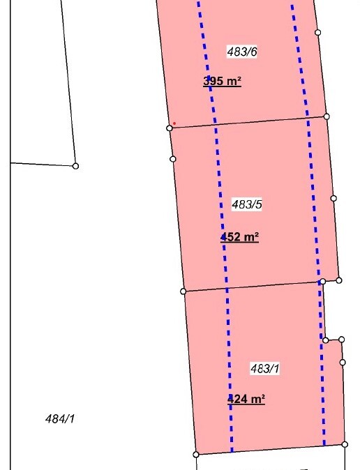

A site and location plan are necessary.

A site plan and location plan are necessary.We do not have a development plan. We are building according to § 34 of the Building Code.
