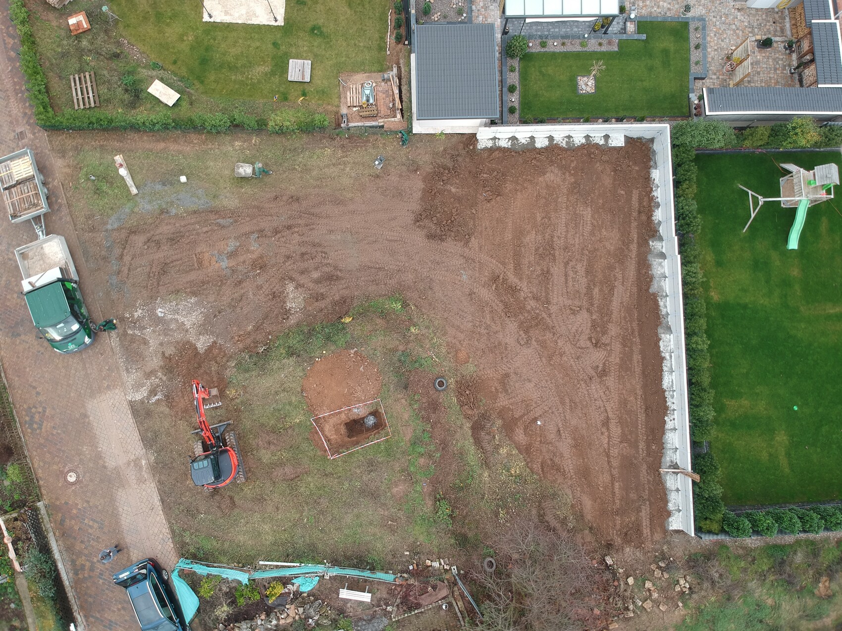

I recently joined this forum after we were awarded a plot of land in a new development area (in Rhineland-Palatinate, postal code area 55...). Since then, I have been following the discussions closely. At first, I didn’t want to share our floor plan for fear that I might not like it later. But now I’m curious to hear your thoughts. We still have the option to make minor adjustments. However, the building permit (planning permission) has already been granted. The kitchen is already planned as well. Both the kitchen and the furniture in the living-dining area are drawn to scale.
I hope the image resolution is sufficient to read everything clearly. Unfortunately, the plans are only available as scans. The north arrow on the plot is roughly drawn; it is correctly positioned on the plans. I’ve also attached a drone photo showing the current status (installed L-shaped concrete blocks at the rear side).

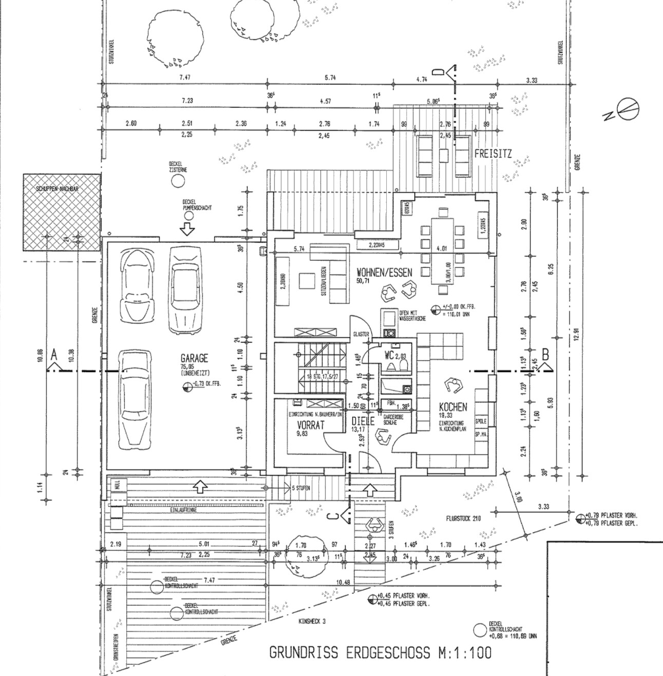

Matthew039 Jan 2019 11:09I think the design is very well done. The minor flaws have been mentioned and can hardly be resolved without creating other issues elsewhere...

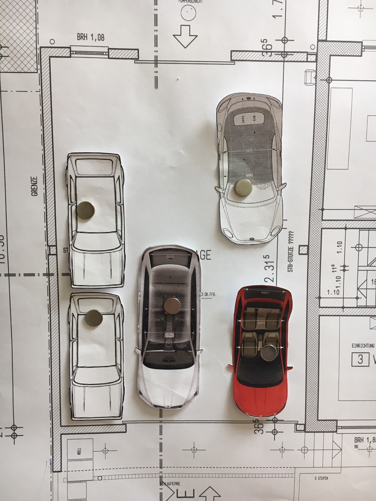

Garage interior width is 7.23 meters (24 feet)... am I correct in assuming that 3 of the 5 cars are only used rarely? Those would practically be parked side by side at the back? For everyday use, three cars would be too tight to maneuver comfortably (about 50 cm / 20 inches of door opening space), but it might work for occasional use. In the "front" area near the door, then 2 cars plus a trailer? How wide is the trailer? I believe every centimeter (inch) of width counts here.
The kitchen size would even be suitable for a small restaurant 😉
Thank you very much for your feedback. I’m very happy that the floor plan is well received and not being torn apart 😉

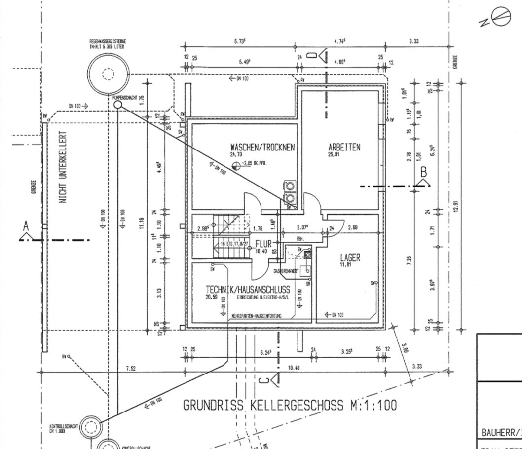

That large shaft is the service shaft for all kinds of installations on the floors. From there, the lines run out radially to the rooms. I forgot to mention this in the initial post.
That’s exactly how the garage layout is planned. At the front left, a small vintage car, next to it the two everyday cars, so you can easily drive out. In the back row, the two convertibles. In summer, one of the convertibles moves to the front, and an everyday car goes to the back. The trailer can also be parked outside behind the garage if it gets too tight inside (there’s another garage door at the rear).
kaho674 schrieb:The stairwell does have a window on the landing up to the upper floor. Unfortunately, it’s only shown on the plans for the ground floor. The windowless guest toilet is the compromise we accepted to keep the rest of the downstairs consistent.
Ok, a couple of minor issues like the guest toilet and the stairs without a window.

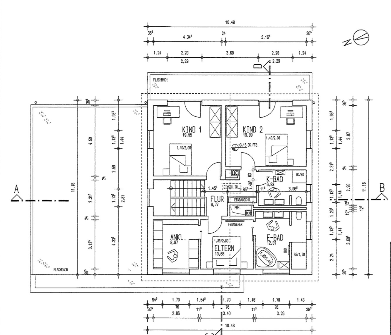

kaho674 schrieb:At one point, we had the bedroom on the left side of the plan and the walk-in closet in the middle. However, since the walk-in closet then had two doors, there was no wall space left for wardrobes.
Upstairs, I would try to swap the walk-in closet and the bedroom. That way, the window behind the bed could be avoided. The question is, does the underfloor heating require that much space? But I guess you’ve already thought about this, haven’t you?
kaho674 schrieb:Something like that 😉 One for every occasion 🙂
5 cars – do you really drive a different one every day and wash them all on weekends? 😀
Matthew03 schrieb:
I think it’s very well planned, the small flaws have been pointed out and can hardly be solved without creating other issues elsewhere...
Garage interior width 7.23m (23.7 ft)... am I right in guessing that 3 of the 5 cars are rarely used? They would be parked together at the back, practically side by side? For everyday use, three might be too tight to comfortably get in and out (about 50cm (20 inches) door opening space), but for occasional use it’s probably fine. At the front, towards the door, you’d have 2 cars plus a trailer? How wide is the trailer? Every centimeter of width counts here.
Kitchen size would be suitable for a small restaurant 😉
LaloBau schrieb:
This is exactly how it should look in the garage. A small classic car in the front left, next to it the two daily drivers, so you can drive out without any problems. In the back row, the two convertibles. In the summer, one of the convertibles moves to the front, and one of the daily drivers goes to the back. The trailer can also be parked outside behind the garage if it actually gets too tight (there is another garage door at the back).With the garage width and three cars side by side, walking through becomes very tight. Where are the bicycles stored? Do you have to go between the cars? I have more space between the cars and even then you have to be careful. A mountain bike already has a handlebar width of about 700mm (28 inches).
LaloBau schrieb:
I’m very glad that the floor plan is well received and not being torn apart I was just too tired last night :-)
But of course, I noticed that most of the measurements deviate from the standard module (which leads to shoddy workmanship). Load-bearing walls were not spared. The retractable staircase is drawn very narrow. I would not build a masonry chase for the service shaft between the bathrooms, but rather only install a partition wall between the bathrooms here. Airflow causes dust accumulation – I would reconsider combining occasionally used collector vehicles with regularly used vehicles, also regarding insurance: housing them in individually lockable, separated row garages is much more discreet.
hanse987 schrieb:
With the garage width and three cars parked side by side, it already gets very tight when walking through. Where are the bicycles stored? Do you have to go between the cars? I have more space between the cars, and even then, you have to be careful. A mountain bike handlebar is about 700mm (28 inches) wide.Um, I have to admit that we don't own any bicycles yet 🙂 That will probably change once our son is old enough for a bike. Over the weekend, we printed out the real car sizes and parked them. I think it should work. If something larger ever needs to get through from the back, one car just has to be moved. It was no different in the single garages at my parents' place. But thanks for the comment!
I wouldn’t build a solid wall where the utility shaft branch is between the bathrooms; instead, I’d just install a partition wall between the bathrooms. That is exactly what we have planned.At the moment, we are waiting for the construction drawings so we can commission the shell construction. Hopefully, things will start soon 🙂
What would be unacceptable for me in a house of this caliber is the kitchen. The distance between the rows is far too large, and the kitchen is too narrow for an island.
Since the kitchen needs to be wider and that will trigger major adjustments, it’s not a trivial matter.
Back wall cabinets 60cm (24 inches)
Distance between rows 120cm (47 inches)
Island depth 100–120cm (39–47 inches)
Distance to the wall on the right side 80–120cm (31–47 inches)
This means the room would need to be at least 360cm (142 inches) wide...
Alternatively, tall units could be placed at the bottom of the plan and then a large island positioned in the middle of the room. But as the kitchen currently is in the plan, it is absolutely terrible...
I don’t want to tear the plan apart, just improve it.
Regards
