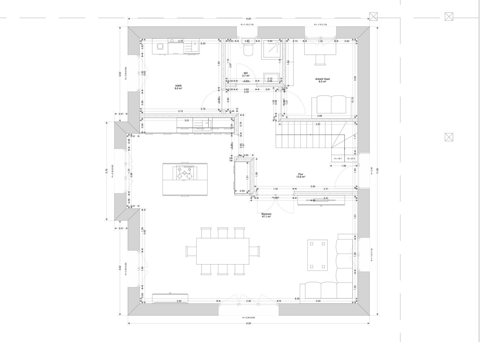

We are currently in the middle of planning our dream house and have now finished the initial drafts. We would greatly appreciate any suggestions, critiques, or improvement ideas. Our main priorities were a large, bright, and open living/dining area, a home office on the ground floor that can also accommodate a pull-out sofa bed, two showers—one being a walk-in shower upstairs alongside a bathtub—and two children's bedrooms of approximately equal size.
We are still uncertain about the following: a separate dressing room (advantages: my husband leaves for work earlier in the morning and can get dressed in a separate room, plus more sound insulation to the children’s room, which will later be a teenager’s room), a small pantry behind the kitchen and whether it should be open or have a narrow sliding door, and whether the staircase should be open or closed with space for a wardrobe underneath. We are also open to general advice on other aspects.

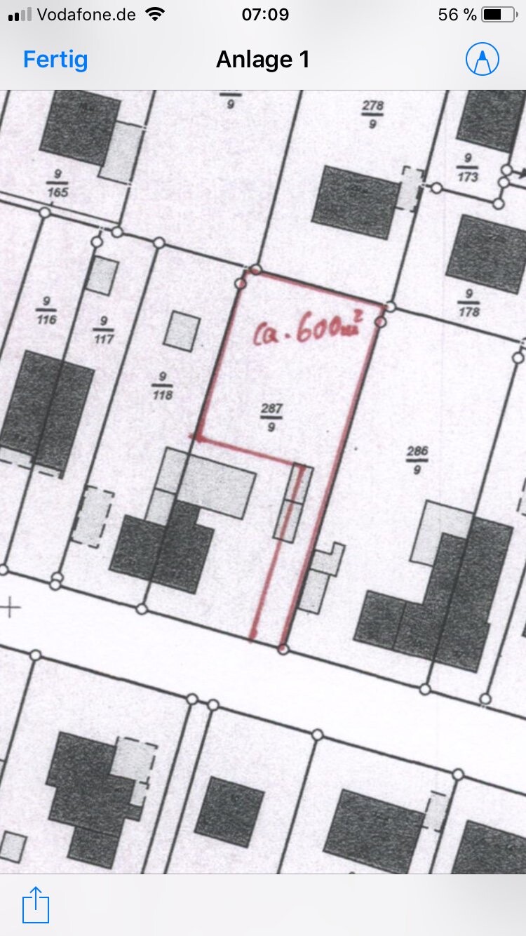

The house will have a gable roof with a 44° pitch and a slightly projecting captain’s gable. The knee wall (kniestock) will be about 1 meter (3 feet) high. Attached are the floor plans for the ground floor and upper floor, as well as the ground floor with the dimensions and outlines of the plot, terrace, and carport. Thank you very much!
Development plan/restrictions
Plot size: 600 m² (90 m² of which is driveway, due to rear development)
Slope: none
Site coverage ratio: 0.3
Floor area ratio: no specification
Building line and boundary: building line on the north side is 5 meters (16 feet) from the property boundary
Boundary setback: 3 meters (10 feet)
Number of floors: 1 full floor
Roof type: gable roof
Architectural style
Orientation
Maximum height/limits: 8.50 meters (28 feet)
Other specifications: none

And what kind of knee wall is this now? Roof pitch????
Now try placing a bed at a normal height and see if you can get up on the right side independently.
Edit:
With a knee wall of one meter (3.3 feet) and a roof pitch of 45°, you would have a height of two meters (6.6 feet) after one meter (3.3 feet). So standing up is possible. You would just need to duck a bit near the chest of drawers.
But overall, I don’t find having a window right above your head at all nice or acceptable...
What I mean is: all of this can be optimized if you take the time to do so!
Edit:
I took the 45cm (18 inches) wall thickness from a developer we originally planned to build with. Isn’t that a realistic wall thickness? The site plan will follow tomorrow. It is a flag lot, meaning rear development, and in the immediate Hamburg surrounding area it is currently the only option you can find that is affordable and not tied to a developer.
