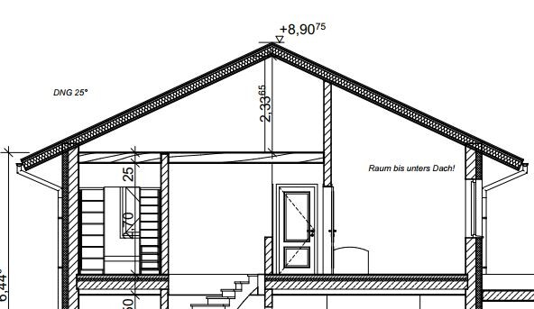

The roof has a pitch of 25°. The children's rooms are located on the ridge side facing south. The children's rooms measure 13, 13, and 16 m² (140, 140, and 172 sq ft). The ceiling height reaches approximately 1.5 m (5 feet) at the highest point.
Here is the cross-section:
Querschnitt eines Hauses: Dach, Treppe, Tür und Innenraumdarstellung
14 Jan 2021 10:05
I now see a kneewall, specifically in a two-story building.
You have to be careful that the space doesn’t feel uncomfortable if it becomes taller than it is wide – it can end up feeling like a tunnel.
There are several examples of this, some even shown here with photos. I didn’t like it, but the homeowner did. Unfortunately, I no longer remember who it was.
I also had this in my old house: the gable was divided into two children's rooms – it didn’t create a good sense of space. One large room benefited from that layout instead.
