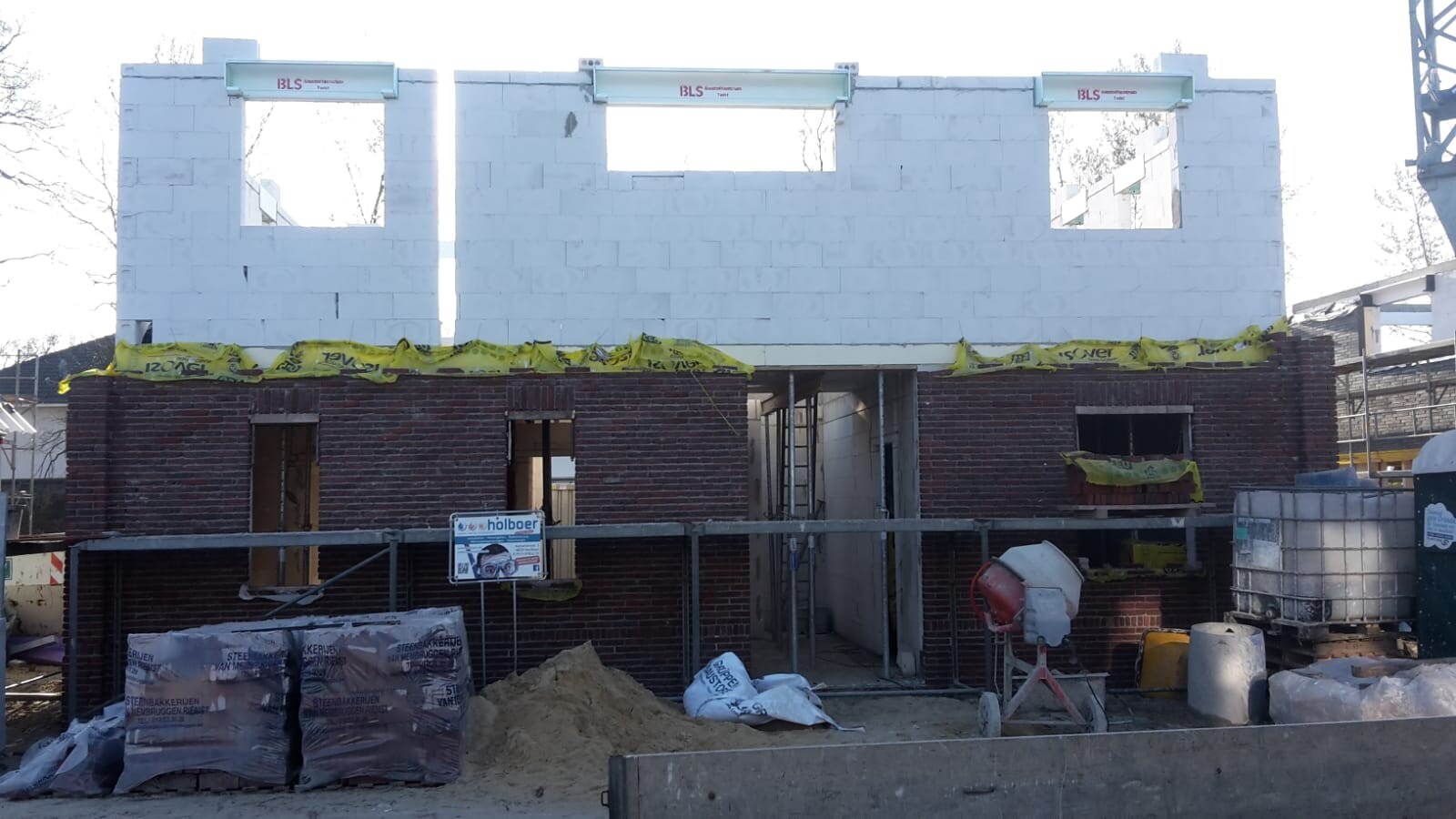

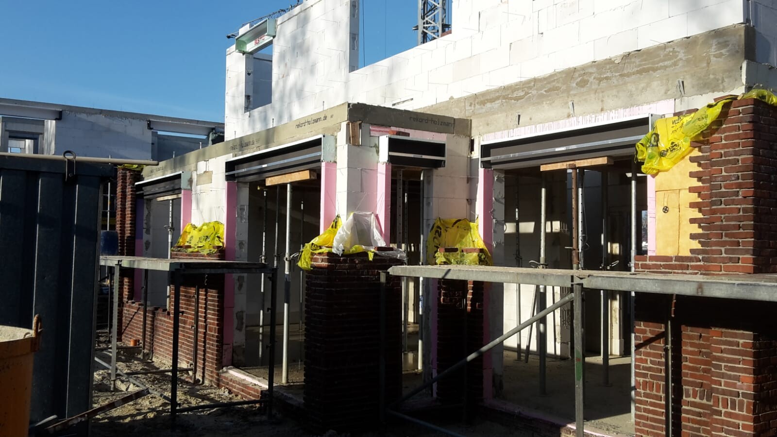

spochtsfreund23 Mar 2019 17:19spochtsfreund schrieb:
Unfortunately, I don’t have a photo of the door reveal yet. Did you misunderstand me? I wanted to see the situation from the middle picture in post #65 inside the door reveal, now while it’s still an open issue, not finished. So I’m talking about the profile view of the brick heads and the cornice including the air gap. Nothing will be wrapped around the corner anymore; the element will probably be integrated into the insulation layer.
spochtsfreund23 Mar 2019 20:09Hey, I probably misunderstood you. Construction terminology is still not my strong suit.
I meant: stand in the front door and take a photo at the height of the frieze (the band of twisted bricks) where the door frame would be if the front door were an interior door. From this "door frame," I wanted to see the facing bricks and the air gap between the structural exterior wall and the brick veneer "from the side." In other words, the wall in cross-section at that point.
spochtsfreund24 Mar 2019 00:39I will manage that soon.
