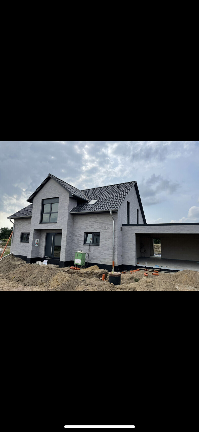

I’ve fallen in love with a beautiful brick… Unfortunately, it’s a ceramic facing brick (Röben Aarhus white-gray). This would not only cost me an extra charge for the brick itself but also significantly higher labor costs because of the more complex installation :-(
I’ve been searching through all kinds of brick manufacturers for several days now, but it seems this color is only available in “premium” options :p
My general contractor said that light (gray) bricks are currently in trend, so that’s my hope:
Does anyone here know of an alternative to this brick? 😎

TinaLa22 schrieb:
Unfortunately, it’s a ceramic facing brick (Röben Aarhus white-gray). This would not only mean an extra cost for the brick itself but also significantly higher labor costs due to the more complex installation :-( Just a simple question: if not ceramic, how exactly do you imagine a facing brick in a shade from the white spectrum? It could possibly be a sand-lime brick (although I’m not sure how you would get it in a grayish white or even in a popular range of shades). Traditional clay bricks are colored throughout the material and won’t be that white after firing, so you would need a slip coating (engobe). You can find several threads here where builders express their disappointment with the appearance of these, especially regarding chipped edges; but a construction site is not a girls’ boarding school, and the delivery drivers are rarely experts in handling delicate goods.
Just a basic question: if not ceramic, how do you imagine a cladding brick in a shade from the white spectrum? – it could still be a sand-lime brick (though I’m not sure how you would achieve a grayish white or even a popular color variation with that). Traditional clay bricks are colored throughout after firing and won’t be that white; you would have to use a slip coating for that, and there are several threads here where homeowners were disappointed with the appearance, especially with chipped edges. However, a construction site is not a finishing school for young ladies, and the delivery personnel are rarely experts in handling delicate materials.Thanks for your advice. Basically, I’m aware of that, but I didn’t want to give up hope that there might still be a (somewhat cheaper…) alternative, especially since there are some members here with more building experience… :p
TinaLa22 schrieb:
Basically, I am aware of that, but I still didn’t want to give up hope that there might be an (at least somewhat cheaper…) alternative.I’m just not so sure you fully realize that. What are you comparing the desired cladding to, and what exactly do you mean by the more complex installation—more complex than what?https://www.instagram.com/11antgmxde/
