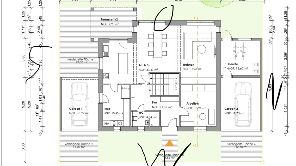

ᐅ Single-family house, 172 sqm: Questions about the floor plan, roof structure, and brick cladding
Created on: 28 Mar 2018 08:59
spochtsfreund
Plot size: 636 sqm (6,846 sq ft)
Number of floors: 2
Roof type: Gable roof
Architectural style: Industrial style
Orientation: Garden southeast
Maximum height: 9.5 m (31 ft)
Industrial style, no basement, preferably a partially open roof structure above the children’s rooms and staircase (still needs adjustment), staircase should not be visible from the front door, open and high rooms, efficient use of space, children’s rooms should not be too large (a matter of preference)
Number of occupants: 4–5
Home office mandatory
Open architecture
Open kitchen with island
- Architect
What do you particularly like?
The existing layout, storage space under the stairs, three possible children’s rooms, bay window in the living room, exposed steel beams in the kitchen and living room, textured clinker brick facade, overall style of the house
What do you not like?
So far, there is no natural light in the stairwell, which is why there is a desire for a partially open roof structure
Preferred heating system:
Geothermal
The architect has fully followed our specifications and wishes
What is the most important/fundamental question about the floor plan?
Would a partially open roof structure be possible? Do you have any experience with this? Do you have alternatives to Wittmunder torfbruch clinker? If yes, where did you get yours?
Number of floors: 2
Open architecture
- Architect
Geothermal

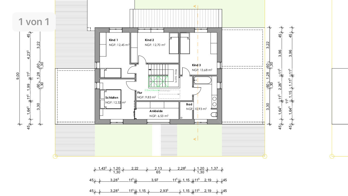

You’re probably right about the hallway, but with our layout, you can almost walk downstairs to the guest bathroom nearly unclothed without being seen from the front door. Well, I regularly walk through my entire house unclothed. Should I be concerned?
spochtsfreund schrieb:
Regarding building on the property boundary, personally, I just don’t like unused space on the sides. Also, in my opinion, it makes the house look less bulky, but of course, tastes really differ. That’s a pity. I actually find the unused space important. It would be a good opportunity to frame the area with climbing roses or shrubs.
Yes, such a gable is really impressive! But I wouldn’t exactly consider it a cheap option...
Velux offers daylight spots – maybe a more affordable alternative?! (without knowing the cost of something like that...)
Brick cladding isn’t really my favorite either, but I really like the house!
Anything that’s not an urban villa is always VERY much to my liking!

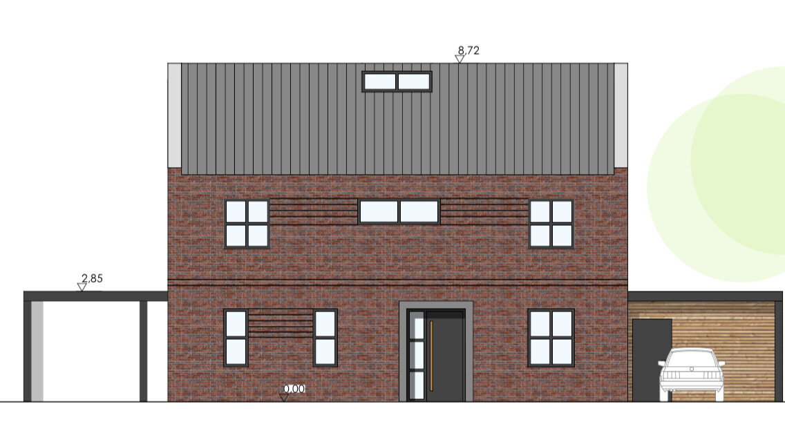

spochtsfreund29 Mar 2018 10:42The Velux windows or roof lanterns are also an option, but my wife is currently set on making the space more open. Of course, this is mostly a matter of budget. Once we have the numbers on the table, we will make a decision.
Thank you for helping to convince even those of us who are against brick facades to appreciate brick a little more.

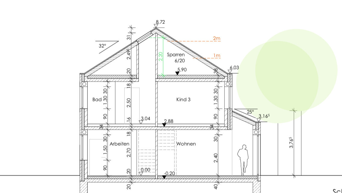

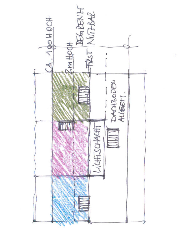

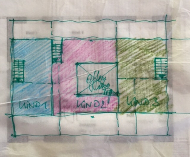

spochtsfreund7 Apr 2018 22:25Hello everyone,
Thanks to some of your tips, this is now our final design. The sketch shows an option for the attic, so we get both storage space and an area for the children. A light well is also planned; of course, the windows can only be cleaned with a tall ladder, but that should be manageable. For the brick facade, we have chosen Deppe DF 1622ek.
Our architect estimated the whole project at KFW55 standard to cost around 340,000€ (about 340,000 USD). I’m curious to see what the final price will be.
So, thanks again, and I will surely ask some more questions here or report back if there is interest.
Henning
Henning
