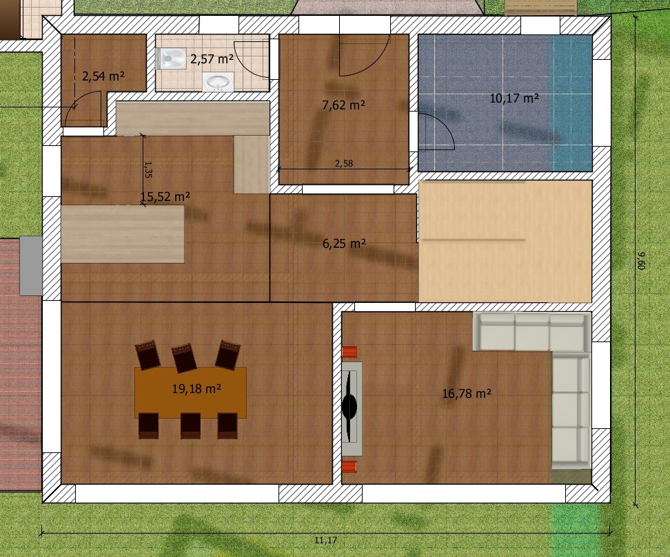

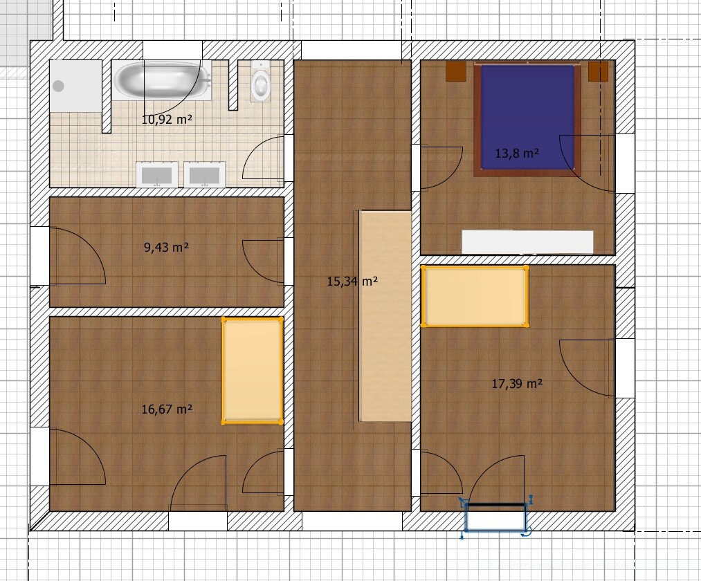

I have been "creative" over the past few weeks and tried to put a floor plan on paper. At the moment, it’s not really a copy of a fully designed house but more freestyle planned based on intuition. This worries me a bit because I’m not sure if it could actually work as is. Before I get in touch with the main contractors, I’d like to have at least a somewhat suitable basic floor plan.
I have drawn many versions with different stair configurations and house orientations. Currently, the attached floor plan is my favorite, featuring a straight staircase and an east-west orientation. I know the space probably isn’t used with maximum efficiency; what’s most important to me is a generous sense of space. But I’m also not entirely sure if perhaps some space is simply wasted by being too generous. Well, I’m curious to hear your opinion.

You don't gain much space... What needs to fit in there? Heating system? Depending on the system, some kind of storage tanks? Distribution box? Washing machine? Dryer? Small hand basin? Any other systems like solar or similar? Are you possibly planning to iron in there as well?

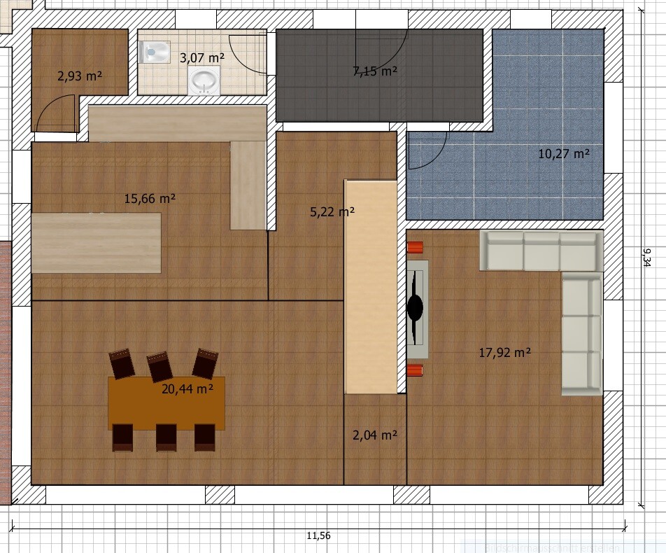

Has arrived. I’ve optimized the floor plan with the landing staircase again to about 10 sqm (108 sq ft), but in detail, it could probably be adjusted a bit more.
I’m really a fan of landing staircases. However, in my floor plans, they always seem a bit out of place, especially when combined with at least a somewhat separate living room. Or is that just my impression?
I wouldn’t like the living room boxed in like a master office in the corner of a workshop.
