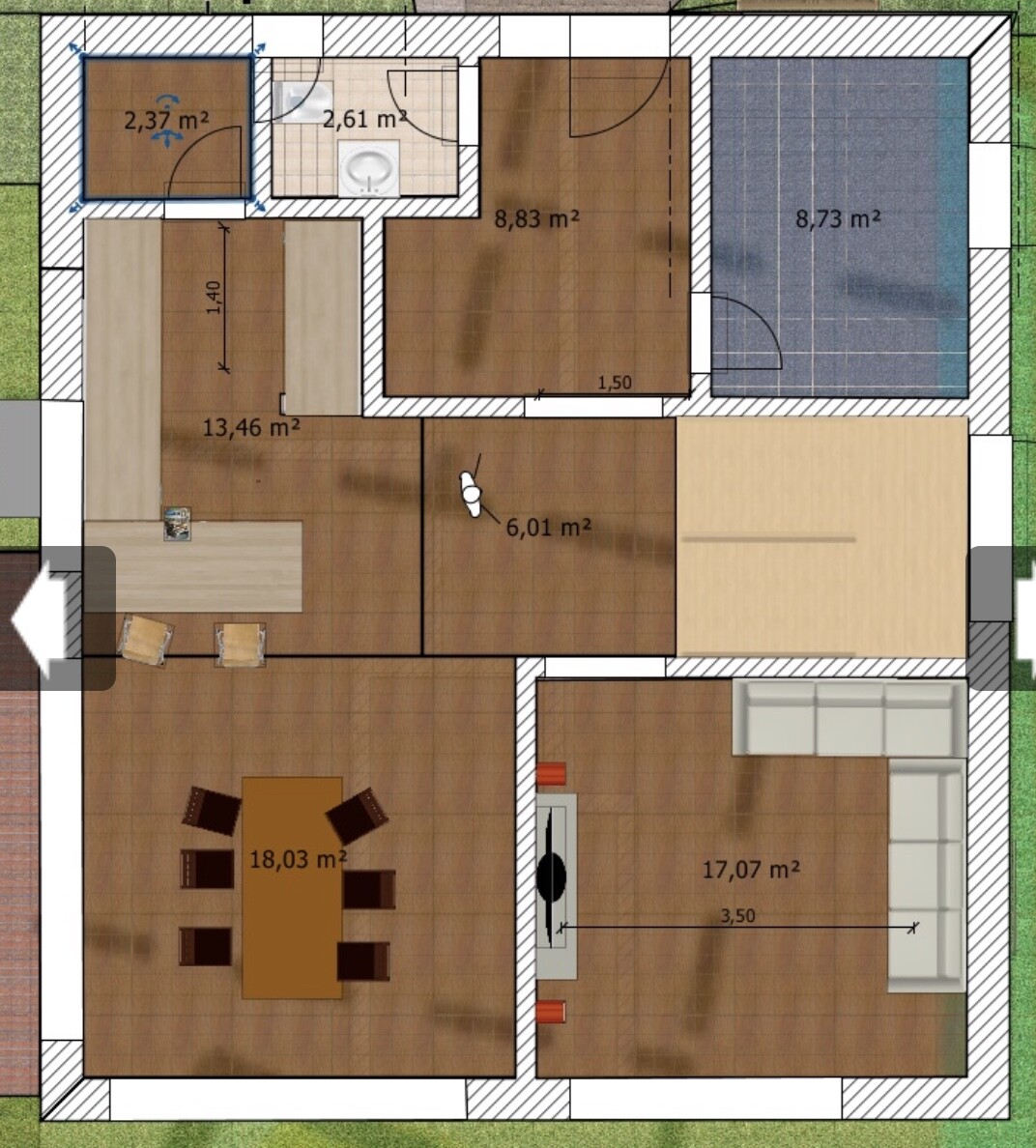

I have been "creative" over the past few weeks and tried to put a floor plan on paper. At the moment, it’s not really a copy of a fully designed house but more freestyle planned based on intuition. This worries me a bit because I’m not sure if it could actually work as is. Before I get in touch with the main contractors, I’d like to have at least a somewhat suitable basic floor plan.
I have drawn many versions with different stair configurations and house orientations. Currently, the attached floor plan is my favorite, featuring a straight staircase and an east-west orientation. I know the space probably isn’t used with maximum efficiency; what’s most important to me is a generous sense of space. But I’m also not entirely sure if perhaps some space is simply wasted by being too generous. Well, I’m curious to hear your opinion.

I’m interested in general feedback on the floor plan since it was designed by me as a layperson, not an architect. The result will serve as input and discussion basis for a main contractor. Before that, I’d like to hear your opinion.

I quite like this design for further development, but I would expect the necessary 1.40 m (4 ft 7 in) in the kitchen to be more in width.
Why I reject the others (except for one):
The entrances from the hallway look crooked. There is an imbalance in the hallway area everywhere. It is often problematic when the entrance to the open-plan living space is on the side, or when the hallway only offers “room” on one side of the door.
If there is no other option, then that’s how it is.
But you have all possibilities.

kaho674 schrieb:
Same problem with the stair landing. Where do you see the direction of travel indicated?
Where is the running direction indicated? A guess.
So the planned direction of travel would be from north to south. I originally had the idea to do it the other way around, which I think would look very nice in the dining room. But in reality, it’s probably quite impractical if the staircase is located in the south between the living room and dining area.

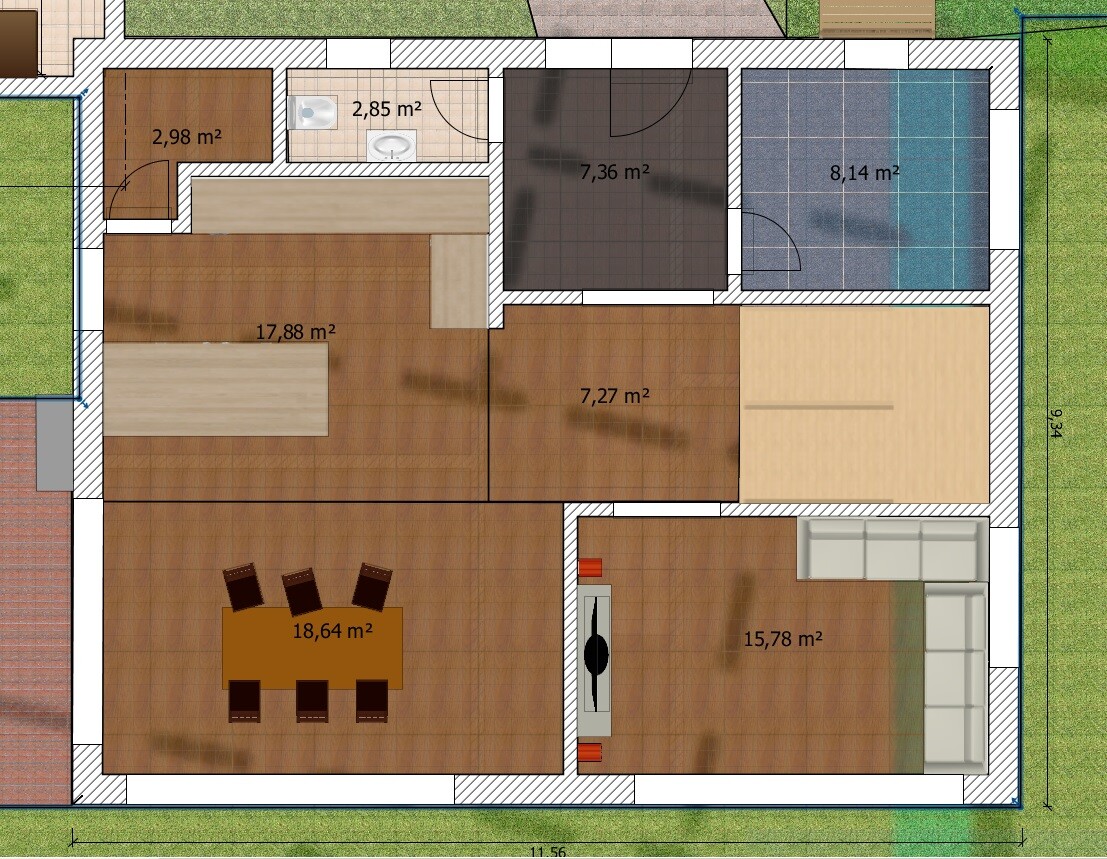

I’ve now quickly tried to shift the landing stairs to the slightly preferred east-west orientation. It doesn’t look completely wrong to me, but I still need to plan in a wardrobe.
