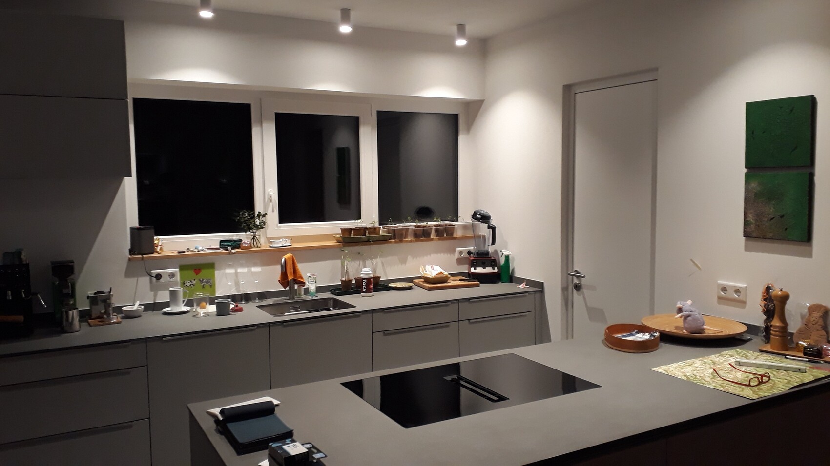

Above the peninsula, there are two 24V LED spotlights installed in the ceiling, with overlapping light beams. They are controlled by a motion sensor.
On the opposite side, there are wall cabinets with a 45-degree profile beneath them, equipped with an LED strip to illuminate the sink and access point, also controlled by the motion sensor.
I would choose the light color to match the rest of the room. Although, according to textbooks, warm white is not ideal for work areas, I believe it’s acceptable here to maintain a consistent color throughout the room.
In my opinion, tunable white and RGB lighting are just gimmicks. They might be fun at first, but you rarely use those features in daily life.
