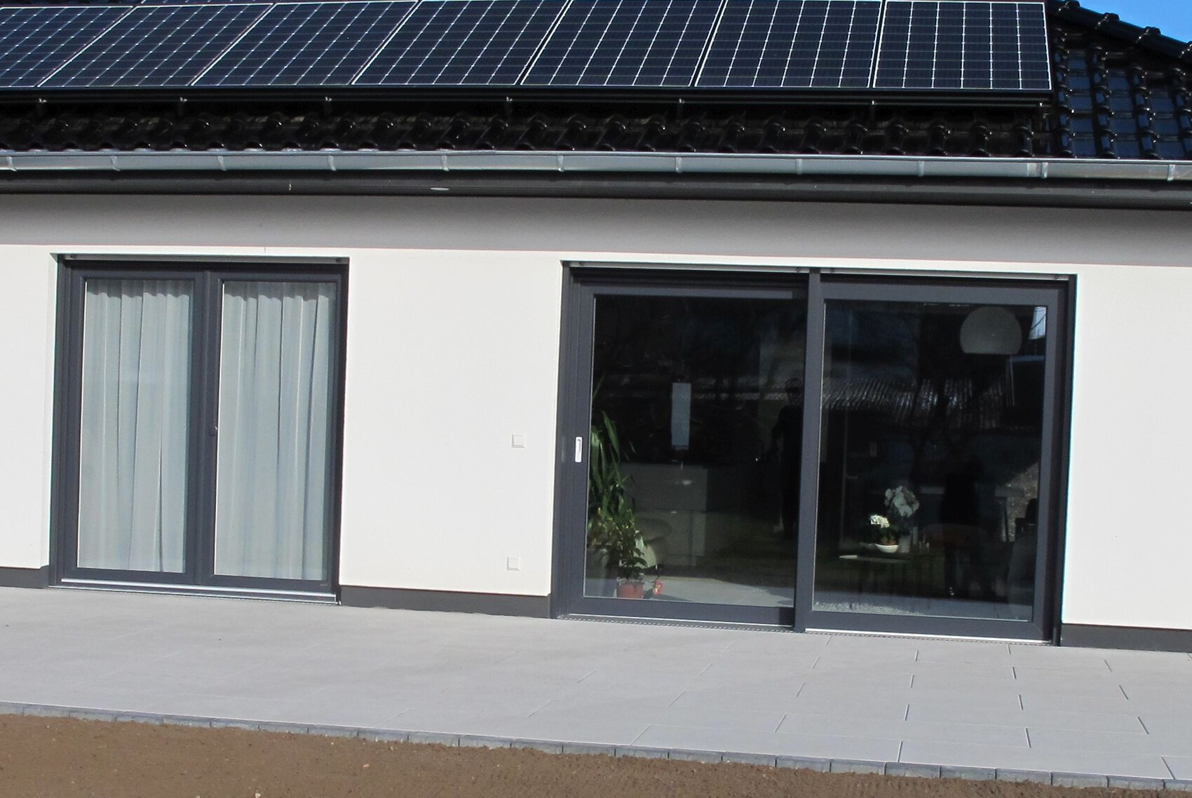

D von Tramm2 Apr 2024 14:37Unfortunately, the picture from Mahri only shows the final result.
I would also be interested in the best approach to take. Our situation is similar, but our insulation has been completely sealed with bitumen. Of course, we cut out the opening for the basement pipes in the Styrodur and resealed it with two layers of bitumen.
The question is, when embedding the drainage channel in concrete, should a dimpled membrane be installed between the drainage channel and the window, as shown in the picture?
Is it better to place it only below the insulation and have it run up in front of the channel?
Or should the dimpled membrane be omitted at this point?
I have a dimpled membrane with fleece and a sliding foil and would like to know how to position it best there, if it is necessary at all.
