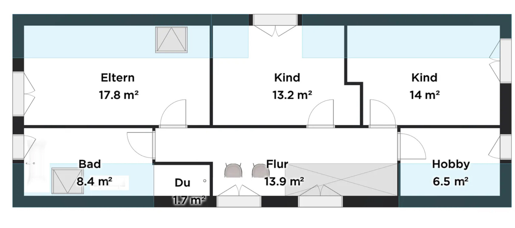

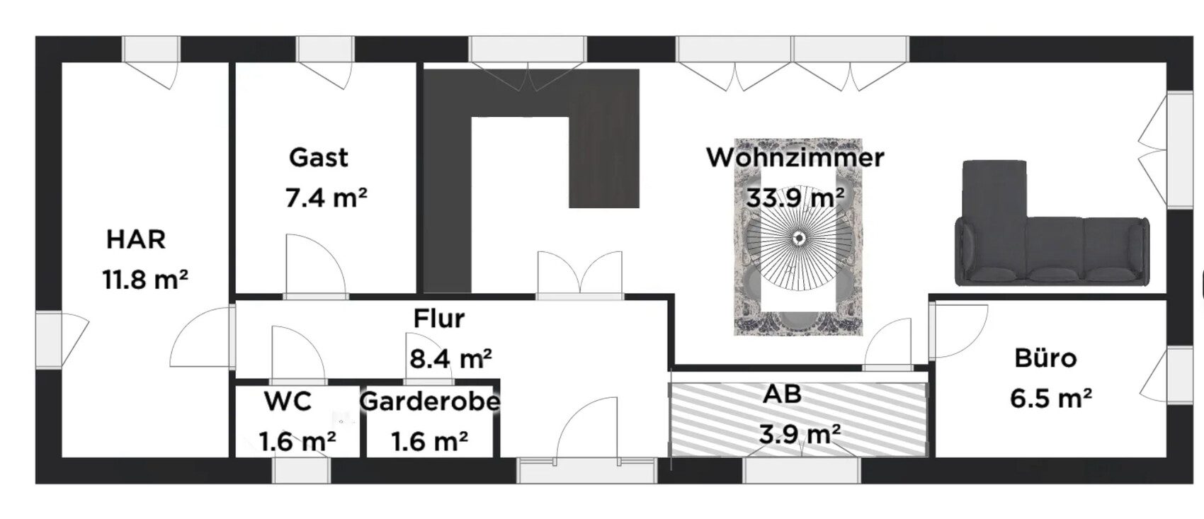

We don’t even have a house yet. I just wanted to see a random example,
Random, 6 x 15.5 meters (20 x 51 feet):
2D floor plan of a living area with living room, guest room, corridor, office, and storage room
Floor plan of a family house with parents’ bedroom, two kids’ rooms, bathroom, shower, corridor, hobby room
