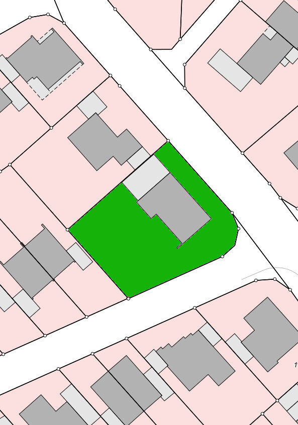

- ~170 m² (1,830 sq ft) living area + basement, nearly 1000 m² (10,764 sq ft) plot size (house location in the attachment)

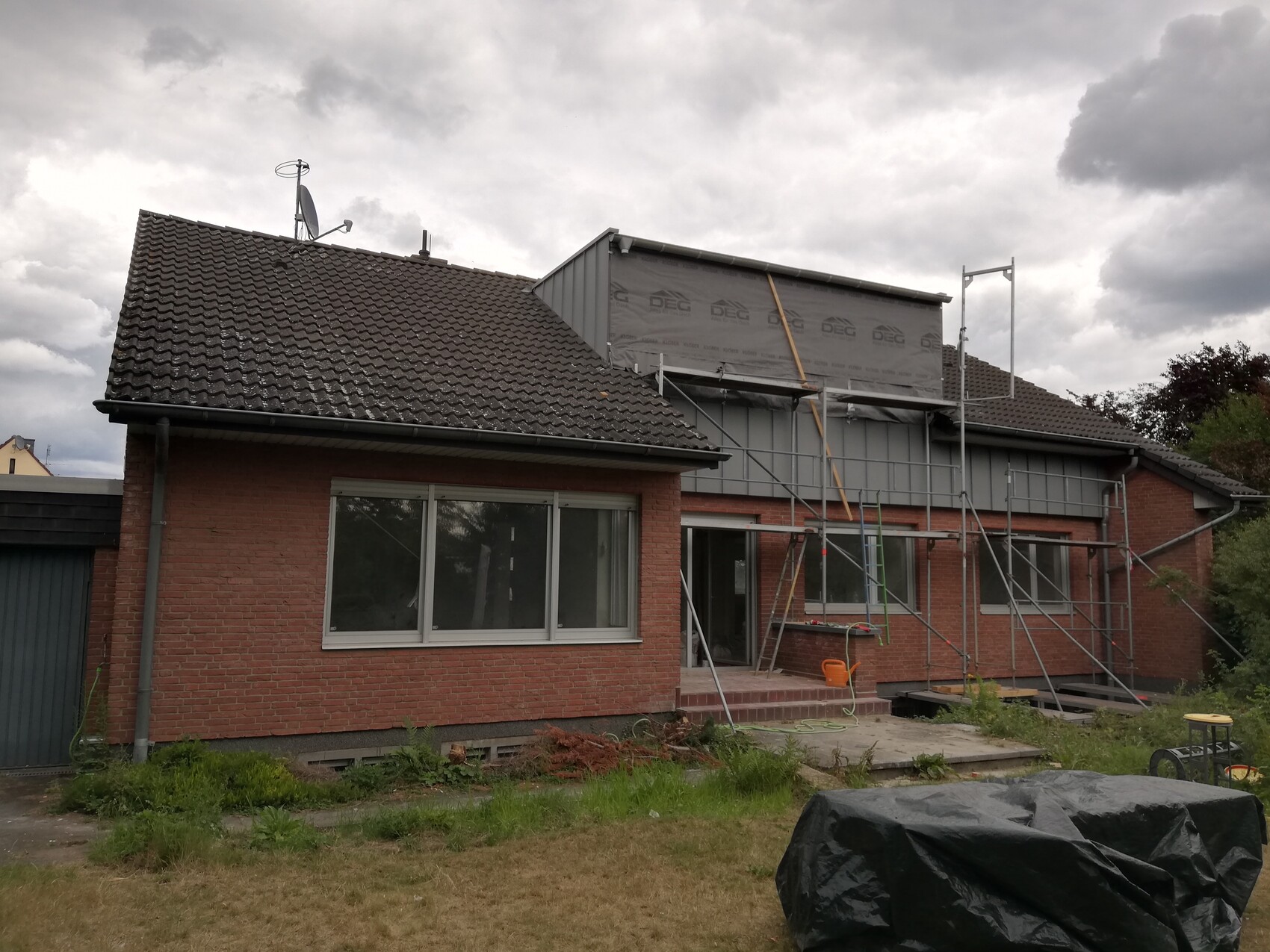

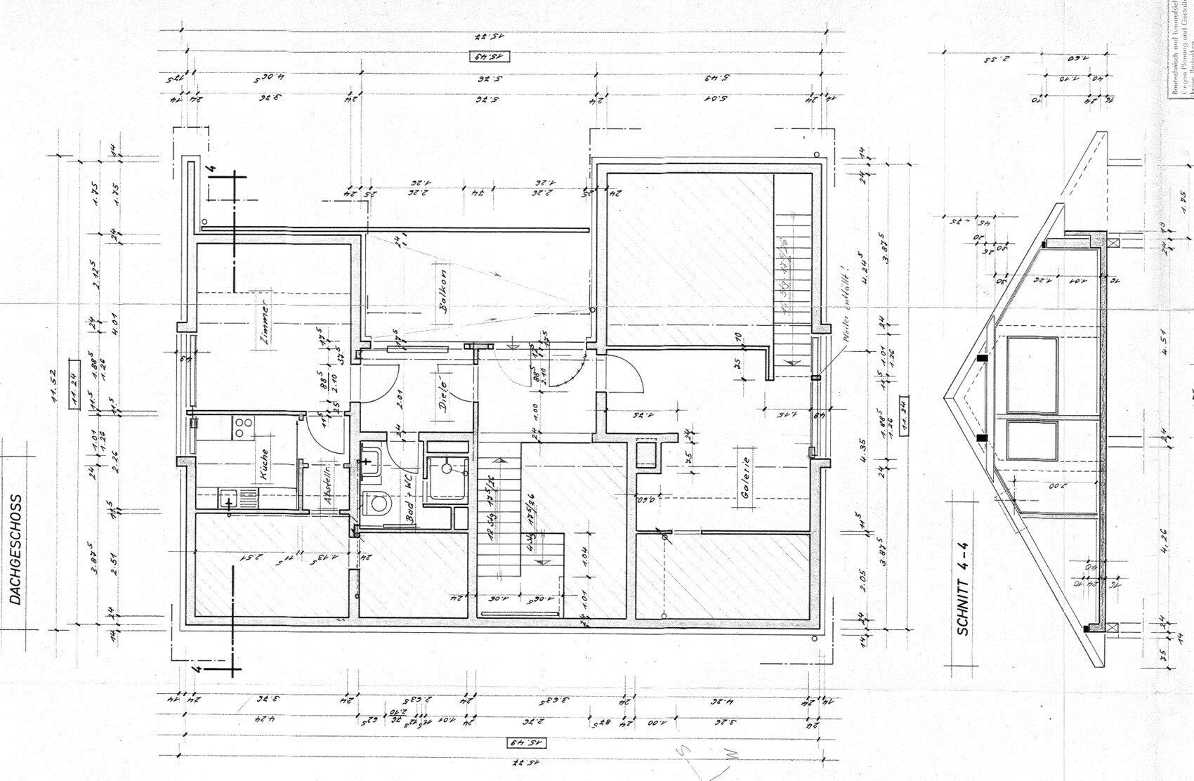

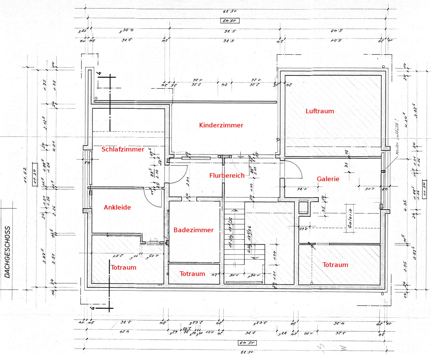

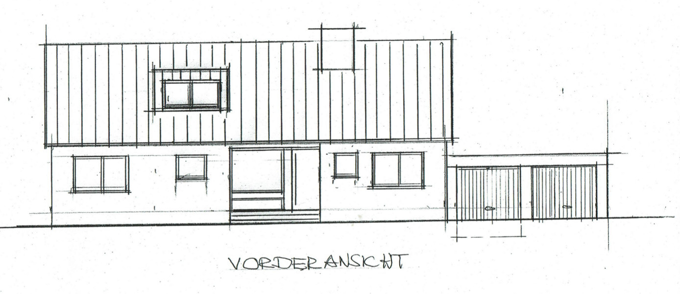

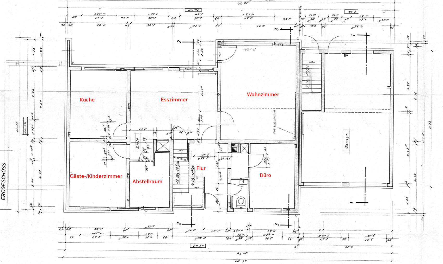

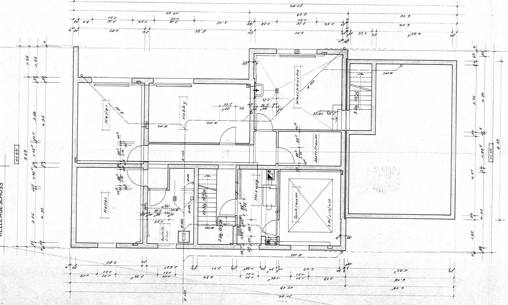

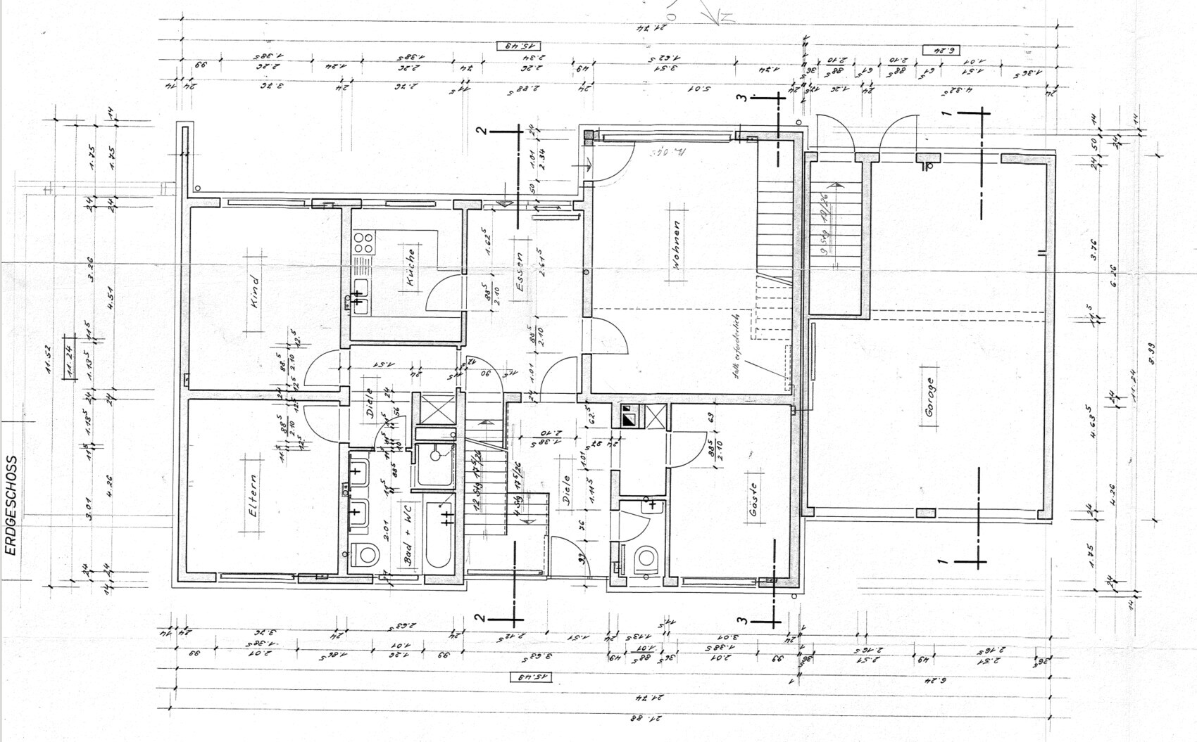

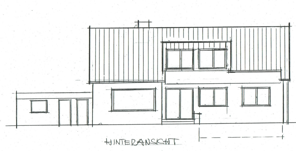

I have tidied up the old floor plans a bit and added the planned rooms. The previous modifications are also integrated. Two non-load-bearing walls were removed, and the two dormers are already installed (one to enlarge the bathroom and one over the old balcony, which we no longer need).

What we don't like about the floor plan:
- The attic floor is not as spacious as the floor plan suggests because of the two open rooms. As a result, the bathroom and children’s room are not very large
- The kitchen has no direct garden access (there is a slope there for the basement rooms) and is far from the entrance
- The walk-in closet can only be accessed through the bedroom

Add some photos and the unfilled floor plans.

I had at least expected some input on the great scaffolding....

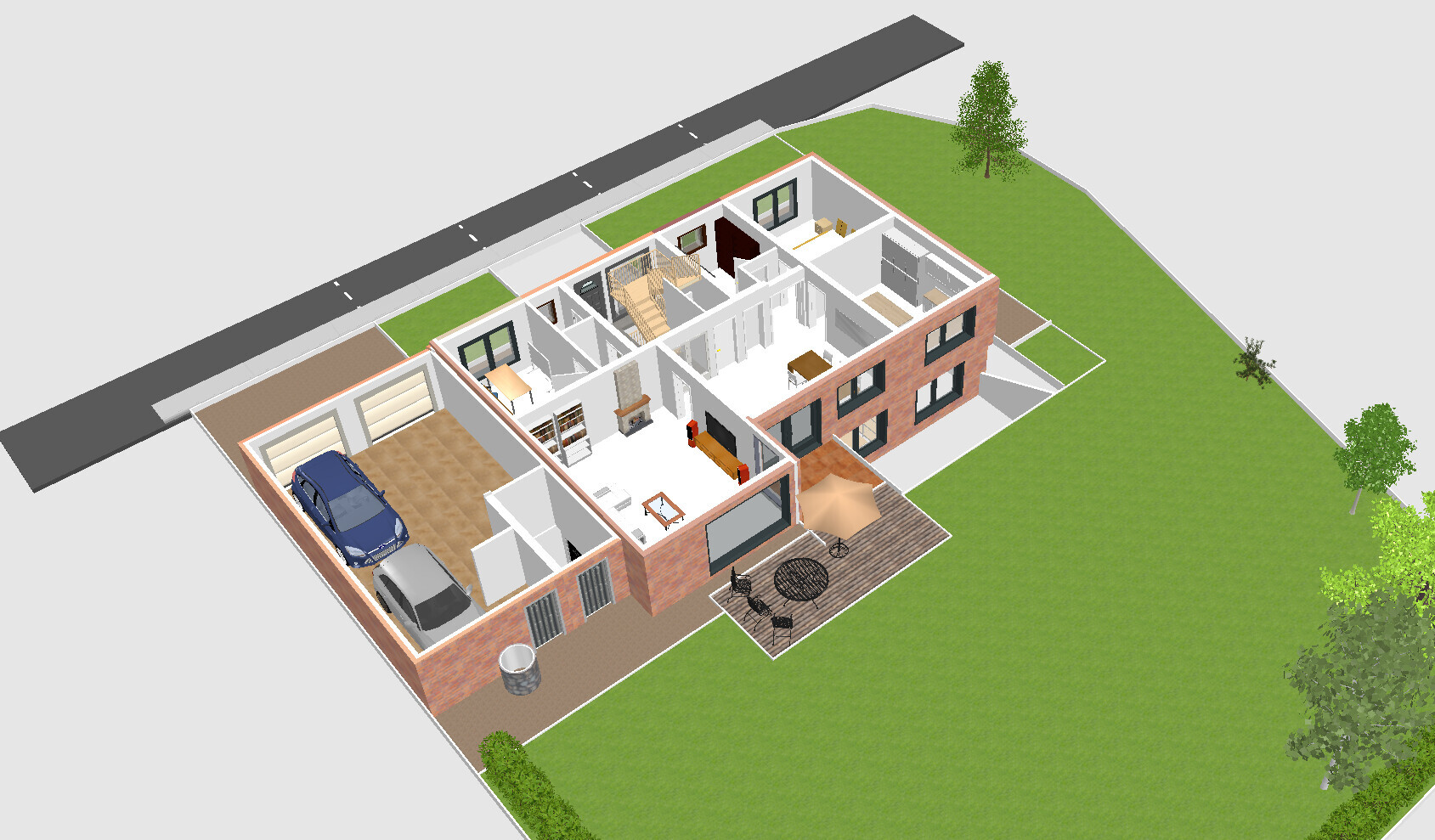

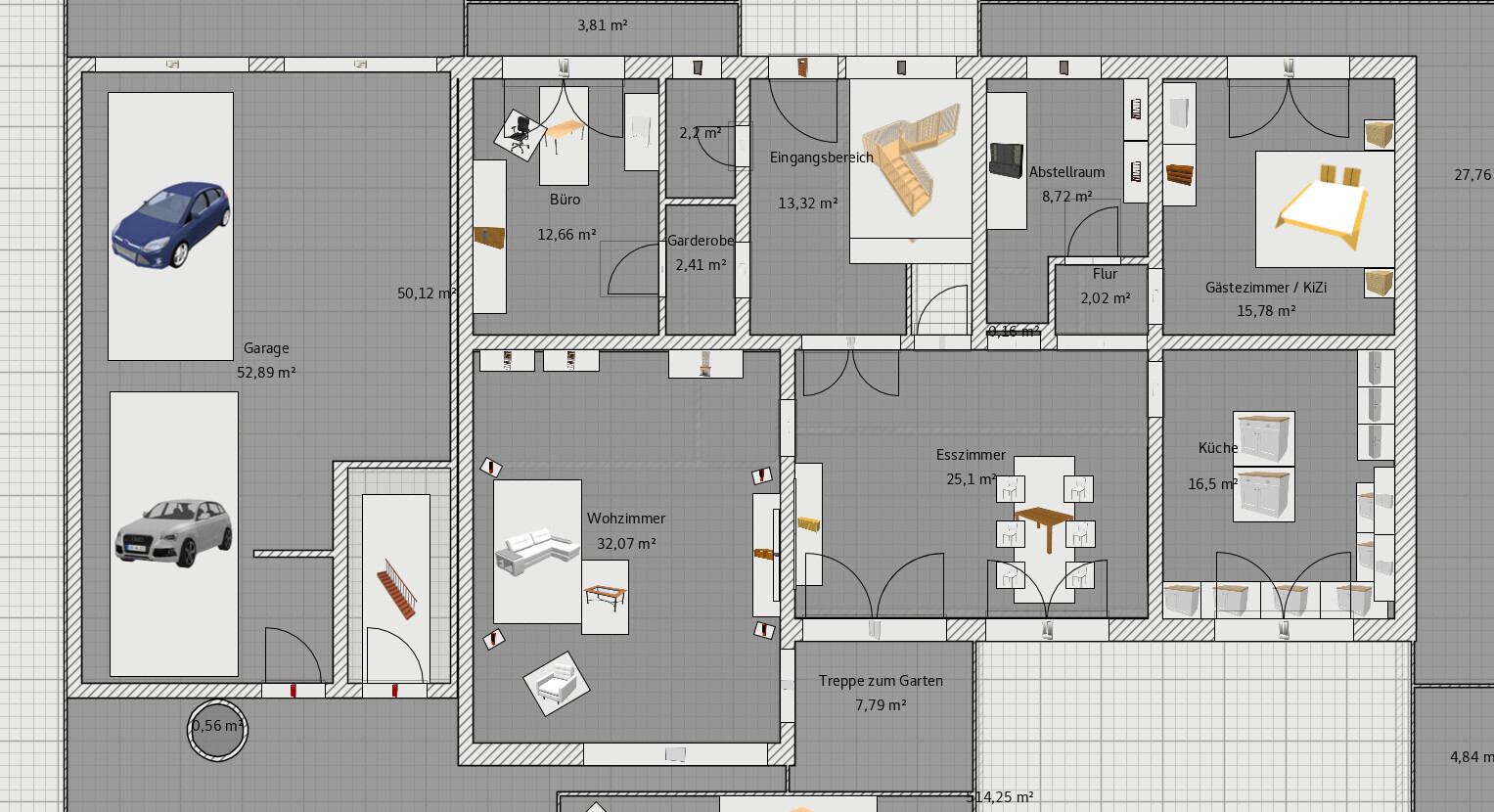

The problem might be the lack of a dimensioned floor plan including the planned furniture.
I tried to create one in SH3D, but the software is a bit limited here and there (or maybe I’m not using it well enough...).
I’m posting it anyway, maybe it will prompt more comments.
