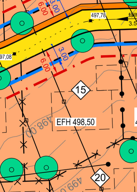

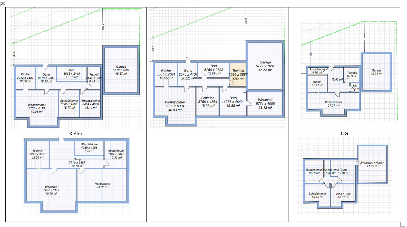

In the meantime, the planning has progressed somewhat. Overall, three possible options have emerged to integrate the workshop as a heated space. The key question here is which option would be the most sensible for a sloped lot with a 2m (6.5 ft) incline. The floor plans / 3D views are still in draft form and not fully finalized.
Option 1: Bungalow with basement
+ Basement advantageous on sloped lot
- High investment for usable space
- Two floors
Option 2: Bungalow, all on slab
+ Everything on one level
+ Probably the cheapest option
- Usable space is generally limited
- Slab foundation complicated by slope
- Smallest garden area
Option 3: Single-family house on slab. Workshop above garage
+ House can be placed closer to the building boundary
+ More of a “standard” design for better resale value
+ Maximum garden area
+ Better views on upper floor
+ Direct access from office to workshop
- Passage from upper floor to workshop may be difficult to realize
Which option would be the best, especially considering the plot? Is option 3, with a passage from house to pitched roof garage, easily feasible?
Many thanks

What about the other space requirements? Are you single, do you have a partner, or is this about space for a family of four? I would base my decision on that. Personally, I wouldn’t build a family house if I’m single and only have office and hobby space in mind. I would reject option 2 due to the complicated construction (and the awkward, elongated floor plan).
The space requirements are planned for two adults with a (future) child. The floor plan / rooms are not yet fully finalized. The main question for me is whether, considering the plot of land, a bungalow with a basement or a regular 1.5-story single-family house is the better choice. I tend to lean away from option 3, as it focuses more on living space rather than usable space. A workshop in the basement and a sloped plot of land, on the other hand, speak more in favor of option 1.
