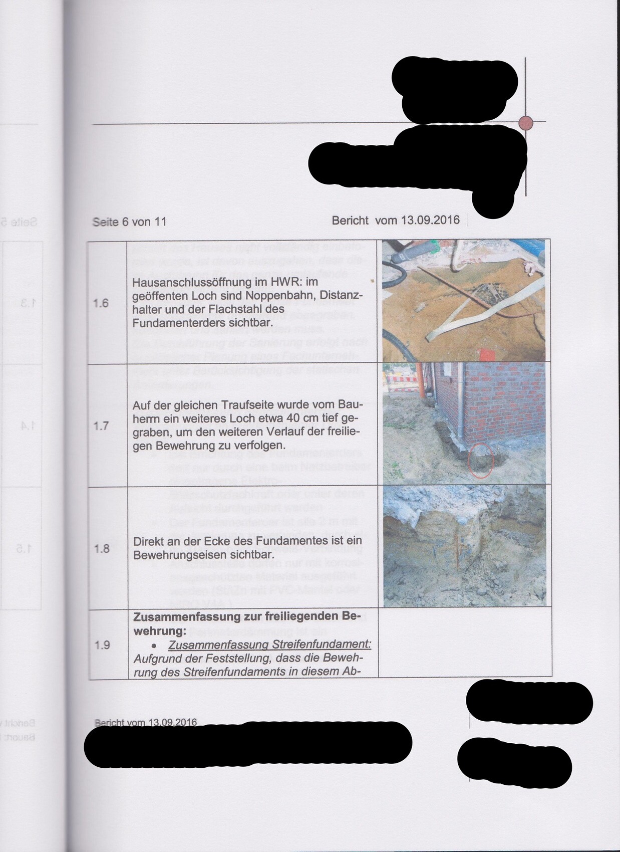

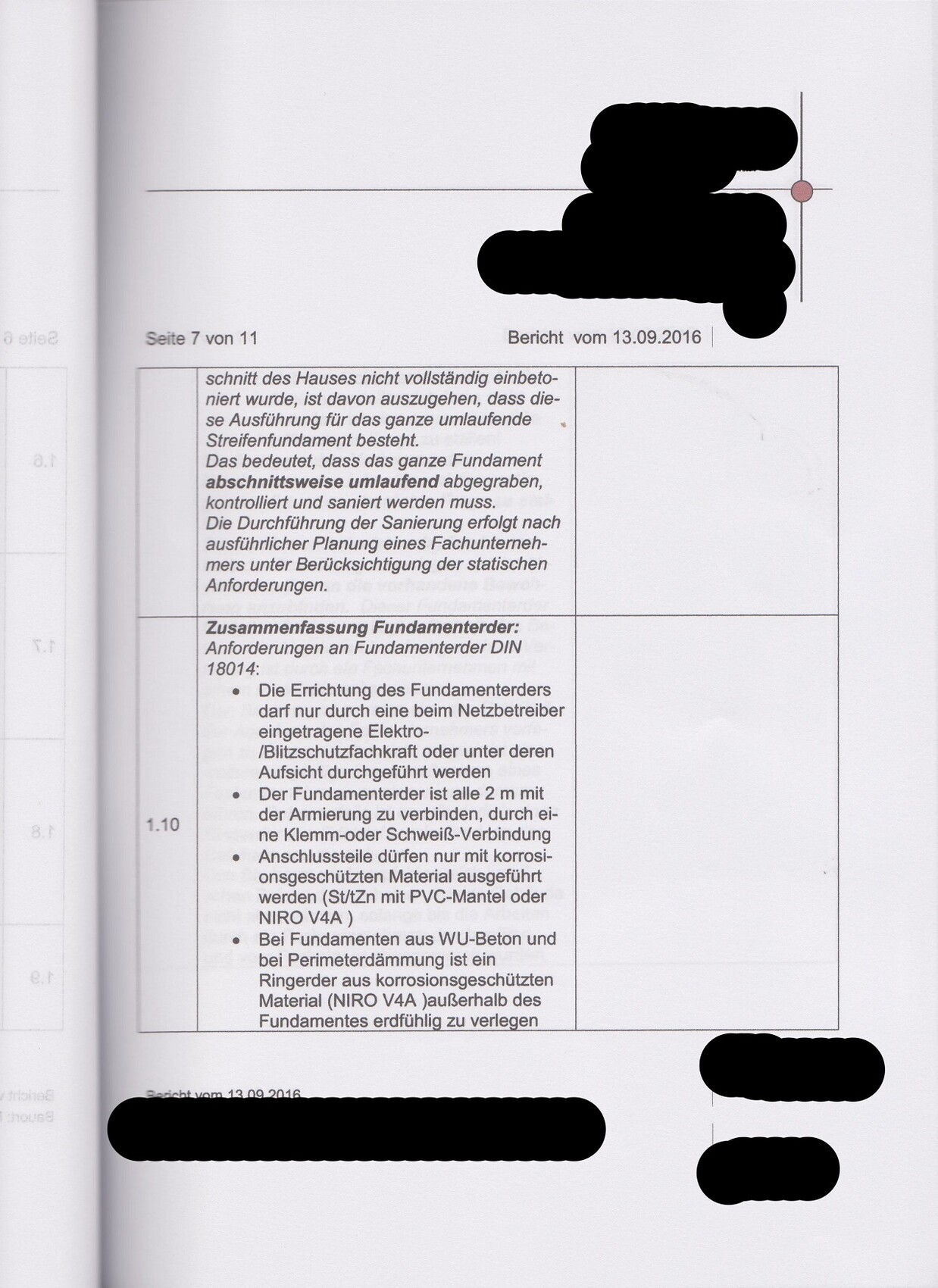

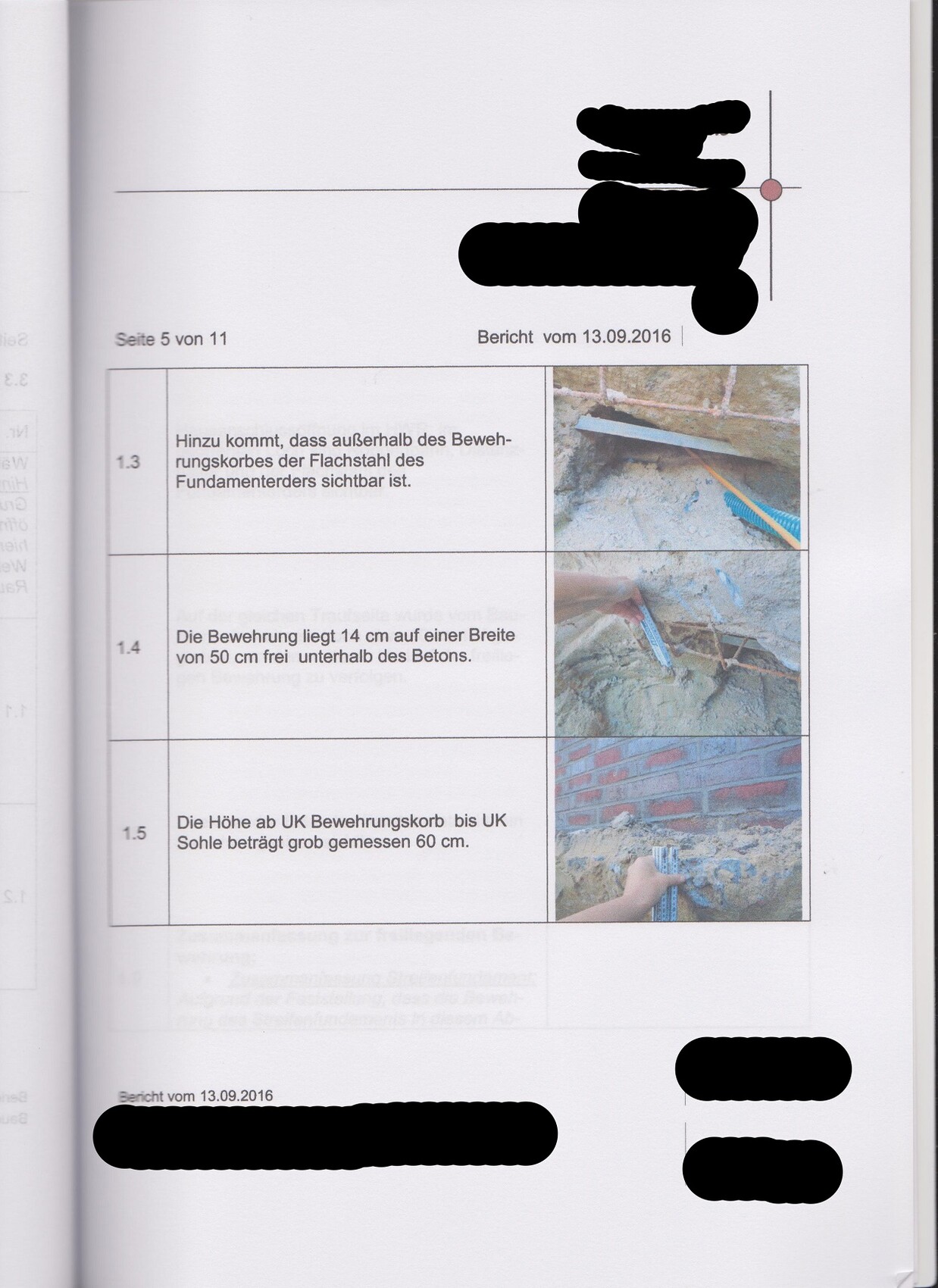

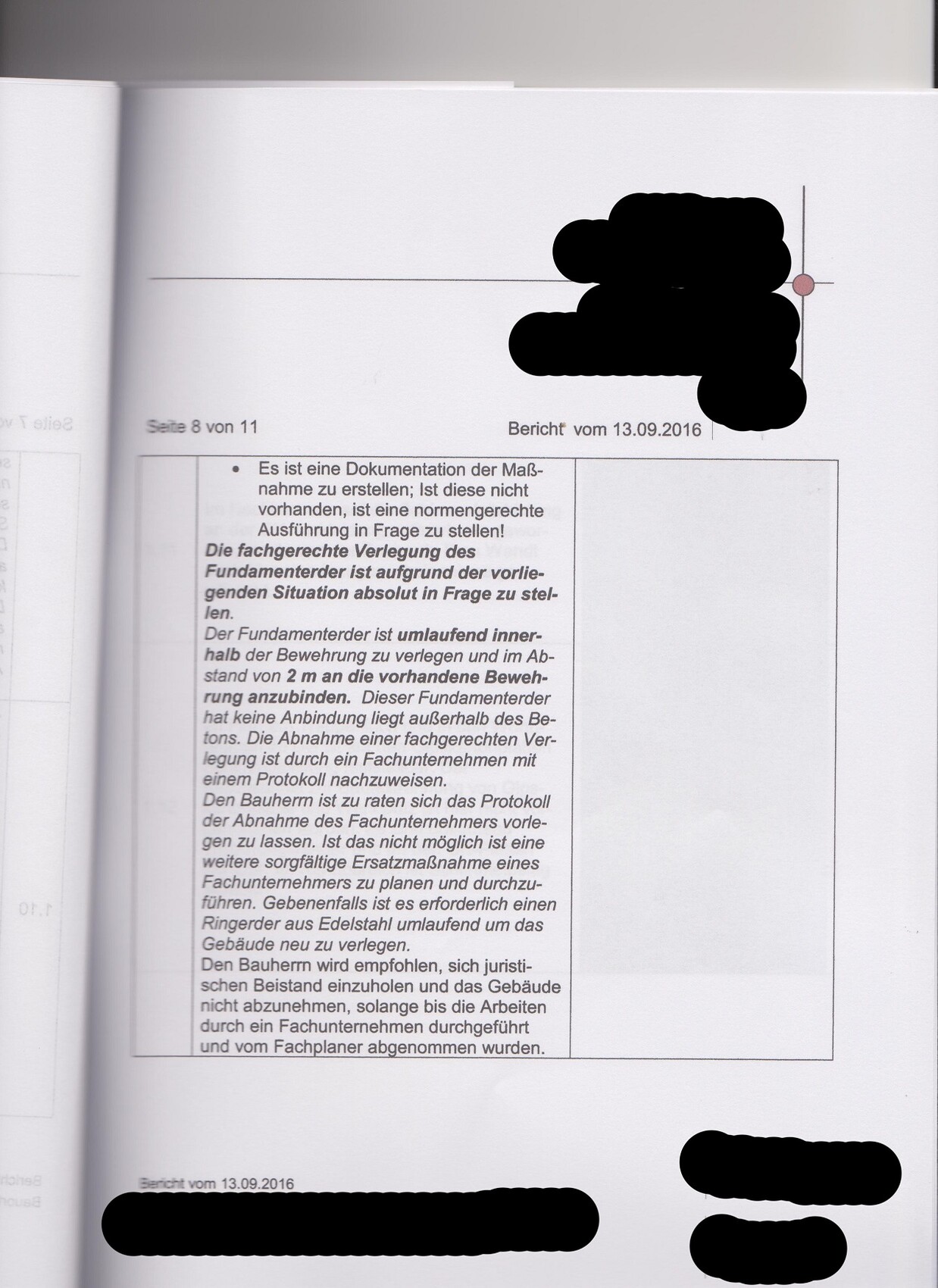

Hello forum members,
Unfortunately, due to time constraints, I have not been able to continue my post here until now. I have had the report at home for about two weeks.
Since new defects kept being discovered, I simply didn’t have the mindset to continue my post here.
Just yesterday, the airtightness test failed. The reason for this is a defective pipe embedded in the foundation.
At the same time, the painting company I hired found that the drywall panels on the sloped ceilings were partially not attached to battens, resulting in about 2-3mm (0.08-0.12 inches) movement. This causes cracks to repeatedly appear in the joint compound.
This week (hopefully) the drywall will be removed for the second time. Previously, we had mold on it.
Nevertheless, I am providing excerpts from the report regarding the main topic of the foundation.

Bieber081511 Oct 2016 13:18MusterFaust schrieb:
Move-in is planned for 01.11.2016 You should definitely take the last paragraph of the expert report excerpt posted here seriously! As unpleasant as it may be, I would postpone the move-in date until further notice and consult a construction law specialist. I suspect that, in the end, this will be less costly than accepting the house as is. If you move in on 11/01 without legal support, it will be equivalent to final acceptance.
