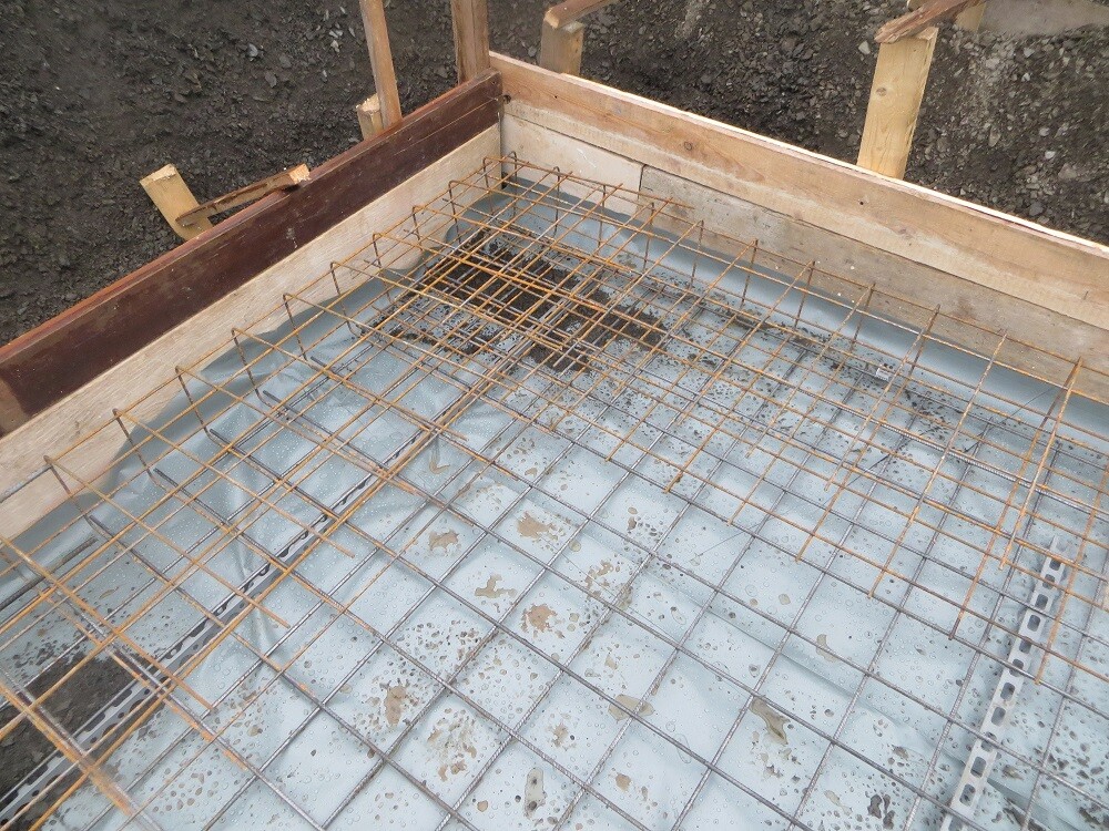

The reinforcement is vertical at that point because it was bent into a cage or an open cage facing the interior of the house. Further inside, spacer “snakes” must have been installed between the first and second layer.
If I understand correctly, you don’t have a strip foundation at all, but “only” a slab-on-grade.
Since the slab edges are far from straight, it was probably poured without formwork, which explains the irregular distances between the reinforcement and the soil.
There is also no visible plastic sheeting at the lower part that would keep the plastic spacers from touching the soil.
Attached is an example (not finished yet).
