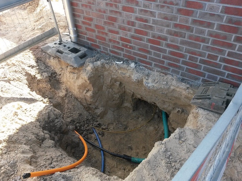

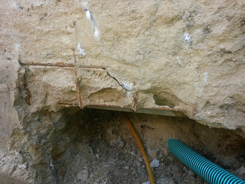

During the installation of the utility connections a few days ago, I had a clear view of the foundation slab. I noticed that the reinforcement bars are considerably exposed.

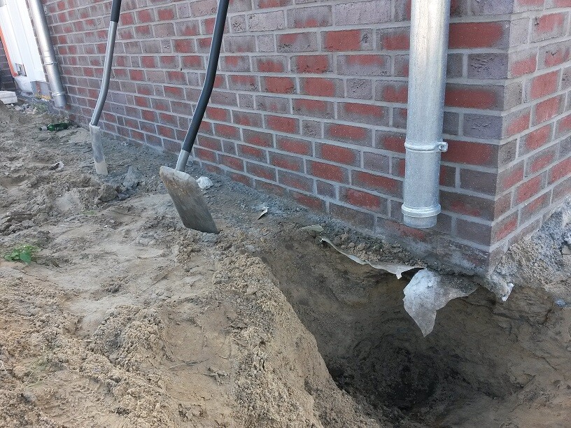

I then dug test holes around the house and found that parts of the reinforcement bars are also exposed here and there.
Workers from neighboring construction sites kindly pointed out that this might be a serious defect. The bars could rust, and the rust might eat into the slab, causing it to crack. At the same time, frost and moisture could worsen the damage.

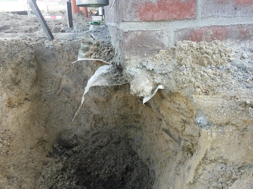

By the way, I also noticed that the brickwork is hanging free over a stretch of about 1m (3 feet).
My question now is: is this exposed reinforcement a major problem? Or can it be repaired?
