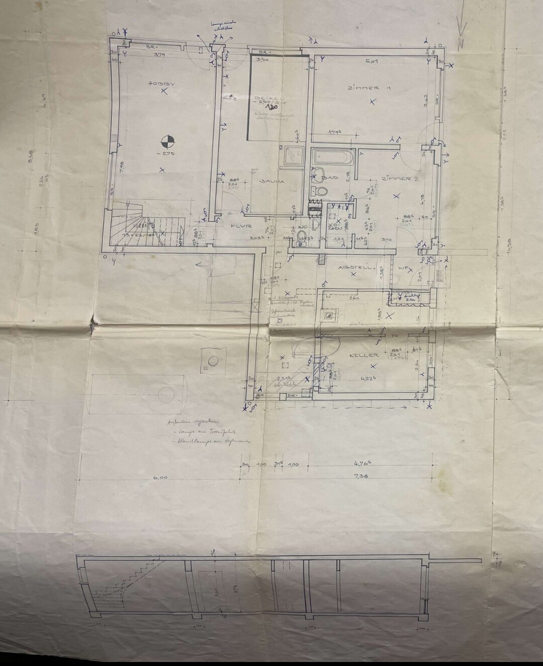

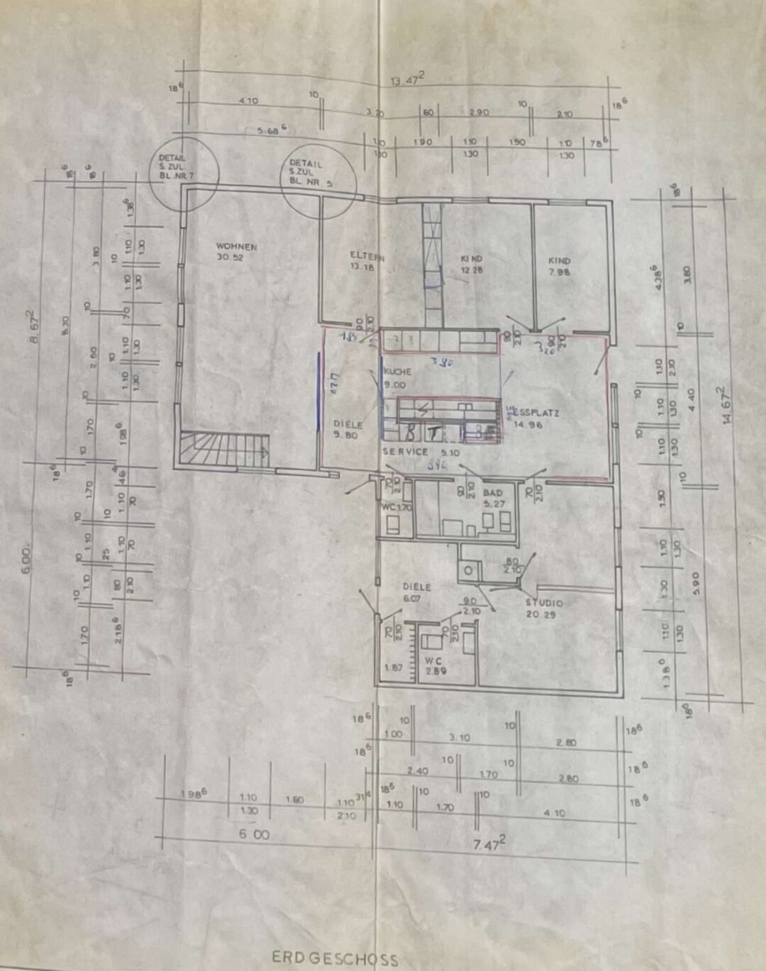

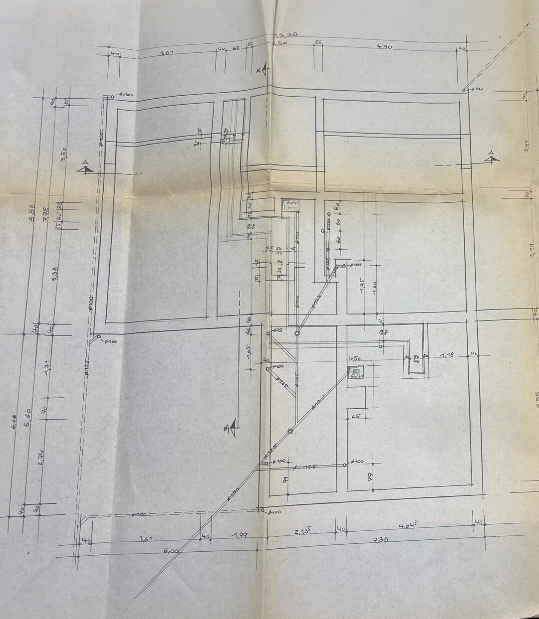

https://www.hausbau-forum.de/threads/abriss-eines-alten-keller-1970-kosten.41457/#post-531857 Attached are the house, basement, and foundation. I still need to review the building file.

Skyhawk172 schrieb:
Attached are pictures of the house, basement, and foundation. I still need to review the building file. Picture 2 of the basement and the cross-section would benefit from including the upper dimension line as well as higher contrast on the dimension lines in general.
