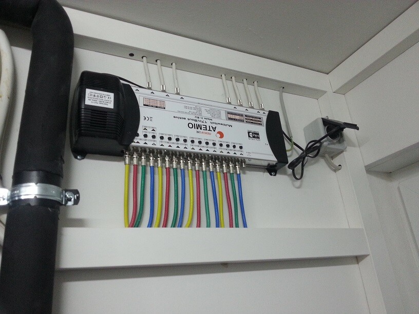

LittleWulf24 Feb 2016 20:17So does he have to offer me a 6-way multiswitch instead of the 4-way one he proposed?
I guess I should call him again to clarify this.
I was just thinking that maybe he is aware of this and by using 2 cables on a 4-way multiswitch you can get 4 outputs, and with the remaining 2 cables that would make a total of 6 🙂
The programs are distributed over four bands: vertical low, vertical high, horizontal low, and horizontal high. These are the four channels that the multiswitch from Spiegel taps into. The multiswitch then forwards the corresponding signal to the end devices. Programs that are on the same band can all be received, allowing theoretically an unlimited number of end devices to be operated in the end.
