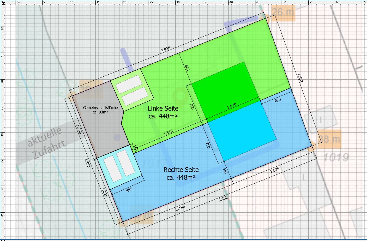

we are about to purchase a plot of land approximately 1000m² (12,000 sq ft) in size to build a duplex. Due to some unique characteristics, dividing the property fairly between both parties is proving challenging, so I’m hoping for new ideas from outsiders.
The division proposal shown below comes from us. The building envelope is marked in purple/blue. We both consider the two halves roughly equal in value and would be willing to take the north side (left). However, the building partner now wants a large garden at the back, away from the street. This is certainly a great idea for the southern lot, but the northern lot would largely lose its southwest-facing garden and the main garden would then face northeast.
We are concerned that this would mean not only giving up a nice garden but also ending up with a generally darker house.
How do you assess the situation? Does anyone have a creative idea?
An east/west division is unfortunately not possible, as neither party wants to be fully oriented to the west side (street).
Development Plan/Restrictions
Plot size: 1000m² (12,000 sq ft)
Slope: no
Maximum buildable area: 175m² (1,885 sq ft) footprint
Building envelope, building line and boundaries
Edge development: A tall hedge along the entire northern half; on the south side, a 2.5-story house and two garages (only one shown on the plan)
Number of parking spaces: 4
Roof type: hipped roof
Style: urban villa
Access: as shown in the sketch; a second/new access might be possible but would be costly and must not affect any existing trees.
Ground plan of duplex: left side approx. 448 m², right side approx. 448 m², living area approx. 93 m².

To be honest, I find the "northern" plot with its orientation to be much more attractive in practice. The colleague in the south gets direct sunlight all day long.
You in the north also have a great garden facing east (morning sun), and as the sun moves to the south, the east terrace effectively becomes a south-facing terrace because it still gets full sunlight. It’s basically a southeast garden.
If the terrace wraps around to the north, you will be either sitting in the afternoon/evening in the shade on the east side or in the sun on the north side.
The floor plan is well laid out, and you will have a nice, bright home.
nordanney
30 Aug 2024 14:29
P.S. You can simulate the sun path with the planned house online. This usually helps to get a better feel for it.

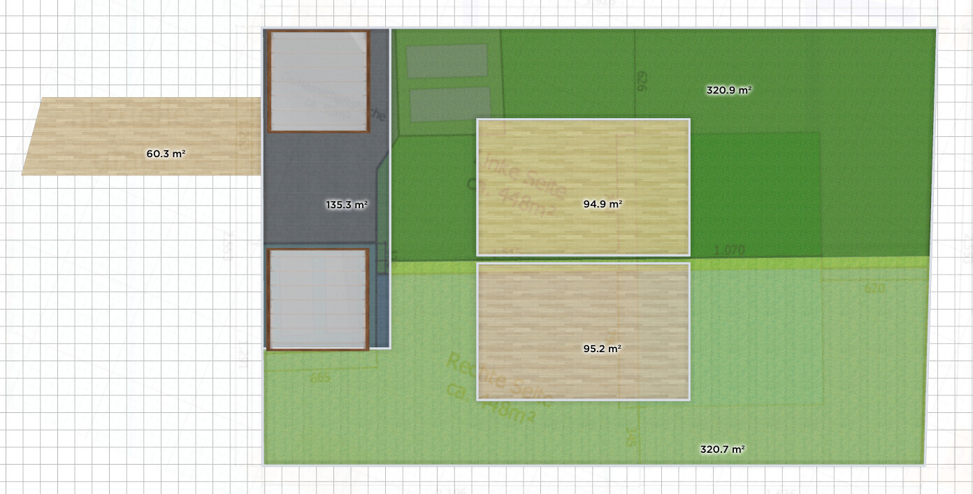

Maybe you could slightly shift the current driveway, then it could look like this
