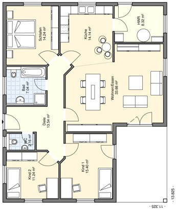

Hello community,
I would appreciate it if you could take a look at the floor plan. We’re not completely sure yet. Perhaps we are simply overwhelmed by the freedom of choice when building a new house. The plot is only verbally reserved—the planner said a bungalow (our preference) would be possible.
Plot size: 740m2 (7,965 sq ft)
Slope: no
Floor area ratio: 0.4
Building envelope, building line and boundary: The building envelope of 12 x 15m (39 x 49 ft) would be fully used by the bungalow. On the garage side, it’s 5m (16 ft) to the plot boundary, on the entrance side 3m (10 ft). The eastern property boundary runs slightly diagonal and narrows to just over 5m (16 ft) at the narrowest point.
Parking spaces: 1 garage, 1 parking space – The plot is located at the end of a dead-end street, so we need to be able to turn around on the property. I rarely drive but could imagine it might be quite uncomfortable or tight in front of the entrance area.
Number of floors: 1
Roof style: hip roof
Orientation: The garden faces northeast
Style, roof shape, building type
Basement, floors:
Number of people, age: total 4 people (2 children)
Office: home office
Overnight guests per year: maybe 5
Open floor plan
Conservative or modern design
Kitchen in L-shape
Number of dining seats: we would like to easily accommodate 8 people, although usually there will only be 4 of us
Fireplace: no
Additional wishes / special features / daily routine: I have concerns especially about the north-facing orientation. It might also be important that I work in a laboratory and have no natural light during the entire day. At the same time, I am not a sun lover—bright is enough for me. We are usually up quite early.
Planning done by: a mix of architect, ourselves, and an original floor plan
We are unsure about the entrance area. It is already narrow at the beginning, but the 2.5m (8 ft) should provide enough space. The layout of the living room also differs somewhat from standard floor plans, but we found it generally suitable.
Personal budget limit for the house including fixtures and fittings: 350,000
Preferred heating system: air-to-water heat pump
The clouds can be ignored. The windows are not yet finalized, and we will probably forgo a pantry, incorporating it instead in the utility room (if we need one at all).

Myrna_Loy schrieb:
You wouldn’t make such an offer if the plot of land is worse than an alternative.
I would politely decline. In principle, yes, but it might still appeal to someone else. Some people prioritize the perfect location of the house, while others value complete quiet and therefore don’t mind having no garden.
Myrna_Loy schrieb:
You wouldn’t make an offer like that if the plot is worse than an alternative.
I would politely decline. It’s a bit difficult to generalize. What is an advantage for one person might be a disadvantage for another.
It depends on what each person wants. For example, access could be easier with the lower plot, with the garage on the north side, the house just south of it, and a garden to the south and west. This could save travel distances, utility connections, and therefore costs, if such a layout is feasible. A street to the south would definitely be something I would consider. With the current plot, you seem to have more quietness, but that’s hard to tell without further details.
Würfel* schrieb:
Honestly, I find both floor plans quite awful.I agree.Würfel* schrieb:
In my opinion, the plot is simply not suitable for a bungalow.I don’t necessarily think so (yet). I don’t know where the building area is located or the dimensions of the plot. 5m (16 feet) here and 3m (10 feet) there – that still doesn’t tell me how the building area is oriented – vertical, horizontal, or diagonal? A site sketch with measurements could have helped, instead of just a blank rectangle.Could this work? I don’t know:
prisma17 schrieb:
Building window, building line, and boundary: The building window of 12 x 15 m (39 x 49 feet) would be fully used by the bungalow. On the garage side, there is a 5 m (16 feet) distance to the property boundary, and on the entrance side 3 m (10 feet).I understood it so that the bungalow must stand 3 m (10 feet) away from the southern property boundary and that the building window ends to the north at 3 + 15 m = 18 m (59 feet). That’s why I said that such a large bungalow does not allow for a south-facing garden.Similar topics
