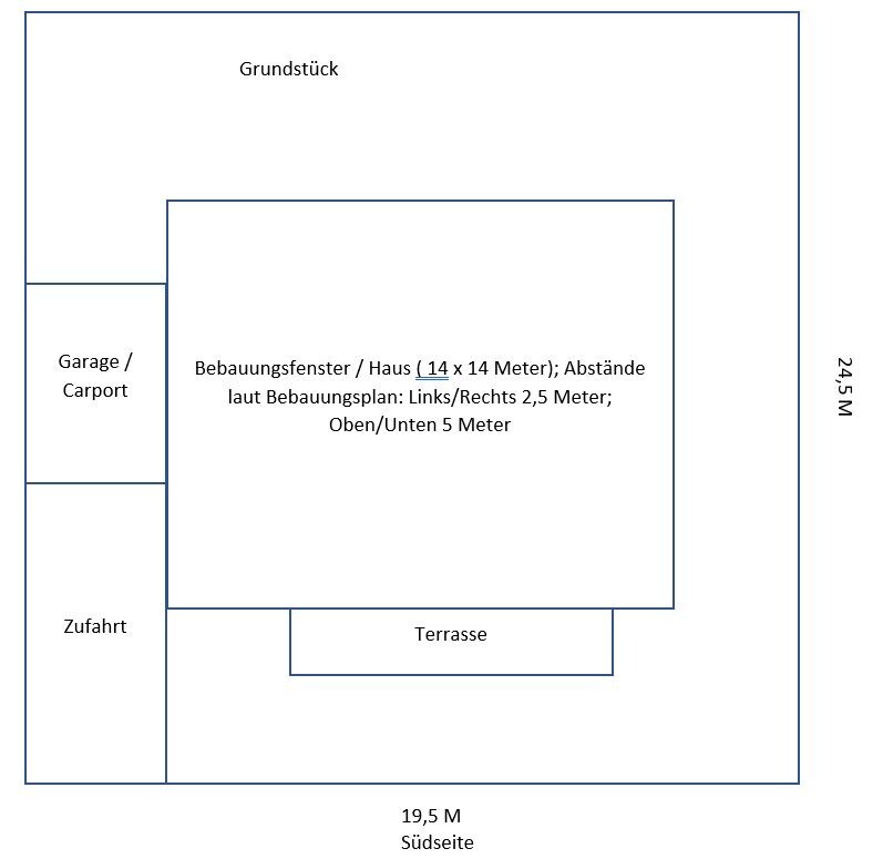

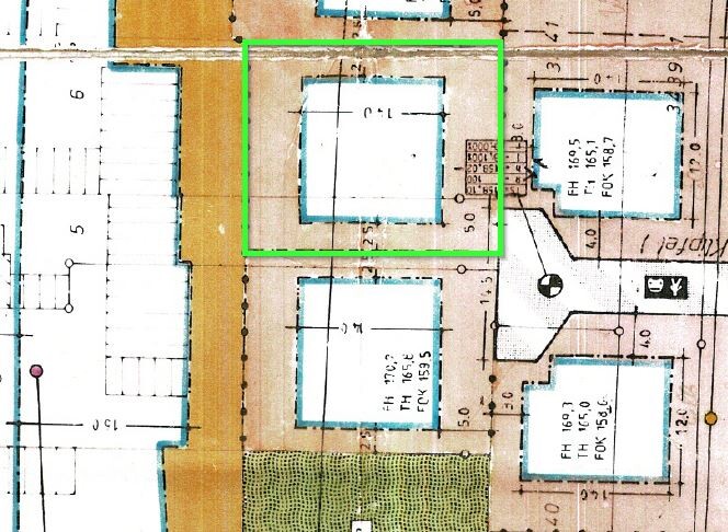

We would be interested in your opinion on how you would build on this plot. I have made a very rough sketch of how we imagine the orientation of the house and placement of parking spaces, etc. I have also attached the site plan and development plan. The questionnaire is mostly filled out, but a “final” floor plan is still missing, as mentioned. This will also largely depend on the question of whether to have a basement or not.

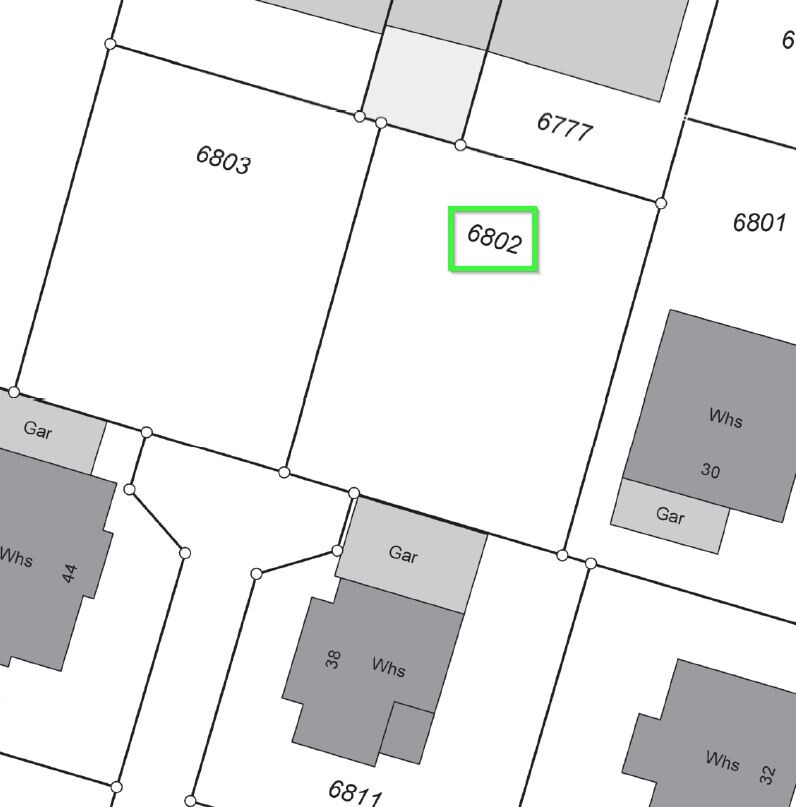

Parcel 6802 marked green on cadastral map; neighboring parcels 6803, 6811.
Plot plan: house 14×14 m (46×46 ft), terrace at bottom, garage to the left, driveway, distances 2.5 m / 5 m.

The building plot and site are sufficient for a double carport and a house on a slab foundation. I don’t see a compelling reason to build a basement. Including a basement would, in my opinion, make the budget quite tight, and there are always concerns about moisture (this also depends on the construction location and standards). Without a basement, it should work well, and you won’t have sleepless nights.
For a family with two children, a house on a slab foundation is completely adequate. If needed, the attic could be reserved for future conversion.
It is often said that the smaller the lot, the more reason to build a basement to preserve some garden space. But first and foremost, the budget for the house must be sufficient.

@WilderSueden Our site plan says "Excerpt from the land register," but unfortunately, I don’t see any contour lines on it. I think I’ll try my luck with a water level hose.

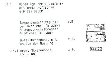

I found your basement formula: "for every 20 cm (8 inches) difference in ground height within the building plot, add ten percent of the basement cost, even if you don’t build it." So, you’re missing the information on whether there are differences in ground height, right?
My excerpt from the property cadastre unfortunately doesn’t show contour lines, but I found something in the development plan.
In the explanation to the development plan, I see:
Technische Zeichnung mit Höhenlage, Tangentenpunkten und Gefälleangaben, Textauszug
and in the development plan directly for our plot, the following data:
Nahaufnahme eines Bauplans mit Maßangaben und Zahlen
I know it’s unfortunately very hard to read... but maybe this helps?
