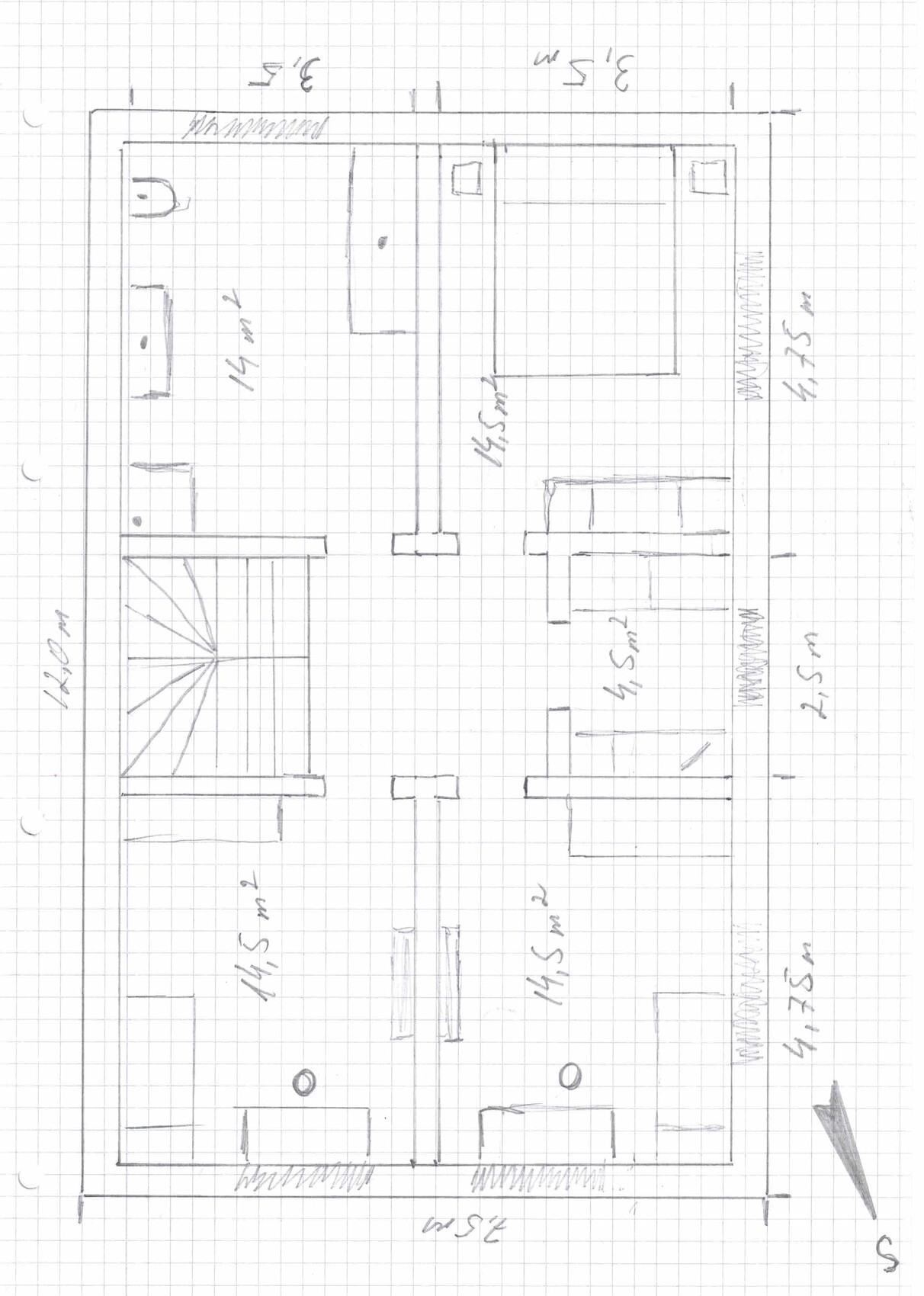

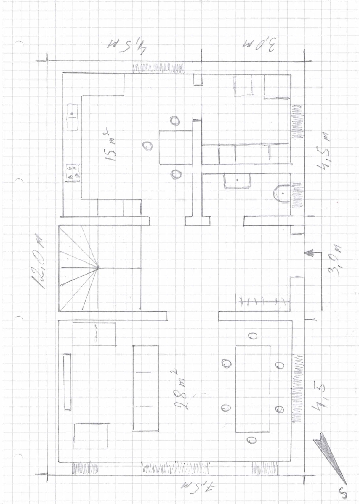

Hello, I am currently planning to build a semi-detached house for rental purposes.
The house width must not exceed 15m (49 feet), but I have flexibility in the length.
Orientation is northeast.
It will be a standard house made from 36.5cm (14 inches) aerated concrete blocks, with either an air-to-water heat pump or ground-source heat pump, mechanical ventilation with heat recovery, and a pitched roof or hipped roof (nail truss).
I have a few questions regarding improvements.
Ground floor: Should I swap the kitchen and living room? If yes, do I also need to swap the bathroom and bedroom on the upper floor?
Upper floor: Should I keep the small 4.5sqm (48 square feet) room as an office/dressing room or plan it as a children's bathroom and allocate the main bathroom to the parents?
Feedback and suggestions are welcome.

From the way you describe the market, there is excess demand for building semi-detached houses (these are also offered by developers), but for rent (which they do not offer, and that would be your market niche). So choose a design for a semi-detached house (and take advantage both of the freedom of the undivided plot and diversify your risk by creating uneven halves for similar but not identical target groups; in other words, avoid a strict 50/50 division).
Build a semi-detached house about 7m/8m wide (23ft/26ft) and already look for tenants during the planning phase, offering them some influence – almost like a developer, but renting instead. Of course, in a limited way only (no full floor plan negotiations with the first tenants, just allow relocation of a maximum of two non-load-bearing walls, choice of floor coverings, and so on). I also always recommend a standard variation (for example, a “masonry” walk-in shower in the 8m unit and only a glass cabin in the other, a double vanity in the larger unit, and standard basins in the smaller one, etc.), but strictly speaking, a batch size of two residential units is peanuts for an investor project, just mentioning this for clarity.
I don’t see any point in discussing floor plans with you since you do not want to build for personal use. Investment properties should be approached unemotionally and market-oriented. You have already taken the first step, which is market-oriented, by analyzing the market and deciding on the semi-detached design. Now you should refine this further (see my suggestion of standard differentiation and attracting initial tenants early), and take the second step: don’t turn the floor plan into your baby.
