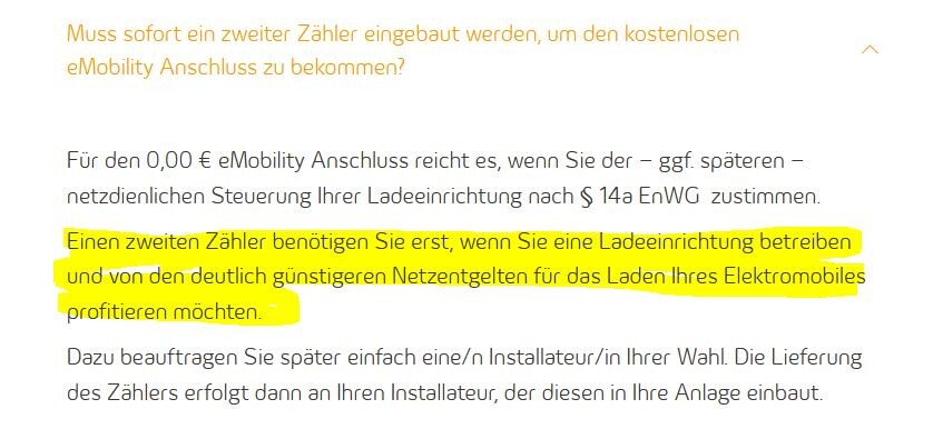

Golfi90 schrieb:
Because then you would need a second meter, right?For what purpose? Most devices already have legally verified meters built in.Similar topics
