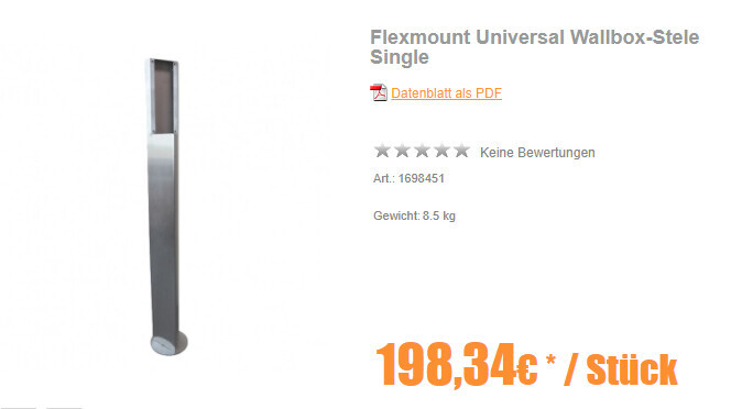

nordanney27 Nov 2020 09:00Andre77 schrieb:
Not the very expensive ones from wallbox manufacturers, but more like a DIY solution. Something you could get from a metalworker. Nothing fancy, just a “column” with a plate to mount the wallbox on. Then somehow fixing it into the ground. (How?) Does anyone have an idea what something like this costs (the “column” part)? Either go to a metalworker or order online directly (see example) and secure it on a concrete foundation. It will definitely not be cheaper from the metalworker, probably more expensive.
