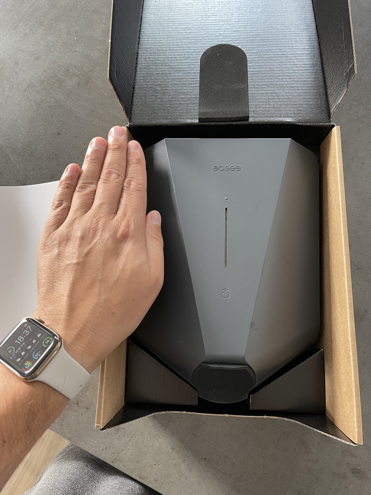

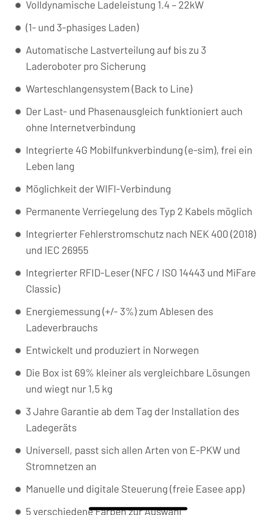

My goodness, what a mess..... 😀 - with a voucher code, 777€ (about $840) so including installation by an electrician just over 900€ (about $975)
- Wi-Fi and free 4G
- RFID
- 22 kWh (about 79.2 MJ)
- lightweight and compact
- available in 4 colors
- with Type 2 socket / compatible with new plug systems for future-proofing
- I have an EV with CHAdeMO and Type 1 plugs; since I have a Type 2 to Type 1 charging cable, I can already charge my current EV at 3.7 kWh (about 12.6 MJ) with this wallbox
- good reviews
- easy to install
- the Home version can be expanded to 3 wallboxes and settings can be shared via chargeberry
For the price, I haven’t found any other option except this wallbox from Norway with so many features.
See screenshot....
....and it is available for immediate delivery.

Can I do this independently of the house’s construction progress, or do I need to consider anything? You can’t go wrong with this unit. As I said before, it is definitely my best value-for-money winner.
Apply for the subsidy; if you haven’t identified yourself yet, do so with video identification. Buy the wallbox, then have it installed by an electrician.
Confirm purchase and installation in the KfW portal to receive the grant.
But don’t forget: you must have photovoltaic solar panels or a green energy tariff! This means the confirmation usually happens after moving in.
I’m not sure anymore, but you can apply now and then have 9–12 months to provide all the proofs.
