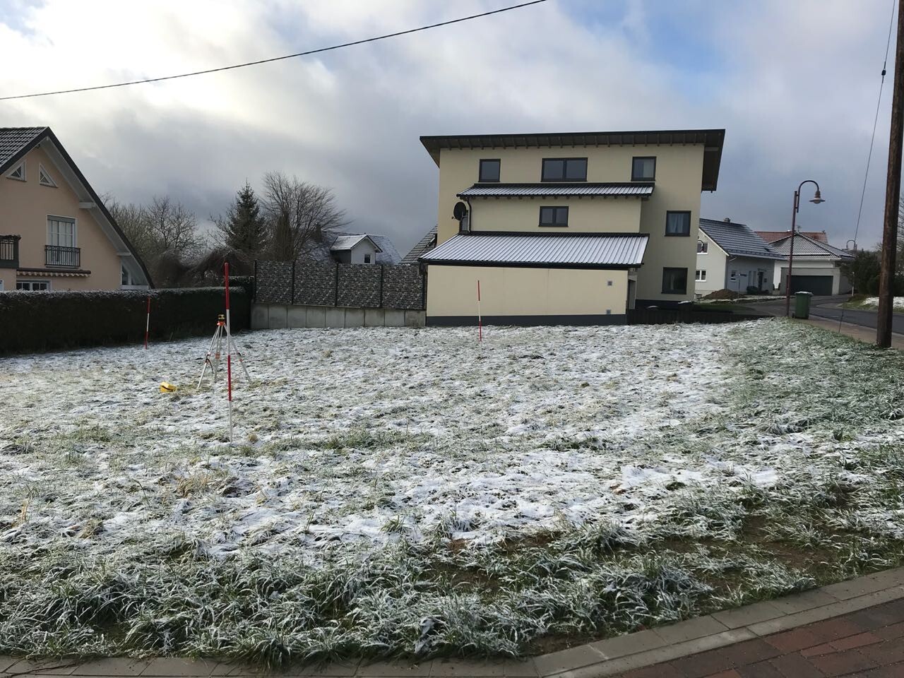

Next door there's a three-story building—phew, what a block, hard to believe something like that is allowed in a single-family home area. Horrible.
But the slope doesn’t look that steep when you compare it to the three-story building. It doesn’t seem excessively expensive. Maybe ask a civil engineer.

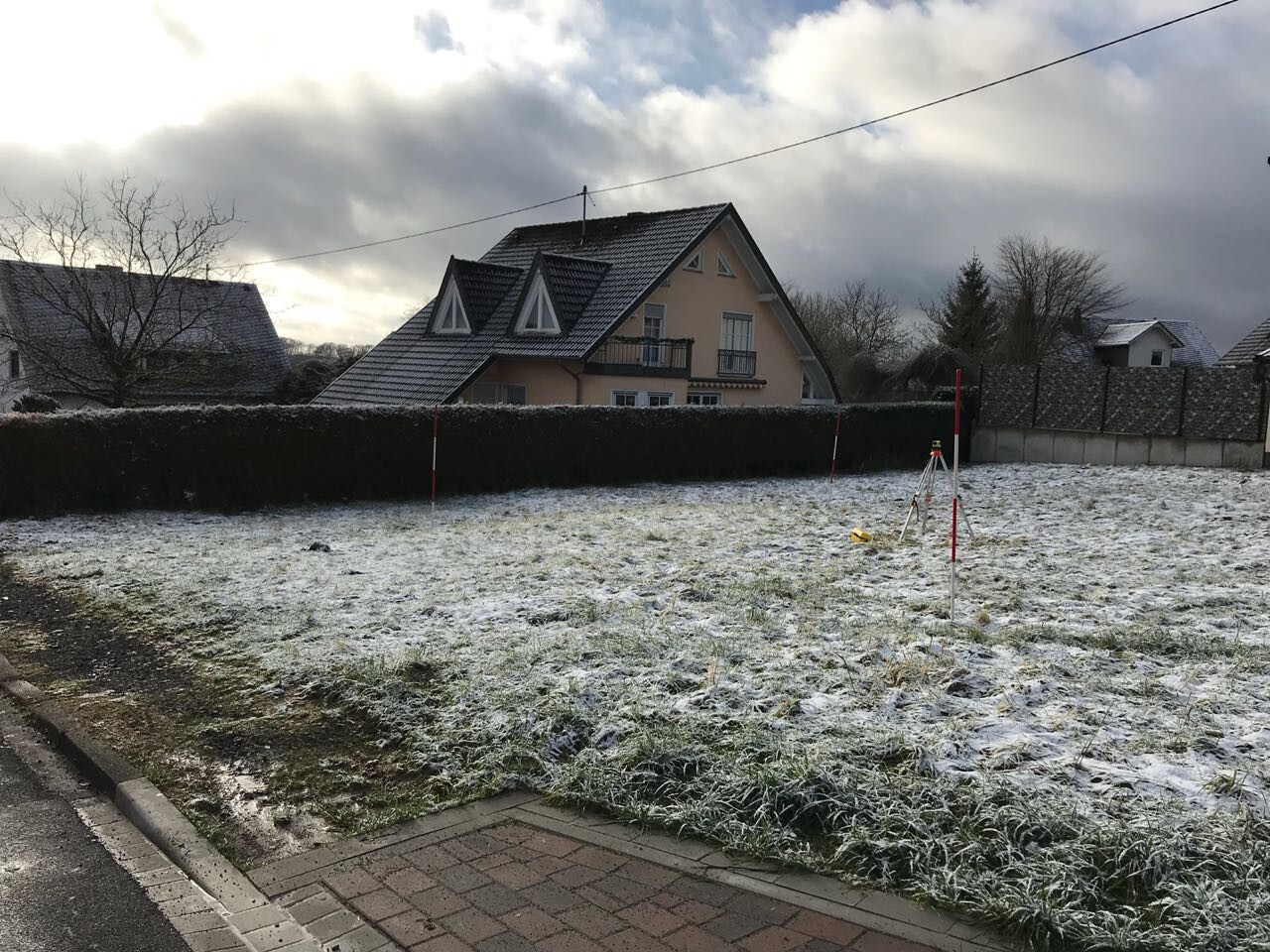

We just visited the site and took some measurements with the leveling instrument.
At the location where the house is planned, there is a 1-meter (3.3 feet) height difference from the left boundary (the lowest point). If you include the garage and everything beside the house, the difference from the lowest point is about 1.5 meters (5 feet). A potential issue could be surface water coming from the street on the right.
Should L-shaped retaining walls be installed along the left boundary (where the hedge is), or are there other effective options? There could be quite a few along the entire length, which might become quite costly.
Next door, the owner runs a construction company. Size or other restrictions didn’t seem to matter there. It’s already a huge structure.
Maybe like this. Slightly sloping the land inward without adding fill. So, starting from the street to the house, it slopes downward. You can manage water with a gravel border around the house and a drainage system underneath, which you lead to the rainwater shaft or, if the soil allows, to an infiltration trench. Then build the house with a terrace as a slab and a L-shaped retaining wall at the hedge. But only the house and terrace—the rest of the land you leave natural, just slope the soil gently up to the terrace. This way, you have a large area that absorbs water through plants, minimizing earthworks to what is necessary. You can also partially benefit visually from the neighbor’s hedge, which already saves you from installing a fence.
