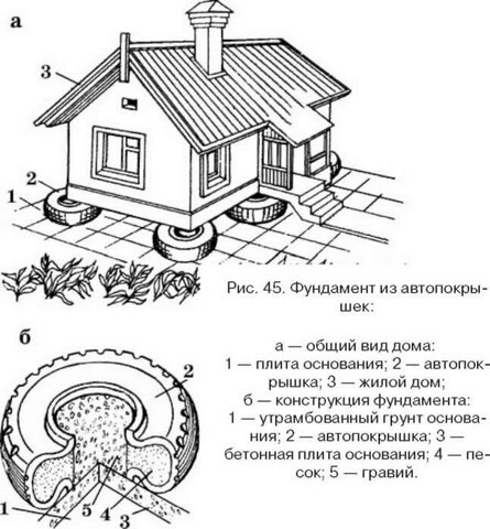

hanna-salbei28 Dec 2017 08:40Great tip, thank you! I will look into the idea with the tires. Has anyone in Germany already gotten approval for this in a building permit / planning permission?
