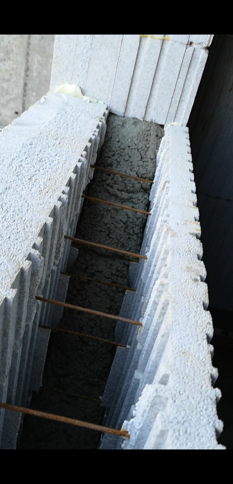

The concrete must be perfectly mixed. Attached is a photo of the first concrete pour—it flowed well and then stopped like a wedge. Even there, no wall was pushed away on the interior wall.
It was a major mistake that the Euromac2 operator did not adjust the second mixer, and the concrete was far too thin.
The next problem is if the concrete is too thick, it won’t flow past the rebar.

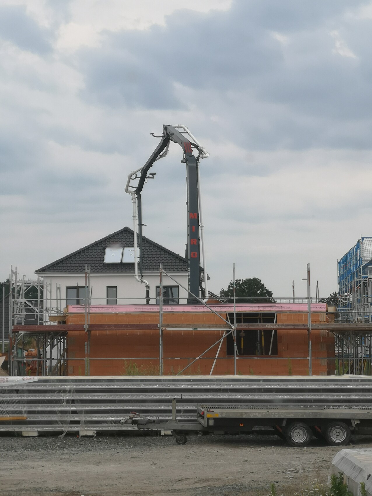

Here are some photos from my neighbor. Five days for the footings and ground floor walls, including columns. This morning, the precast slab was delivered and just finished being poured. Six days of work for the complete ground floor. With Euromac2, this is impossible. Consider 6 days x 9 hours x 3 people x 35 euros = 5670 euros labor cost...
