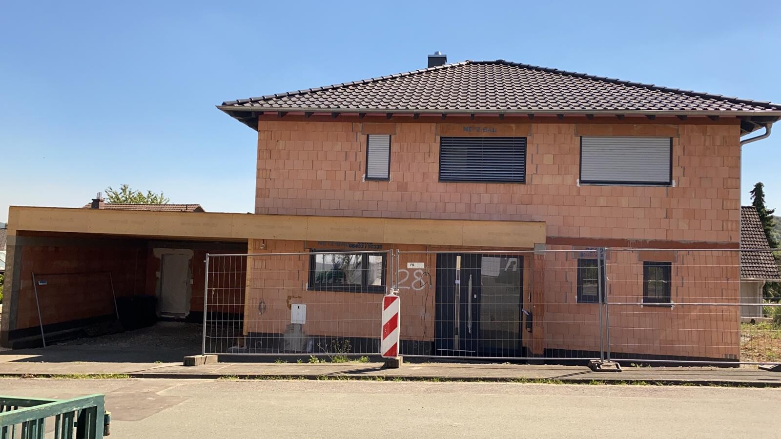

we want to plaster the underside of our carport as well. The battens are made of wood, and plaster carrier boards are to be installed. Which boards are most suitable for this? Soft fiberboard? Our builder is a bit concerned that the plaster might crack. I have often read that eaves are also plastered. Isn't that basically the same principle?

Alessandro9 Oct 2020 08:18No, it is made of wood.
The walls are masonry.

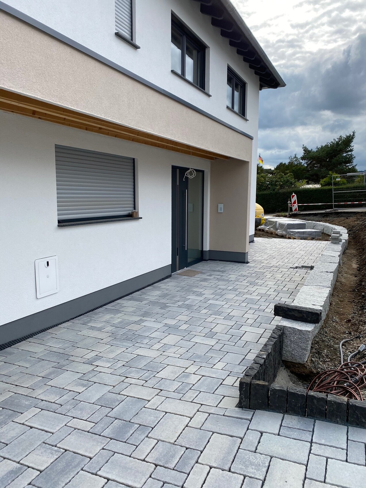

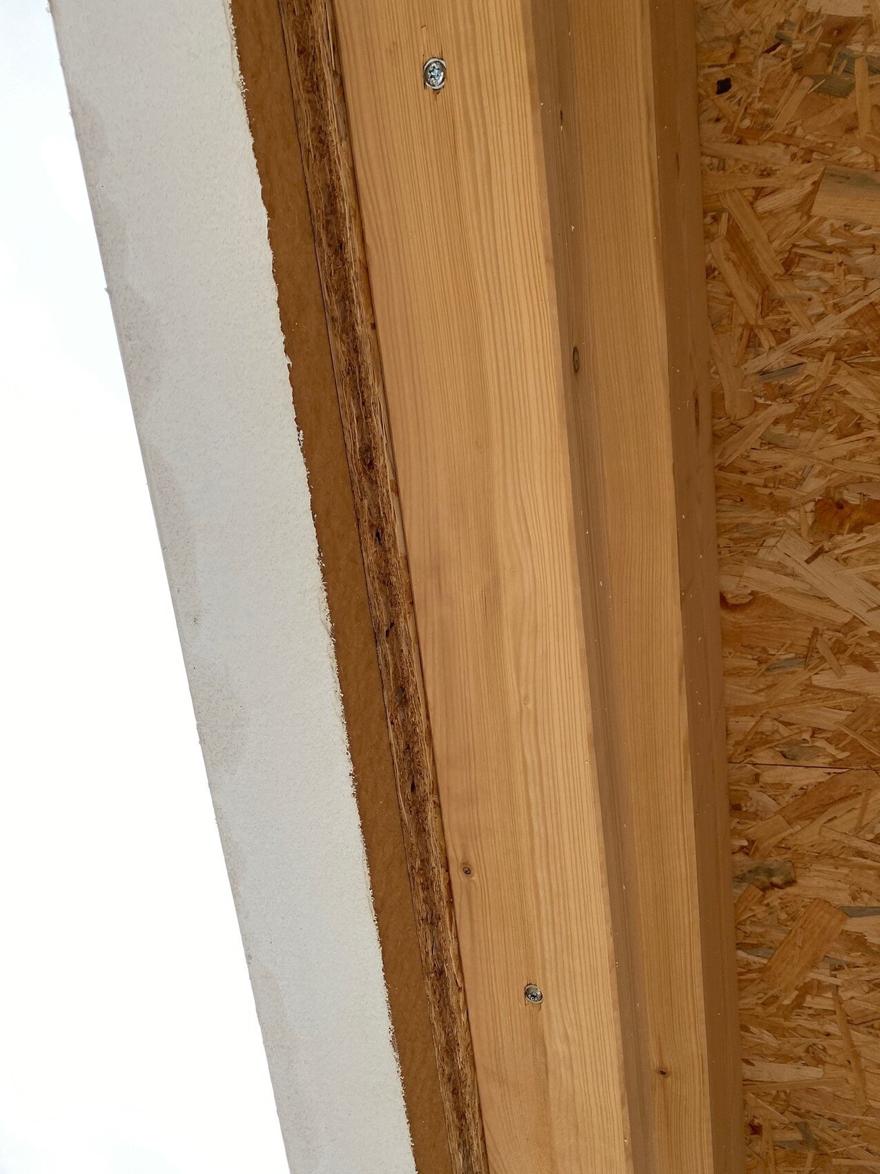

The area you plastered in "beige" includes different substrates:
- 1. A type of "wood panels." I would like to know what kind of panels those are?
- 2. The masonry columns.
- How was the plaster applied in the area with the "wood panels"? From my layman’s point of view, plastering on wood panels must be challenging.
- How were the transitions from the wooden surface to the brickwork handled to prevent cracks in the plaster at those points?

Alessandro9 Oct 2020 09:00The wood panels are plaster base panels. You can apply a base coat plaster and then the finishing plaster (the colored top layer) just like you would on brick or stone.
I’m not exactly sure how the plaster base panels are connected to the wooden beams and the stone walls. The carpenter knows that.
I told him back then how it should look and be finished later, and he understood right away.
However, I assume that the plaster base panels are only attached to the wooden structure, because otherwise cracks in the plaster would occur due to the different expansion properties of the materials. That was exactly the issue with the carport underside, which I also wanted plastered.
You just have to make sure that the plaster base panels are not constantly exposed to rain before they are plastered. That’s why you should install bitumen sheets at the top edge.
