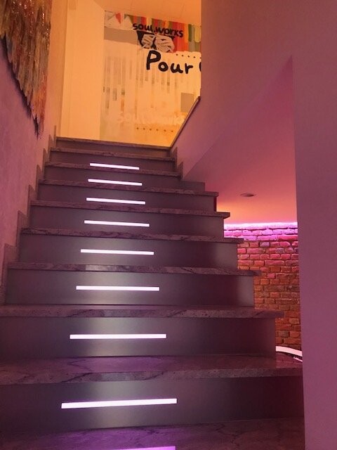

pagoni202011 Feb 2021 12:40We will probably choose a steel stringer staircase and cover the side views of the floor slab with the same steel (about 30cm (12 inches)); that is the current idea. Otherwise, I would rather consider plastering. Your 40cm (16 inches) high wood cladding also seems a bit too bulky to me. However, it also depends on where and how much wood you have used elsewhere, so it doesn’t appear too heavy.
pagoni202011 Feb 2021 21:39Yes, and whether it is already 40cm (16 inches) is also questionable. In my case, the railing is also made of wood. However, I have painted and covered everything, so it no longer has the typical wood tone... I also think that I might only have the floor structure clad and then plaster the suspended ceiling.
pagoni2020 schrieb:
Take a look, I happened to find this among my photos earlier. For me, this amount of wood as shown here would be too much.
I’m a fan of flat steel railings. We have a flat steel railing around our outdoor terrace.But, first, although it might look inexpensive at first glance, it actually isn’t; and second (and much more importantly), no insurance company would cover liability if a child or a guest child slips through and falls with this kind of design. From an insurance standpoint, for any fall height above around 1–1.2 meters (about 3–4 feet) — I don’t remember the exact figure — there must be no gap that a child’s head can fit through. This applies both indoors and outdoors.
