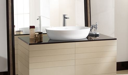

Washbasin: Villeroy & Boch Venticello 1000x500mm (39x20 inches), 4104ALR1
