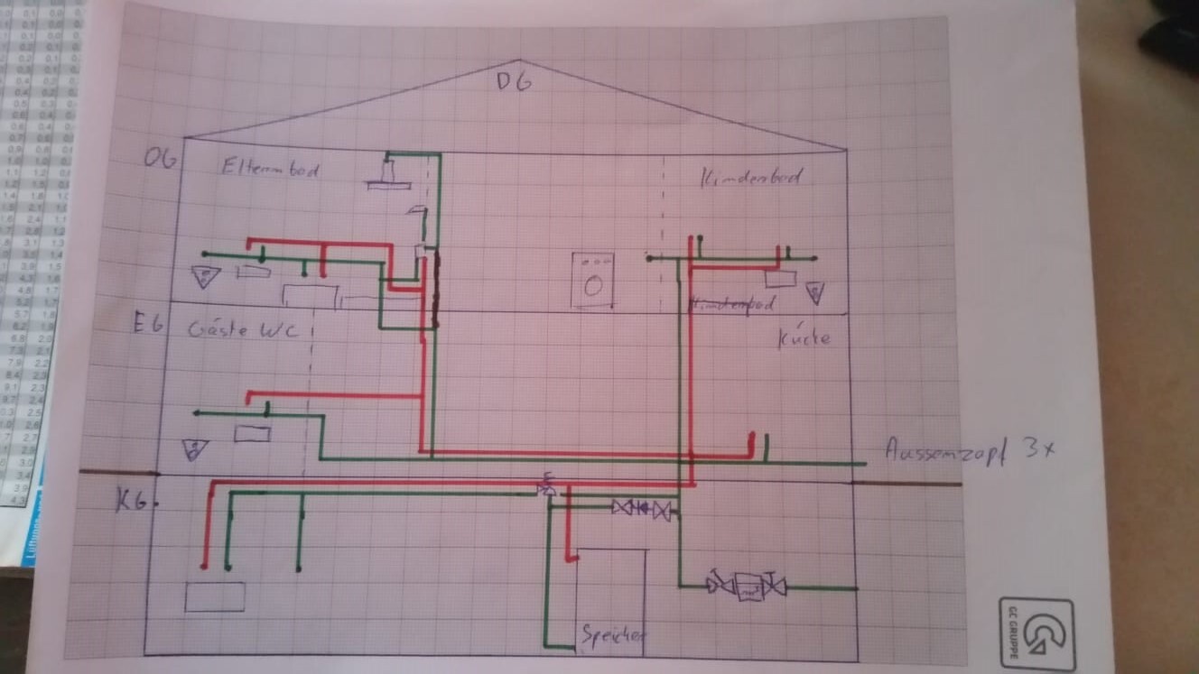

What do you think about this master bathroom layout?
We didn’t really want the shower to be so hidden since we plan to outfit it in a high-quality and stylish way. It would be nice if it could be more visible, not just for showering. But during the plumbing planning, we were advised to keep it like this (because of the water pipes).
What’s your opinion? Or does anyone have an idea on how to create more visibility into the shower?
The two washbasins are marked incorrectly. We will only use one washbasin (1m wide (39 inches)). Our idea is to move the bathtub to where the washbasins are currently shown and place the washbasin on the right wall instead. We want the bathtub to have a prominent spot in the room instead of being “in the corner” when we bathe.

Certainly, with a properly adjustable air injection just before the shower nozzles, one could achieve an even finer atomization effect. But I personally use a standard showerhead, and after 10 pm I even shower without singing out of consideration for the neighbor—without this lack of enjoyment traumatizing me (and the cleaning effect is also flawless). I don’t necessarily need my shower to transform a whirlpool into running water.It’s nice when you don’t have to, but you can do a lot.
I think this Powder lawyer is doing exactly what you describe: adding even more and finer air to make the droplets even smaller. There’s quite a strong airflow coming your way when you stand beside the running shower.
