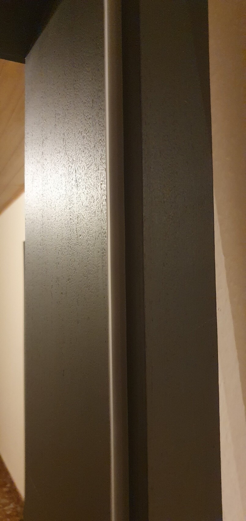

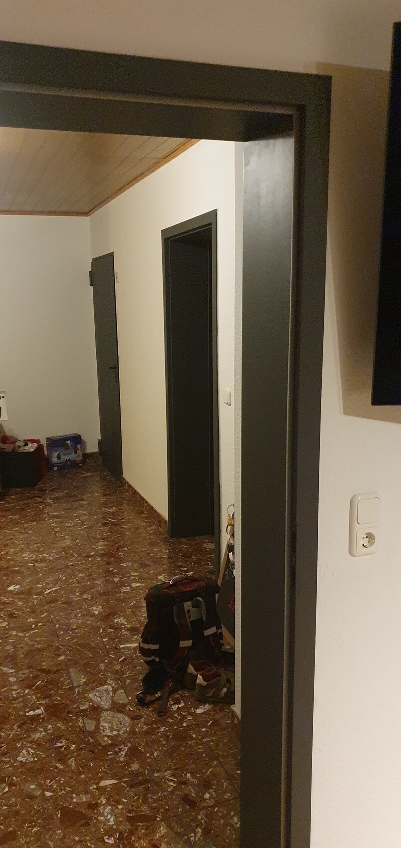

We painted half of our apartment with chalk paint and are very pleased with the results. All our door frames are now anthracite, and we bought new white door panels since the old ones were really worn out. The difference is striking.
However, the whole process required four coats: one stain blocker, two coats of anthracite, and a topcoat to protect the finish.
For white shades, you might even need an additional coat, as they don’t cover as well.
We painted the frames casually, usually one coat in the evening or so.
Costs were manageable, around 200 € for 10 door frames.
The old frames were brown and looked quite worn. I’ll look for a picture.

We painted about half of our apartment with chalk paint and are really impressed with the results. All our door frames are now anthracite, and we bought new door panels in white since the old ones were really worn out. The difference is striking.
However, it took four coats in total: one coat of stain blocker, two coats of anthracite, and a topcoat to protect everything from damage.
For the white colors, you might even need an extra coat since they don’t cover as well.
We did the door frames casually, like one coat in the evening here and there. The costs were reasonable, around 200 € (approximately $215) for 10 door frames.
The old frames were brown and didn’t look good anymore. I’ll try to find a picture. That sounds good! Why did you choose chalk paint specifically? Which one did you use, and where did you get the paint from?
Did you sand first and then prime (is that what you mean by stain blocker)?
