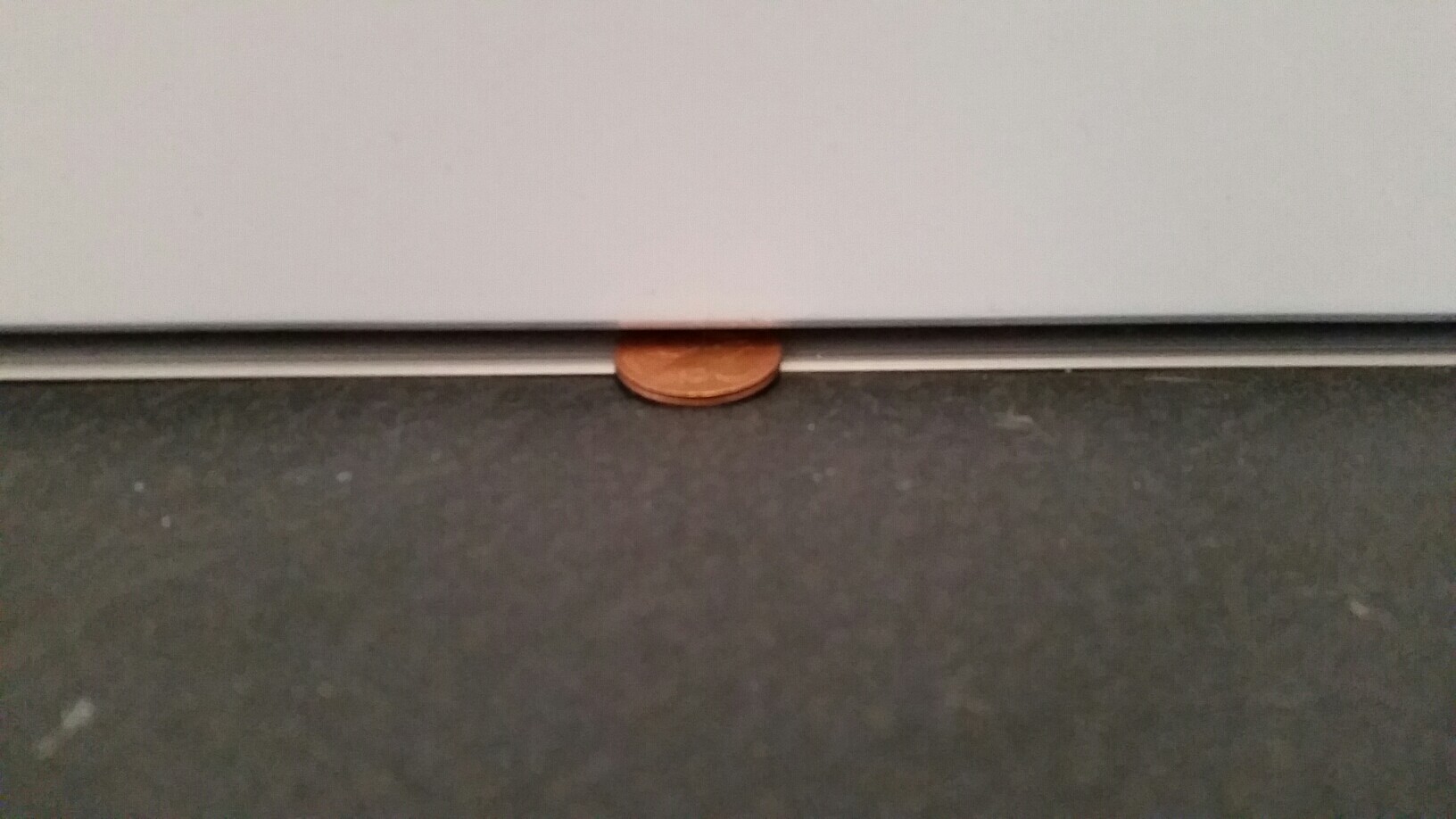

tomtom794 Mar 2016 14:50
What kind of gaps do you have under your door? For us, it’s at most 5mm (0.2 inches), if not even less.
A small cent visibly stuck between the floor and the door threshold, gap measurement around the door area.
There is even a plastic edge under the door as far as I can see.

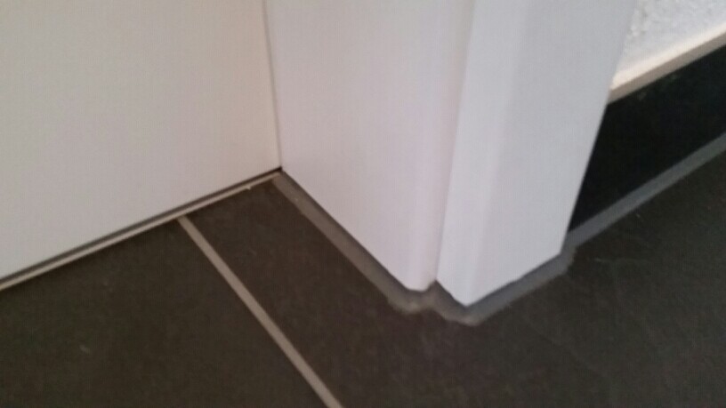

The door frame is sealed with silicone towards the tile. I think it looks better like this than without.
White door frame edge meets dark floor tiles, corner between wall and door opening.

If there really is a rubber seal, that would be a pretty poor design choice for a mechanical ventilation system with heat recovery.
tomtom794 Mar 2016 14:55
It is plastic, just checked again, probably to protect the bottom edge of the door, for example, against water.
