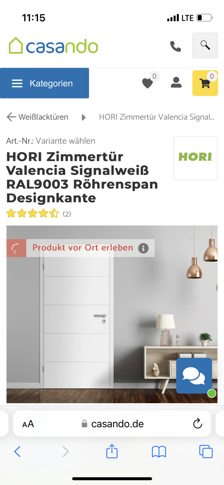

Alibert8718 Jan 2023 11:37Tolentino schrieb:
. More important than the brand is the "grade," and chipboard with tubes is the second from the bottom. I have that too and so far am satisfied.
What do you mean by grade? And which one do you have? This Valencia model?
Sorry, I meant the quality level of the core material. Honeycomb core is the cheapest. Then comes tubular chipboard, which actually has two different types: tubular chipboard beams and tubular chipboard panels (in ascending order). After that, there is solid chipboard, and finally solid wood (which is nowadays unaffordable; some even say it performs worse than solid chipboard in terms of sound insulation).
