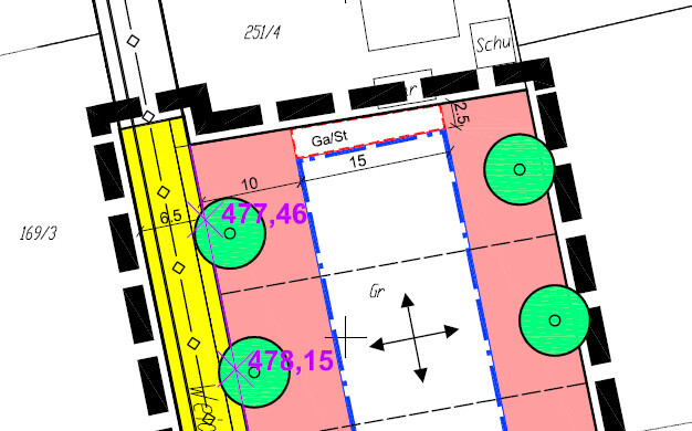

New questions:
1. I read that hiring a lawyer for the contracts is recommended, but that can be quite expensive... Which contracts are we talking about? Is it really necessary?
2. Attached is a picture of the plot (477.46)... The problem I see is that there is very little space for the garage. You wouldn’t be able to open the car door.
If I make the garage 50cm (20 inches) wider and keep the 2.5m (8 feet) distance on the other side to the neighboring property, that leaves me with a width of about 9m (30 feet) for the house. I’m calculating a width of about 14m (46 feet). I can live well with the length of 15m (50 feet).
But only 9m (30 feet) of width!?
We want two children, so four people living there. I think 150m² (1,615 sq ft) should be the minimum, right? In addition to the building contract, we still have to find a suitable house in the builder’s program =/
3. A basement is too expensive for us. So now I’m wondering, is there a smart way to gain storage space? Maybe a garage with extra storage? Also, what kind of “garage” would be suitable if we build it directly attached to the house? Wouldn’t it block light or reduce window space? Or maybe we could build the garage offset, with the garage first and then the house, since the house probably won’t be the full 15m (50 feet) in length... THINKING. What do you think?
How would you best work with or divide the building area?

11 Aug 2016 23:34
You need to read the entire development plan carefully. Based on your interpretation, your neighbors might not be allowed to build a parking space or garage.
You should generally start with the house construction first—it seems like the garage will be postponed initially for cost reasons anyway.
The expert is there to check the construction contract for any hidden pitfalls. In addition, someone should supervise the construction—especially for budget builds, you should consider hiring a professional for this, possibly through your insurance.
Regarding point 3: see above. Others have already built without a basement— you can also search for the topic of basements here.

Schwabenland
12 Aug 2016 00:04
@ypg
"You should generally start with the house construction right away – it looks like the garage is being postponed for cost reasons."
What do you mean by that? Just not worry about it for now? Why?
I have thoroughly read the development plan and am familiar with the technical height, ridge height, angles, landscaping, etc.
Of course, it makes sense to review everything, I just didn’t realize that before.
But what exactly?
- The scope of work specification
- Which contracts? What makes sense?
- Who inspects a construction project like this, what do you call these people? Do they come to the building site and check everything? What might such a person cost?
Can anyone recommend someone to review the scope of work, etc.?
Is it possible to do this online? Is everything available from a single source?
