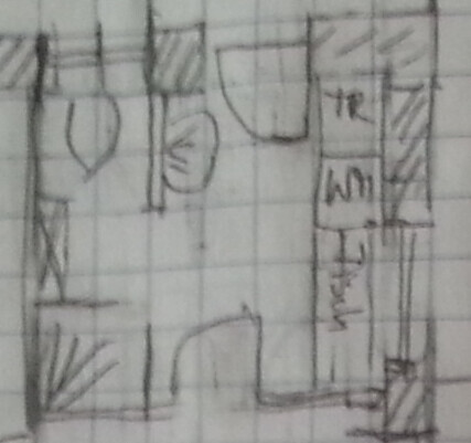

j.bautsch12 Aug 2016 13:07Climbee schrieb:
...so we are planning a combination utility room/guest bathroom on the upper floor... I’m interested in that. Do you already have more detailed plans?
A preliminary draft plan, which still needs to be adjusted.
Basically, it’s a simple bathroom where the washing machine and dryer are placed on a raised platform (for back comfort!) with drawers underneath for items like laundry detergent. There’s a small dedicated space for a sewing machine, which will be fixed in place, and of course, a sink is needed. Then, separated by a plasterboard partition, there is an area with a shower and a toilet.
Screenshot:
The 2m (6.6 ft) line is roughly located near the washing machine/dryer from the right side; the door leads out onto the green flat roof of the garage.
We haven’t obtained the building permit / planning permission yet, so this is really just a very rough concept at this stage. Once the permit is approved, I’ll keep bothering the forum by sharing our entire design for discussion.
Screenshot:
