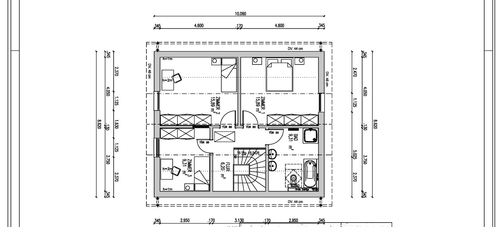

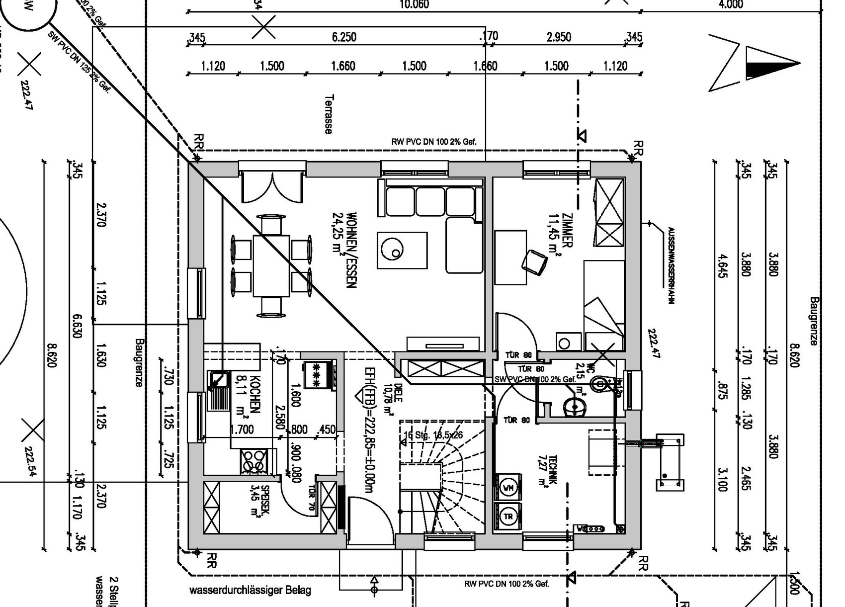

ᐅ Our floor plan. Any suggestions or tips for improvement?
Created on: 11 Sep 2016 12:16
Phantom
Phantom
11 Sep 2016 12:16
We have a design consultation in a few days and still haven’t decided how to arrange our bathroom, for example, where to place the bathtub. Additionally, we are leaving out the side window in the living room. Do any experienced users notice anything else? In the guest room (ground floor), the window will be modified to allow access to the terrace.
There are three of us in the household, and we are planning to have more children.
Thanks a lot.
Have a nice Sunday.
Grundriss eines Hauses von oben: Küche, Wohn-/Essbereich, Zimmer, Bad, Treppe, Terrasse.
Grundriss eines Obergeschosses: drei Schlafzimmer, Bad, Flur, Treppe und Möbel.
L
Legurit
11 Sep 2016 12:47
Skip the pantry and include that space in the kitchen instead – otherwise, it will feel very cramped. You can also store food in kitchen cabinets, even in cupboards.
merlin83
11 Sep 2016 12:56
Door to the technical room opening inward
taxpayer
11 Sep 2016 13:48
Just a tip and not related to the floor plan. I would change the location of the outdoor water tap and place it either on the exterior wall of the restroom or the utility room. Running the wastewater pipe straight across under the house definitely wouldn’t be my choice. I would always route the sewage pipe along the shortest path to the outside, even if it means a slightly longer run outdoors. You won’t be able to access it once it’s under the house, or am I misreading the plans?
L
Legurit
11 Sep 2016 13:51
What does the outdoor water tap have to do with wastewater?
merlin83
11 Sep 2016 14:20
BeHaElJa schrieb:
What does the outdoor faucet have to do with wastewater?
I find the idea quite interesting to dispose of wastewater using the outdoor faucet.
