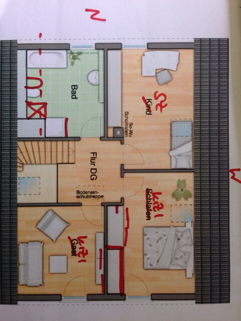

we are planning to build a 150 m² (1,615 sq ft) house and are currently optimizing our floor plan... Overall, we are quite happy with it, but there are still a few doubts.
I’m a bit uncertain about the following areas:
- Living room: Is the sofa placement very awkward? I’d prefer not to rotate it 90 degrees, as that would require placing the TV on the short window wall...

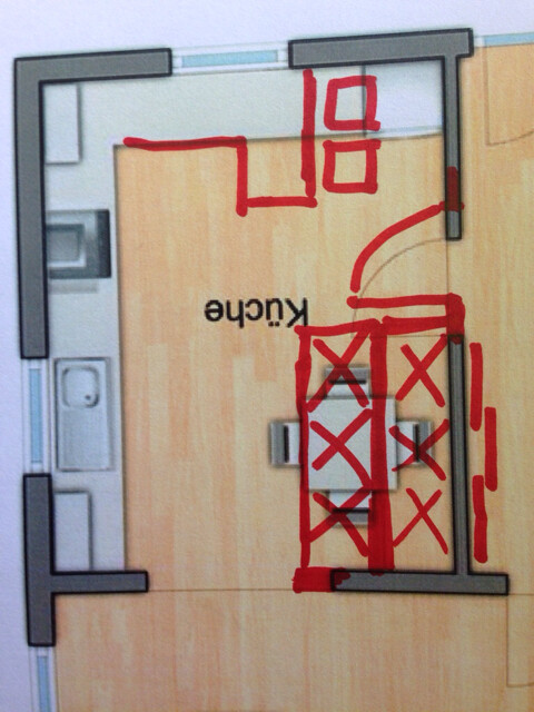

- Kitchen: Do we need a separate heating source, or will the living/dining area provide enough warmth for the kitchen? I can’t immediately think of a good spot to install a heater there.
- Pantry: Is it practical in this layout? Of course, the space with a width of 60 cm (24 inches) isn’t ideal, but could it still be used for spare chairs or similar items? Additionally, we want to store drinks, cordless vacuum cleaner, paper/plastic waste, baking trays, etc. — basically all things not used very often or too bulky for kitchen cabinets.

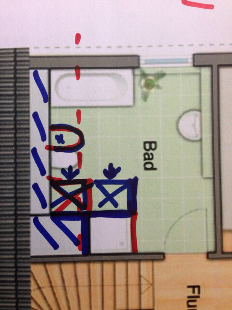

- Upstairs bathroom: I’d rather not fill the large room with very expensive bathroom cabinets, which is why I came up with the idea of the space behind the shower/bathtub. Is there enough room between the sink and the bathtub/shower for 2 to 4 people to move comfortably if needed? I’m quite enthusiastic about this idea. Previously, the sanitary fixtures were just placed around the edges and there wasn’t even space left for a cabinet.
If anyone feels like taking a look and sharing their thoughts, I’d really appreciate it!
Thank you,
hemali

I took a look at the house: I actually find the floor plan quite okay for a family, considering the budget is limited.
In the utility room, you can carve out a corner for an emergency shower, move the door slightly, so you can place shoe cabinets and hooks as a coat area along the long wall.lol... I understand
I mean, of course, everything for the guest bathroom: move the door slightly and then take about one square meter from the utility room area at the back and add it to the emergency bathroom (-> move walls), so you get a built-in shower. Toilet and washbasin then on the other side.
hemali200322 May 2016 14:12We initially planned this option as well. However, I had an issue with the reduced size of the utility room. But if you take some space from the kitchen, which could be done internally (so without losing any windows), that might also be a possibility. Maybe even a bit more than in your picture, which would also reduce the walking distances in the kitchen (which would then have an L-shaped layout due to the room shape).

Here is another kitchen variant with a children’s seating area and tall cabinets along the wardrobe wall, as well as the upstairs layout with a suitable master bedroom and two children’s rooms. One of the children’s rooms next to the central wall gives some space to the other. This results in two closet niches without having to move any windows, and the room sizes balance out.
In the bathroom, the shower can be built-in, and if the toilet is moved, it creates a space where you can build a built-in closet or shelving with drywall.
