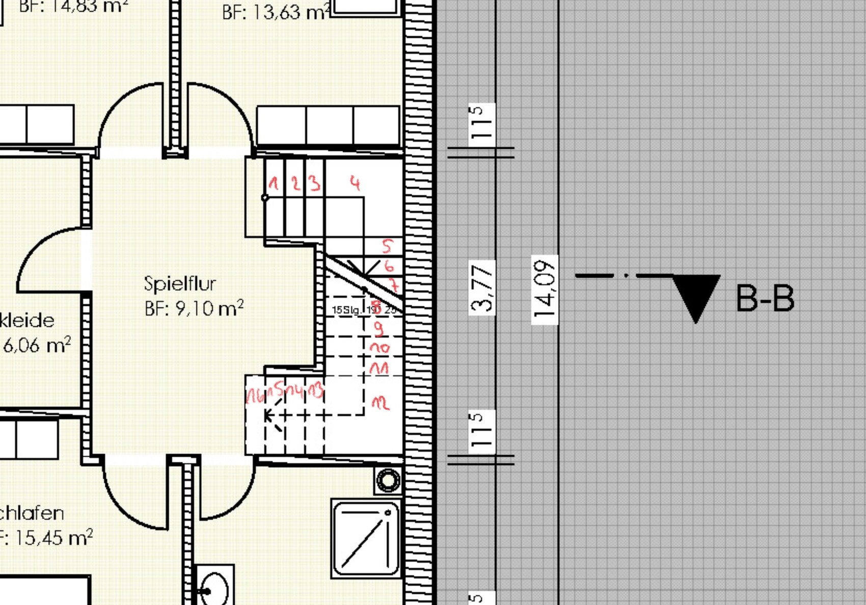

K a t j a schrieb:
If you want to run up and down a staircase every day with a 19.5° rise and a 25cm (10 inch) tread – you probably won’t die from it. This staircase still meets DIN standards, but especially going down it slowly becomes dangerous. That’s how it is. Going up will only give you strong calves like a soccer player, but going down is like winning a medal in a national competition for barrier-rich building. At the slightest joint ache, you’d rather die than change floors, or you lease a 1.39m (4 feet 7 inches) wide strip from your neighbor for an external elevator ;-)
Two steps on every landing, and the problem is solved.
So, back to the staircase. I think the architect hasn’t fully updated the staircase design or the labeling to reflect the current status. The ceiling used to be at 25 cm (10 inches). If I calculate: 290/15 = 19.33 and when the ceiling was still 25 cm (10 inches): 293/15 = 19.53.
And if I count the steps on the plan now, I get 16 steps.
Possible ceiling height on the 1st floor with 250 cm (98 inches): 288/16 = 18.0
Possible ceiling height on the ground floor with 240 cm (94 inches): 278/16 = 17.4
As I said, I need to discuss the staircase again with the architect.
What do you think would be the appropriate step height at the house entrance? For those rare weather events, is a 16 cm (6 inch) step necessary? Or would 5 cm (2 inch) be enough? Or would that become a tripping hazard? Both entrances (front and back) do not face the side exposed to the weather. And as mentioned, the living room or similar is not on the ground floor, in case there ever is a 100-year weather event...
Are there any further comments on the original question and the room layout on the ground floor?
To calculate the staircase, you better not rely on the sketches shown. Apparently, they are outdated or not very reliable anyway. Use the room dimensions it occupies and calculate based on the space you allocate for it. For sketches, I usually work with a rise of 18.5cm (7.3 inches) and a going of at least 26cm (10.2 inches) — just for comparison. If you have larger feet, you should consider a going of around 27cm (10.6 inches).
And it should be noted that if the floors have different ceiling heights, the rise per step will change on each floor even if the stairwell opening remains the same size.
The middle floor could be critical, as the doors are already very close to the stairwell and not very wide.
5cm (2 inches) steps are actually tripping hazards. It’s better not to build them. For such low thresholds, a ramp would probably be more appropriate.
By the way, I think it’s acceptable to have a ceiling height of only 2.40m (7 feet 10 inches) on each floor. Especially in residential areas where you are building next to existing older buildings on both sides, certain regulations are naturally part of living together.
hanghaus202318 Dec 2022 09:38The minimum ceiling height for living spaces is 2.4 m (7 ft 10 in). I don’t understand why the living room is planned with only 2.3 m (7 ft 7 in).
