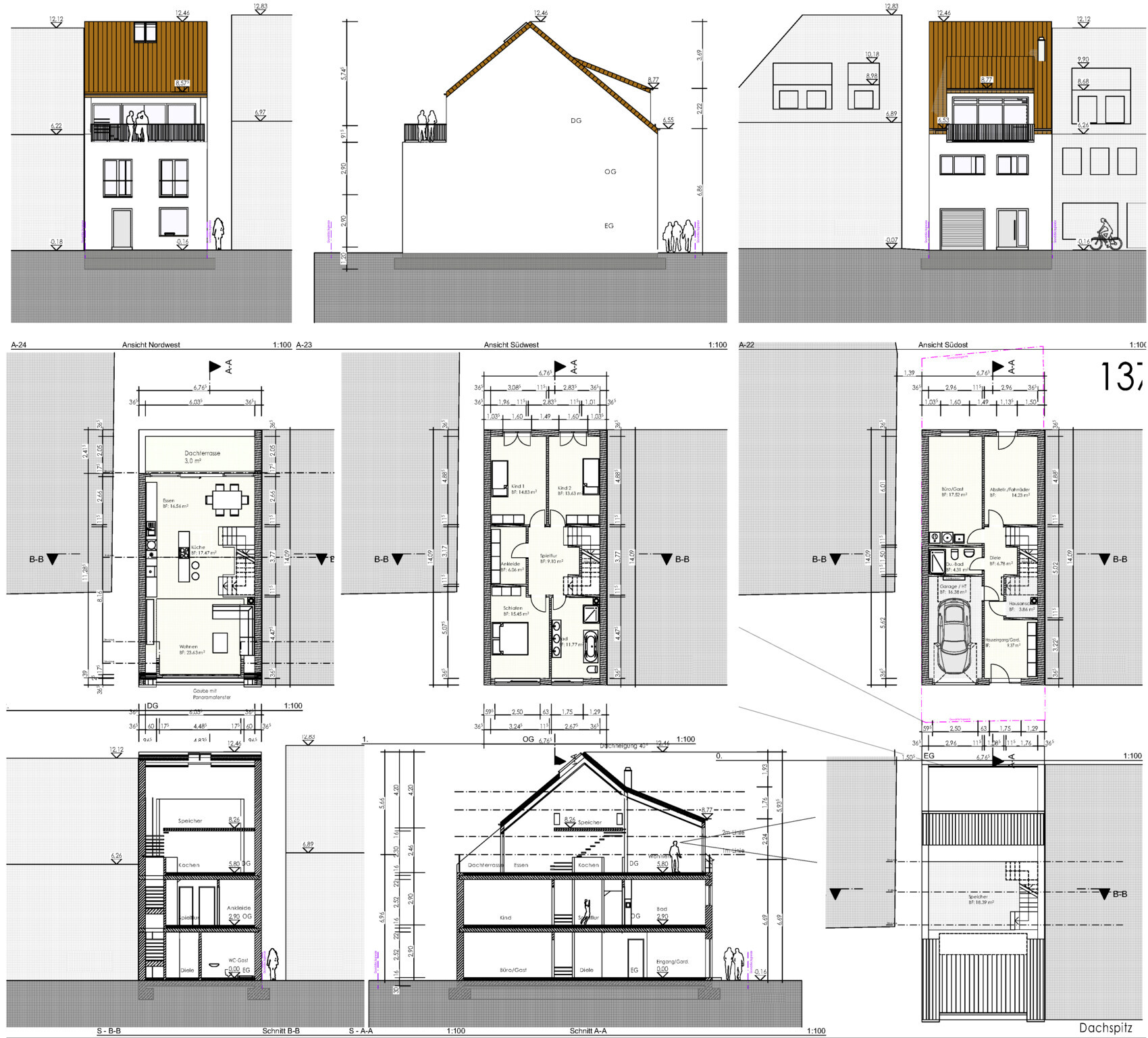

We are about to receive a building permit for our small plot. Overall, we are quite satisfied with our floor plan, but I’m still unsure if the layout of the ground floor is optimal. Essentially, our project can be described as an apartment within our own house. Since our building directly borders a public space and we won’t have a basement, the ground floor will be used purely as a functional space. The first floor will contain the children’s rooms and bedrooms, and the attic will have the kitchen, dining, living area, and gallery. We also plan to install a small goods lift in the stairwell.
Before finalizing the detailed construction plans, I want to review the floor plan carefully and make any necessary adjustments, provided these do not affect the building permit. The house can be accessed from the front via a walkway and at the back through an inner courtyard. One parking space will be relinquished, and one parking space needs to be included within the building.
Do you have any suggestions for the ground floor? I’ve attached a plan. The furniture shown is only a rough guide and won’t be the final layout, but the intended use should be clear. Here are the requirements I have for the ground floor, and I’m currently considering which layout suits these best. I’m also uncertain about the 16cm (6 inch) raised floor slab. I would prefer to avoid this and instead use that height in the attic. I also find step-free access more comfortable.

This 3.8m² (41 sq ft) utility room — what exactly is inside besides the shaft? The architect apparently placed the heating system next to the washing machine. That makes sense, but then it shouldn’t be labeled as guest or office space.
Unfortunately, I can’t get used to living in the attic. No matter how unattractive the backyard might be now, even the smallest outdoor access on the ground floor is more appealing than a rooftop terrace. But this realization will probably only come after construction.

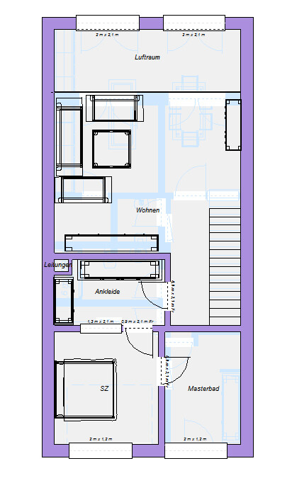

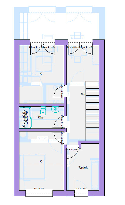

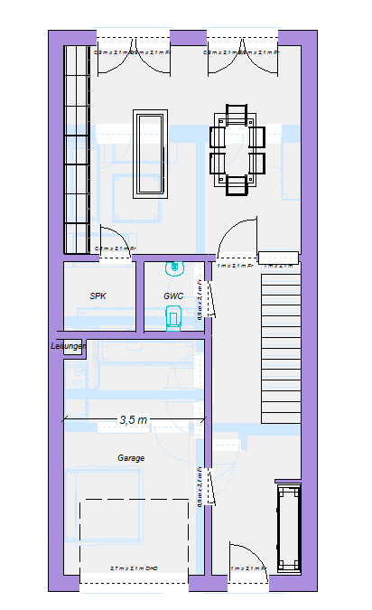

If it were mine...
... I would probably design the ground floor similar to Yvonne’s plan.
On the upper floor, I would create an open void connecting the living area via a gallery. The parents’ suite would also be located there. The attic would be reserved for the children’s rooms, technical installations, and the children’s bathroom.
The very top would be kept for Christmas decorations and such. I can’t show this because my software only supports a maximum of three stories. You’ll have to imagine it yourself. For the stairs, I’ve now simply assumed a floor height of 275cm (9 ft), with a ceiling height of 240cm (7 ft 10 in).
