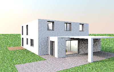

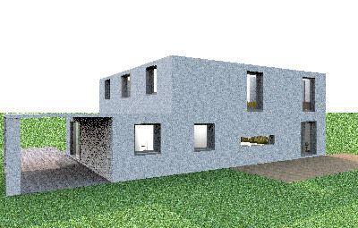

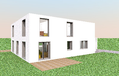

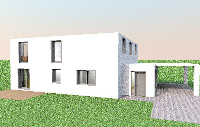

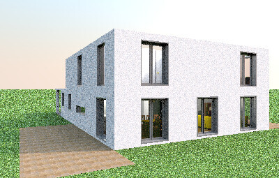

3 m (10 ft) bedroom width – this alone is already a dealbreaker.
The guest door probably won’t work like that – hard to say without dimensions.
It’s unclear which part is placed on top of what.
Hallway and corridor area.
Elevations, windows?
The vestibule is completely oversized.
The hallway is as dark as a bear’s backside.
Strange corners and angles on the upper floor.
The walk-in closet is hardly usable... The passage blocks one side for a wardrobe, the door blocks another, and the window probably blocks the third.
Northeast children’s room orientation, or how is it positioned?
Air-to-air heat pump?! It’s unclear whether that makes sense.
Please upload the current floor plan again, at least with windows included, and also with furniture… then you will see that there are problems.

Well, a bedroom measuring 300 x 500 cm (10 x 16.5 feet) should work. The bed will likely be placed with its headboard along the 500 cm (16.5 feet) side.
However, I find it much easier to evaluate a floor plan
That way, potential weak points can be identified more easily.
- when all windows and doors are at least marked where they are intended to be,
- when the width and height of the windows as well as the intended sill height are clear,
- when the proposed furniture layout is at least roughly, but definitely to scale, shown in the rooms.
