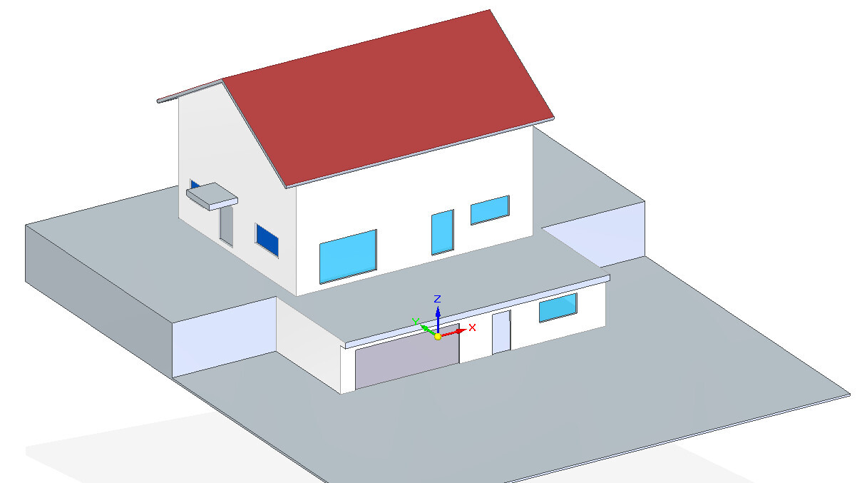

I plan to add soil behind the "garage" and then place the main house at ground level. Attached is my own sketch to clarify the exterior layout.
The layout of the rooms on the ground floor, especially the utility room, does not suit me either. I would prefer if the staircase from the garage and the staircase to the upper floor were aligned vertically.

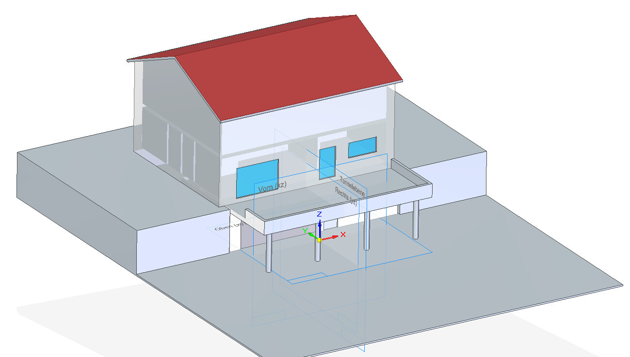

Since I am quite unhappy with the floor plan, I sketched a new model today with the garage in the basement and a terrace supported by columns or beams. This way, the house would be fully basemented.
At first, I wanted to avoid "dark" basement rooms, which can be more expensive than enlarging the house’s floor area.
