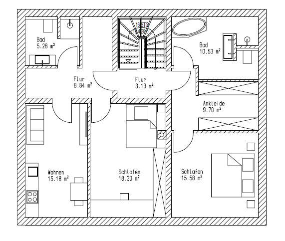

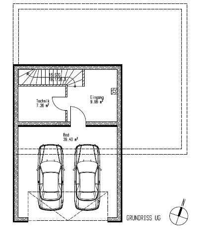

I have been searching for a suitable floor plan to meet my needs for a few weeks now.
Currently, I have two unfinished drafts and I’m not making much progress. Attached is a design for an attic floor, with the ground floor and terrace below and the upper floor on top. Exterior dimensions 11.50 x 10.00 m (38 x 33 ft)

The living areas seem very tight and small to me. Especially in the granny flat, where the view of the built-in wall unit is blocked when the door is open, or does the person sitting on the sofa get hit by the door against their legs? The tenant then has to walk through the landlord’s private area to get to their apartment, and the sleeping area is locked separately, or can the tenant access it as well? Hmm, the tenant must be a good friend... otherwise, I would reconsider this and, if necessary, provide access from outside.
Our house is also built on a slope and, due to the hillside location, has ground-level access to the outside on both floors. In this case, you could avoid having two staircases. With a hillside location, you have to be a bit creative. Our previous owners planned with a split-level design, with the living area and kitchen on different floors, etc.
Unfortunately, the design is missing the entrance door to the granny flat, which I plan to access via an external staircase at the back of the house.
I have three younger sisters to whom I will rent the flat until I need it for personal use. If there is a third-party tenant later on, the door to my area on the upper floor will be locked or removed if I never need it for myself.
