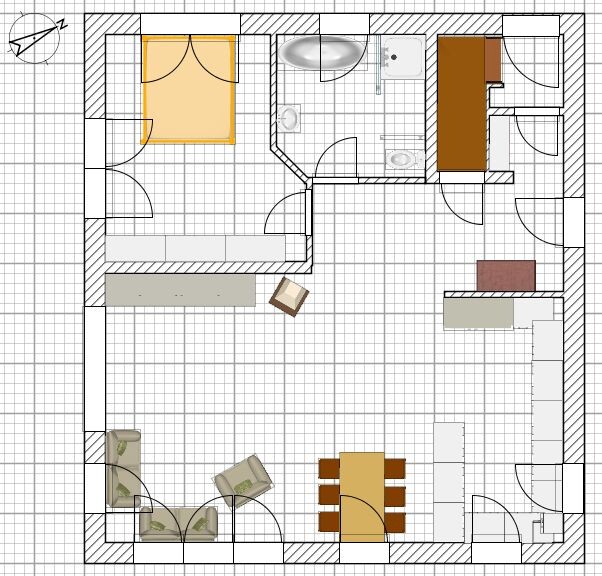

Shadowblues11 Aug 2013 16:25Hello,
my wife is upset with me because she likes the other floor plan much better, and the architect is too since I want to redesign everything again – but he’ll have to redraw it anyway. Maybe he’ll come up with something smart. Still, here’s a new version that I quite like, and it moves the bedroom away from the stairs. Unfortunately, there is no longer space for cleaning supplies and beverage crates, which were marked as the utility room in the other plan. The window facing the terrace is also gone; I had already imagined a small aviary for the bird there. On the plus side, I can stumble back to bed drunk from the terrace… The issue with the guest house tour has also been solved. The rest of the house and exterior views will need to be redesigned too, but that’s for the architect to handle… he’s getting paid well for it.
What do you think of this ground floor? Better than the other one? It’s 3 square meters (about 32 square feet) larger, but that should be manageable…
Roger
Roger
Shadowblues11 Aug 2013 16:26Shadowblues schrieb:
What do you think about the ground floor? Better than the other one? It's 3m² (32ft²) larger, but that should be manageable...
RogerI thought the wall next to the garage couldn’t have windows? But now it can?Similar topics
