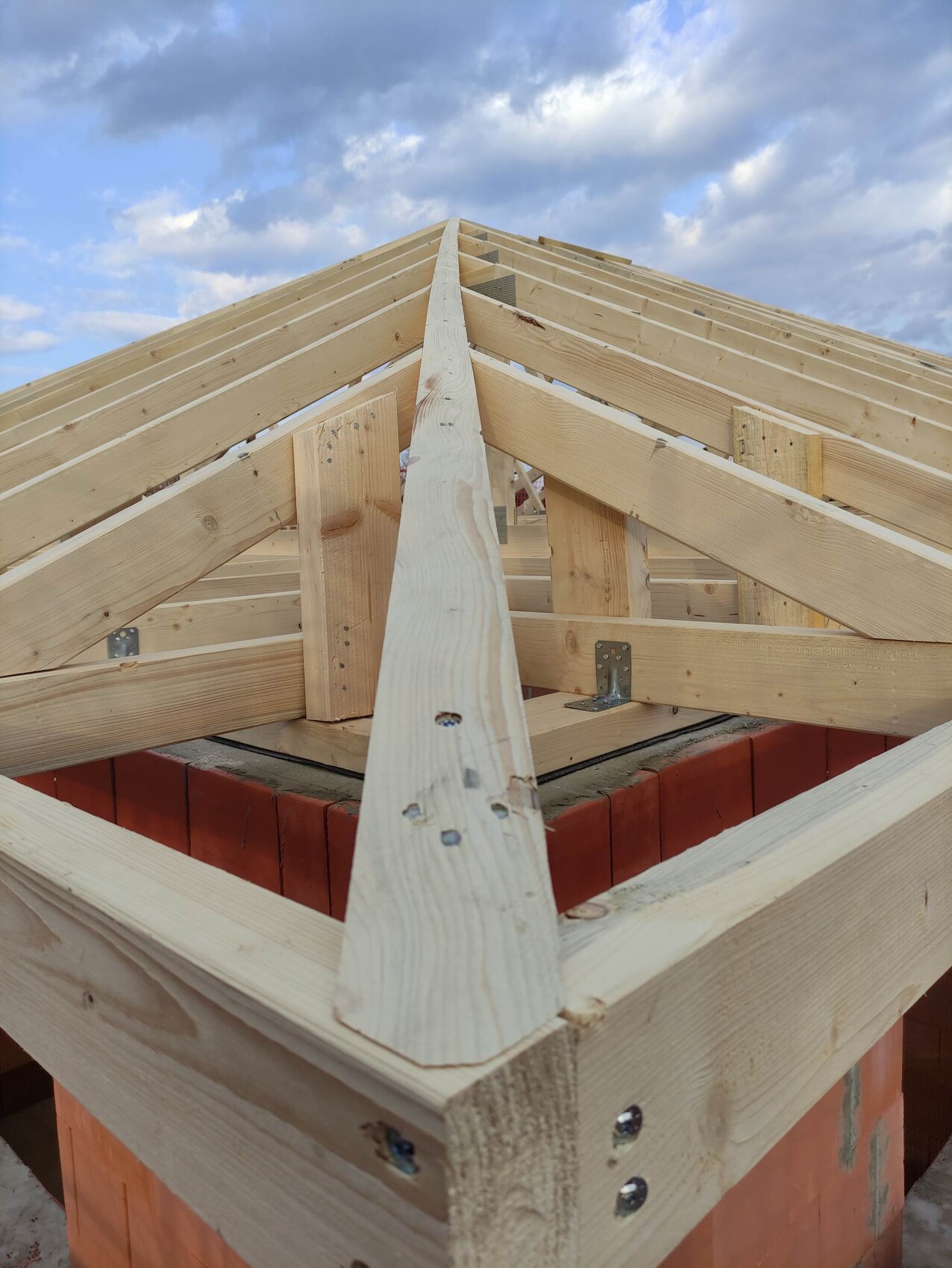

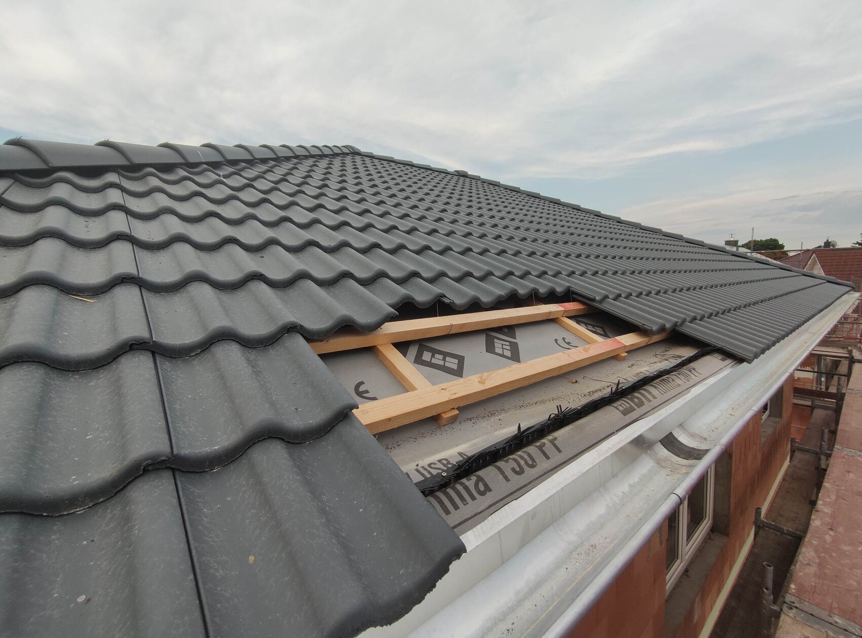

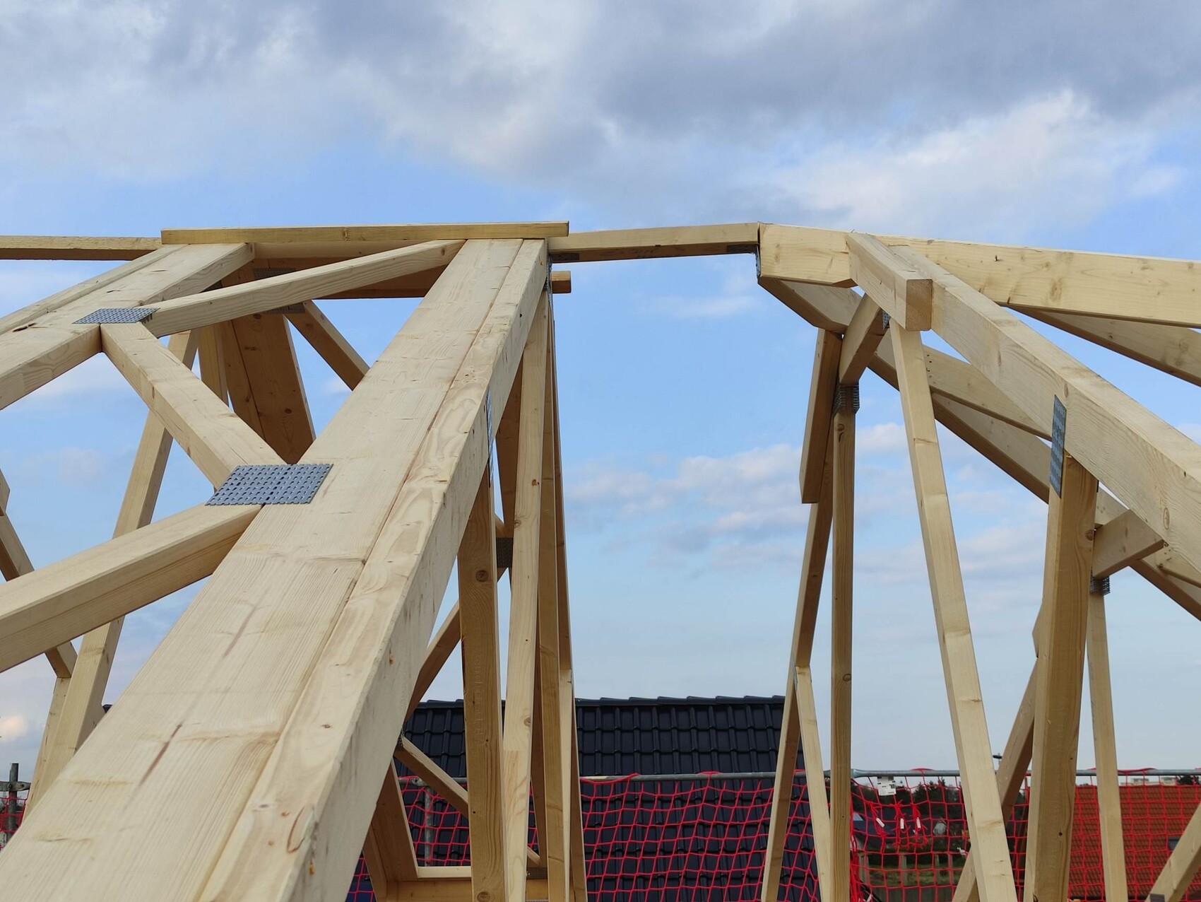

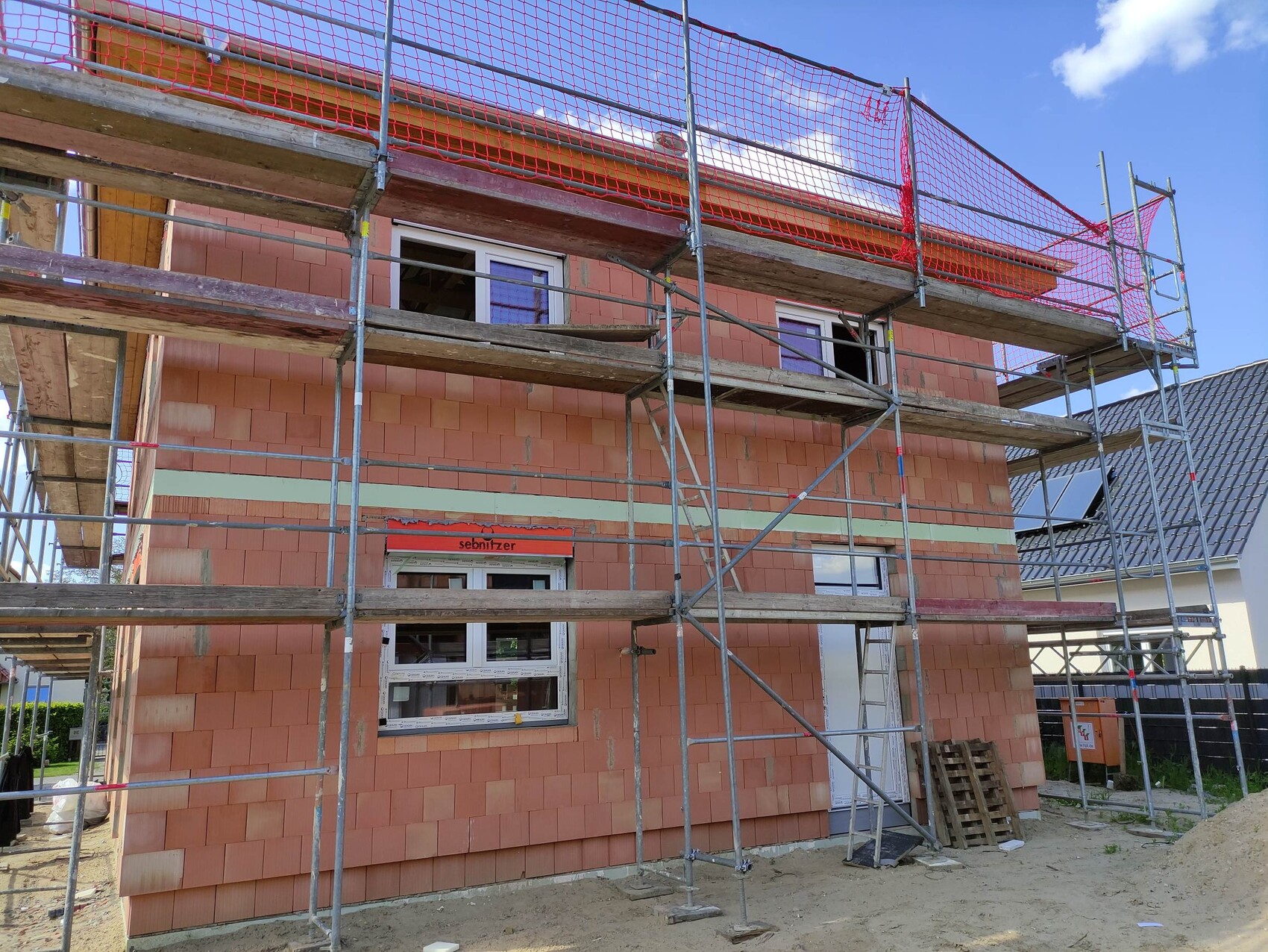

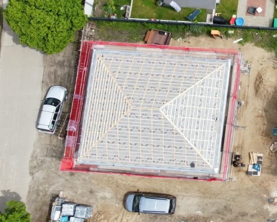

So, it’s time for another update.
First of all, the masonry work continued actively, and the roof frame was also built fairly quickly. Then, all the battens had to be removed and reinstalled because they were nailed with the wrong roof pitch. 🙄
But in the end, they managed to fix it.

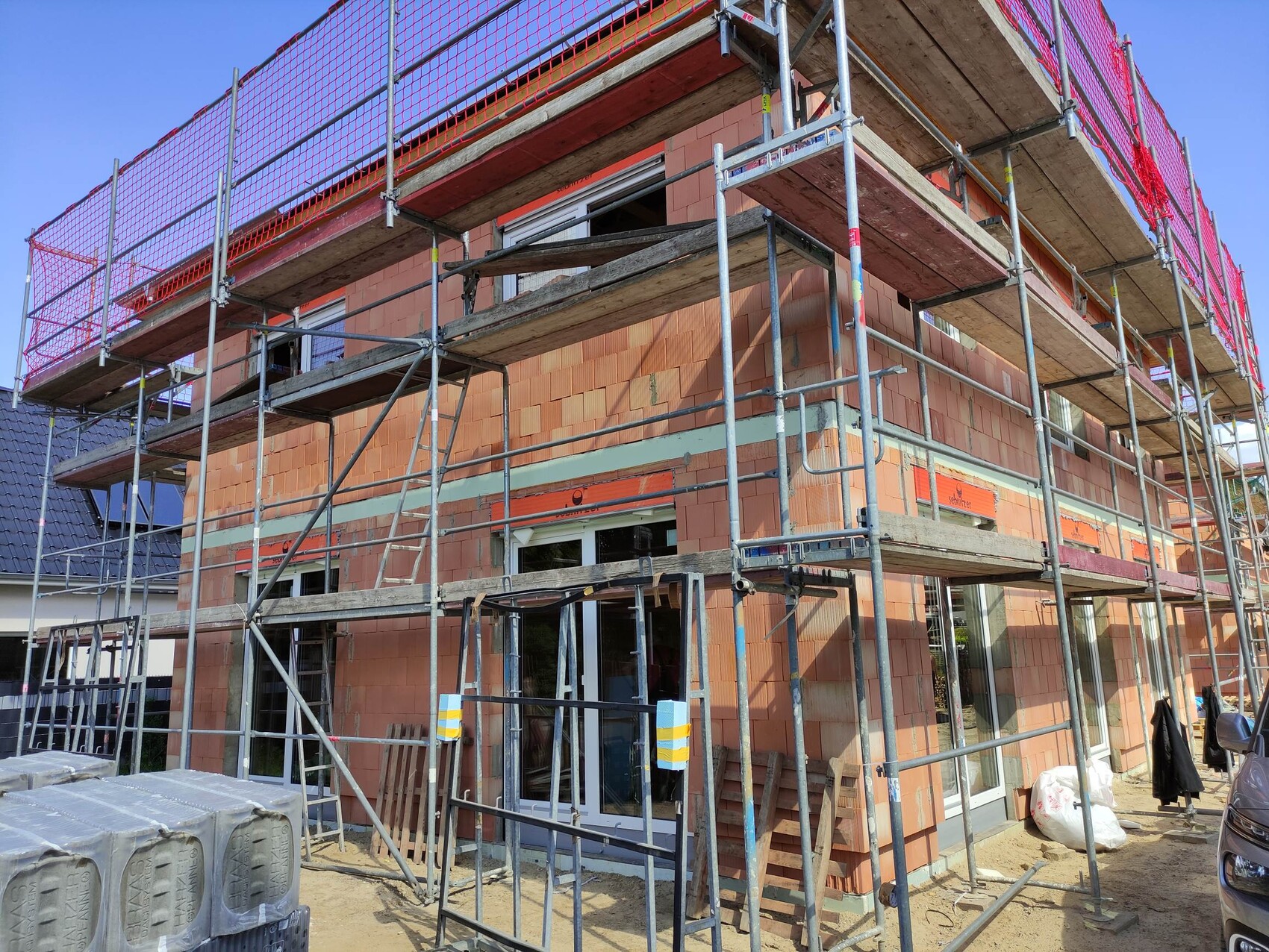

Despite warnings and the site manager’s warranty disclaimer, we started installing the windows. The site manager wanted to approve it only after the roof covering was completed, but I had talked to the roofer and he said they cut away from the house, so there would only be dust.
We didn’t quite finish it in one weekend (the fixed glazing is still missing in the pictures; we managed to complete those on the ground floor later, and I installed them in the upper floor just yesterday). The large hallway window, the exterior sealing and window sills, as well as the front door, are still missing.
The following week, the roof was almost finished with tiles – thankfully with not much dust – well, almost (who’s in charge of these orders?)...
Unfortunately, we couldn’t finish the windows the weekend after that because my father-in-law tested positive (for COVID). Luckily, he only had a fever for about a week and already wants to return to work this week.
Murphy’s law applies: the electrician is on vacation next week, which means a three-week standstill, and as soon as he’s back, my heating technician is on leave. So, everything would be delayed by almost two months in total!
That’s why I was at the construction site early this morning, sealing off the front door opening and the large hallway window with OSB boards. The guest toilet still needs to be closed up, and then the electrician can leave his tools safely inside. We have a lockable access via the side entrance door.

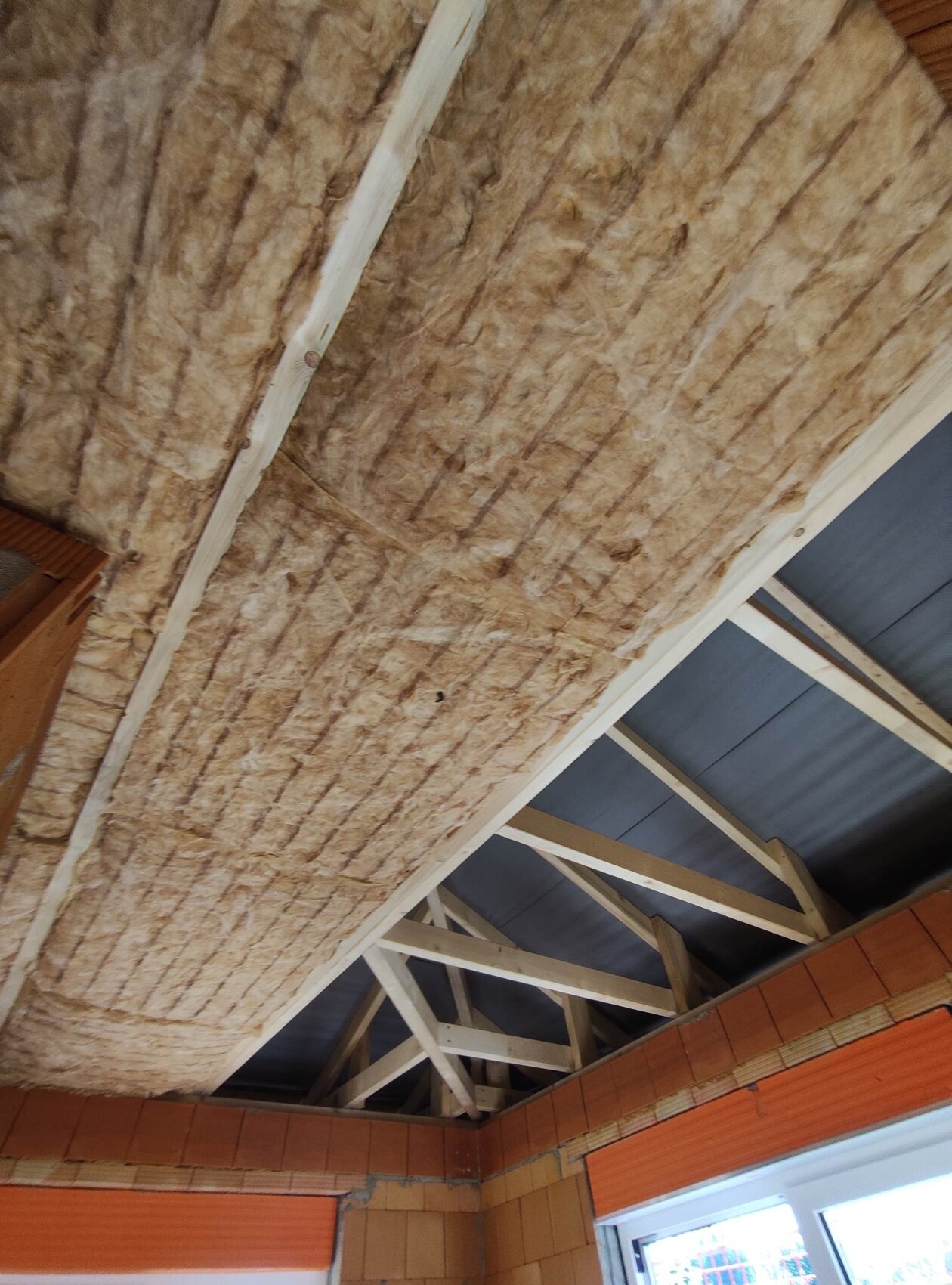

The electrician and drywall installer were already working inside today. The drywall installer started with the roof insulation.
The insulation batts lie well above the beams — how am I supposed to install OSB walking boards on top later?
The plasterer is scheduled to start the week after next...
By the way: the builder refused to install a construction staircase. I’ll only install one if he threatens to stop work otherwise.

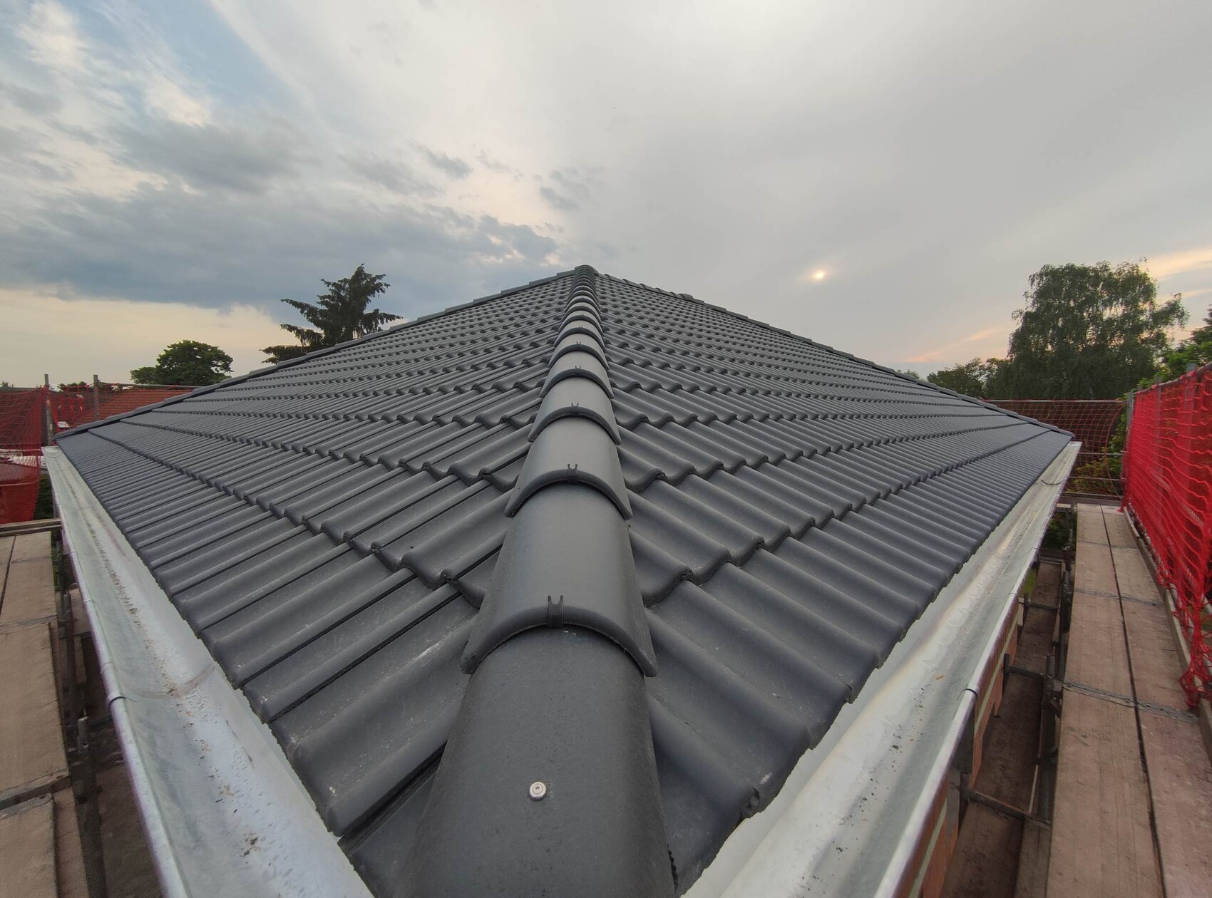

What a relief to finally see pictures without those silly snowmen :-)
Tolentino schrieb:
The following week, the roof was already covered—almost without much dust. Well, almost (Who is responsible for placing the orders?)...
Congratulations Tolentino, nice roof! 🙂
Speaking of orders, I just received a sealed package today with what appears to be the same roof tiles.
You can pick it up 🙂
Tolentino schrieb:
BRAAS Starline Matt Slate
But North Rhine-Westphalia is too far for me...🙂 Good thing you haven't set off already, for me it's actually "BRAAS Protegon Silk Matt Granite".
