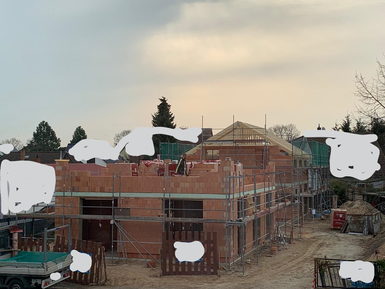

AllThumbs9 Apr 2021 14:48Tolentino schrieb:
Oops, I just noticed I forgot to pixelate one person, luckily they’re turning away right now...The face is clearly being reflected by your neighbor’s scaffolding pole :pI’m starting to think I’m dealing with some tricky characters. Some of you might know that I removed the staircase from the construction contract and arranged it myself.
As a result, when I inquired, I was told that I need to provide the temporary construction stairs, as they are supposedly usually supplied by the staircase installer. That seemed reasonable to me.
Now, my neighbor has received their temporary construction stairs (which are actually not up to standard), and they got them from the roofer—one of the few trades I kept involved... 🙄
I’ve followed up to express my concerns.
I’m curious to see how they try to explain this.
