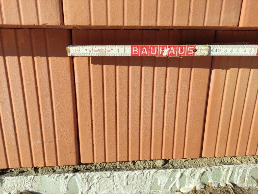

No, the term does not refer to the projection of the wall over the base, but to the offset of the vertical joints between consecutive rows of bricks, which should be forty percent, and may be less here.
Should it really be 40%? Then the photos clearly show a smaller offset.
Nida35a31 Jan 2021 10:23
Building savings contract? Discussion with the construction manager?
Have it done correctly from phase 3 onwards

31 Jan 2021 10:39
Nida35a schrieb:
Building savings contract? Conversation with the site manager?
Do it properly starting from row 3
Can you really judge that so easily?
At least I would want to know what kind of brick that is.
Tolentino31 Jan 2021 12:11
So, I have now browsed through the Wienerberger Poroton products (terribly confusing website).
This concerns the Wienerberger Poroton T10 Dryfix 36.5.
Specifically for this brick, there don’t seem to be any processing instructions, only a general installation manual.
In that manual, the lap length (Ü) is specified as ≥ 0.4 times the height of the brick. That means 40% of the brick height, or about 10cm (4 inches).
I will measure this again; I suspect it might be due to perspective. If it is frequently not observed, I will contact the building expert.
Tolentino31 Jan 2021 14:08
So, I was just at the construction site, and unfortunately, @11ant is right. There are several spots where the 10 cm (4 inches) overlap is not maintained. In one case, there is almost no overlap at all 🙁
In other places, the 4.5 cm (1.75 inches) overlap is respected, which made me look it up again because I thought I had read this number somewhere.
The processing guidelines specify that for small formats, <=4.5 cm (1.75 inches) applies.
Could the first row possibly be considered a small format? I noticed at the neighbor’s that the subsequent rows consistently maintain the 10 cm (4 inches) overlap. Could it be that it only concerns the first row because the bricks are narrower?

Of course, I will ask and inform the building inspector as well.
